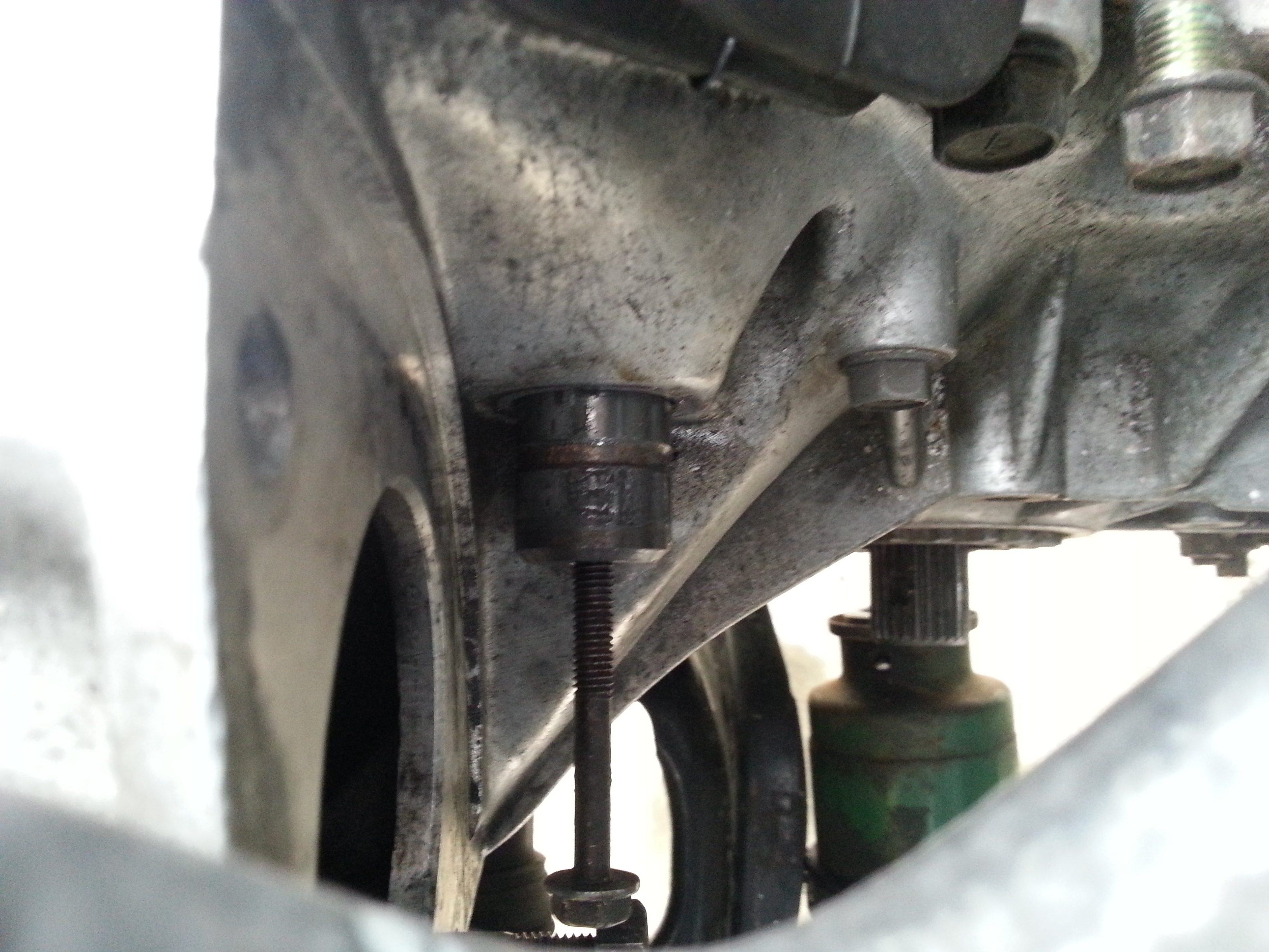

Hello folks have any of you taken the gearbox of your Forester yourself to change the clutch components,
I am in the process of doing mine but have hit a problem, every thing I can find is undone but the gearbox won't budge.
Have undone all the bolts I can see and at what appears to be the last is 2 nuts right at the bottom edge, but you cannot see the very bottom as it sits down in a cross member just above the steering rack I can see the **** plate which covers the ring gear that has 2 small bolts keeping it on the gearbox but they don't interfere which removal but because you cannot see that bit I don't know if there is a bolt down there.
So do any of you know, have watched a couple of videos on the inter web but they are all American and don't show much of the un bolting process so any ideas as I have been underneath I have pulled pushed lifted and pulled down and it won't break any seal it has created, it's the original clutch and done well for the mileage, am going to take a wide wood chissel to the grinder and see if I can persuade it to come apart.
So there's the question any ideas, are they an !Removed! to come apart when never been of since new, it's a 2003 by the way.

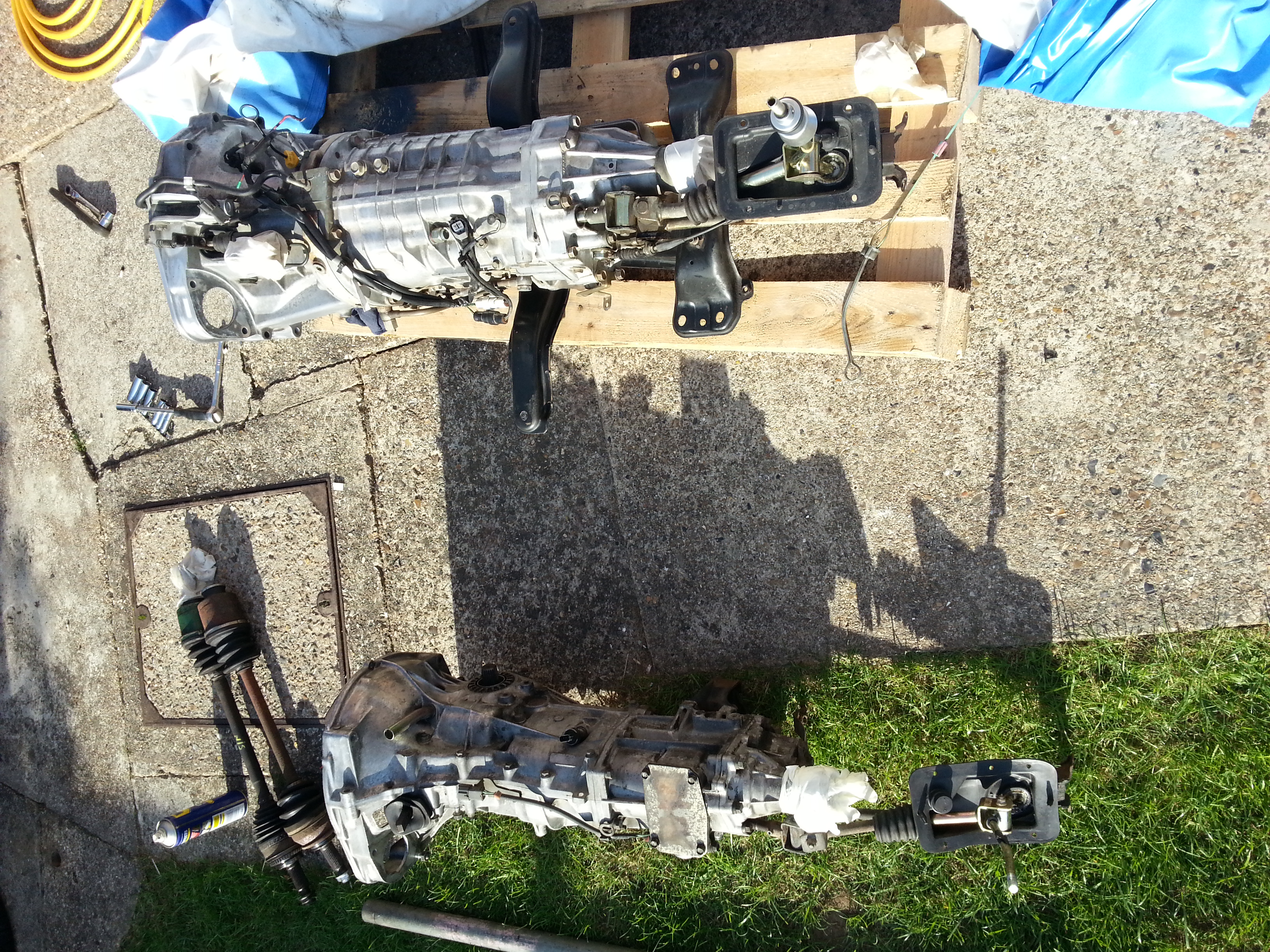

Box is off, left the heaters on underneath last night went to it smorning didn't even need gloves nice and warm loud crack and away it came on the mating faces there was some kind of sealer, not like silicone but like lacquer the stuff cleaned of with a Stanley blade but it went every where no clue as to what is was and why it was there but what a ******.
