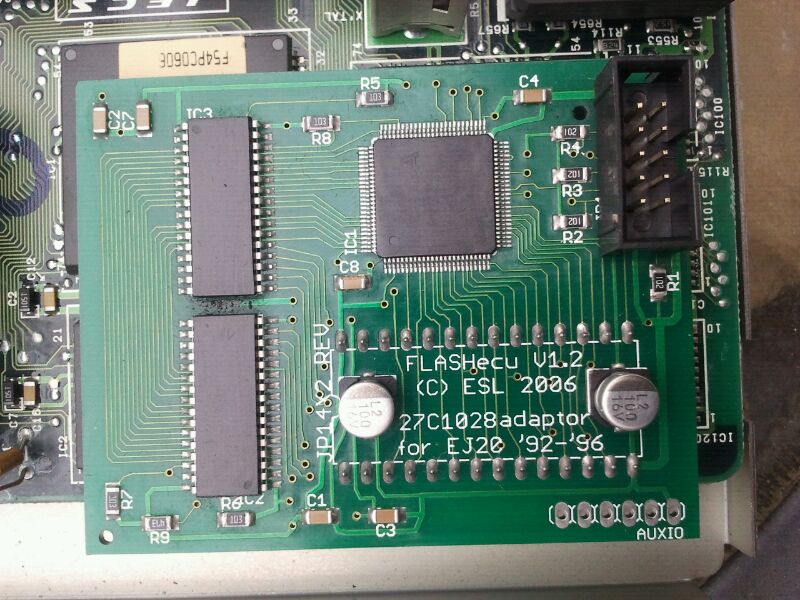

savage bulldogs Posted February 2, 2015 Report Share Posted February 2, 2015 Z4 ecu was for a early wrx which had 260 hp standard . Some people do fit a fuel cut defender when using manual boost controllers to allow it to run more boost without hitting fuel cut . A esl daughter board could be fitted and would be easy to spot with the ecu "case" removed Looks a bit like this depending on version 1 Quote Link to comment Share on other sites More sharing options...

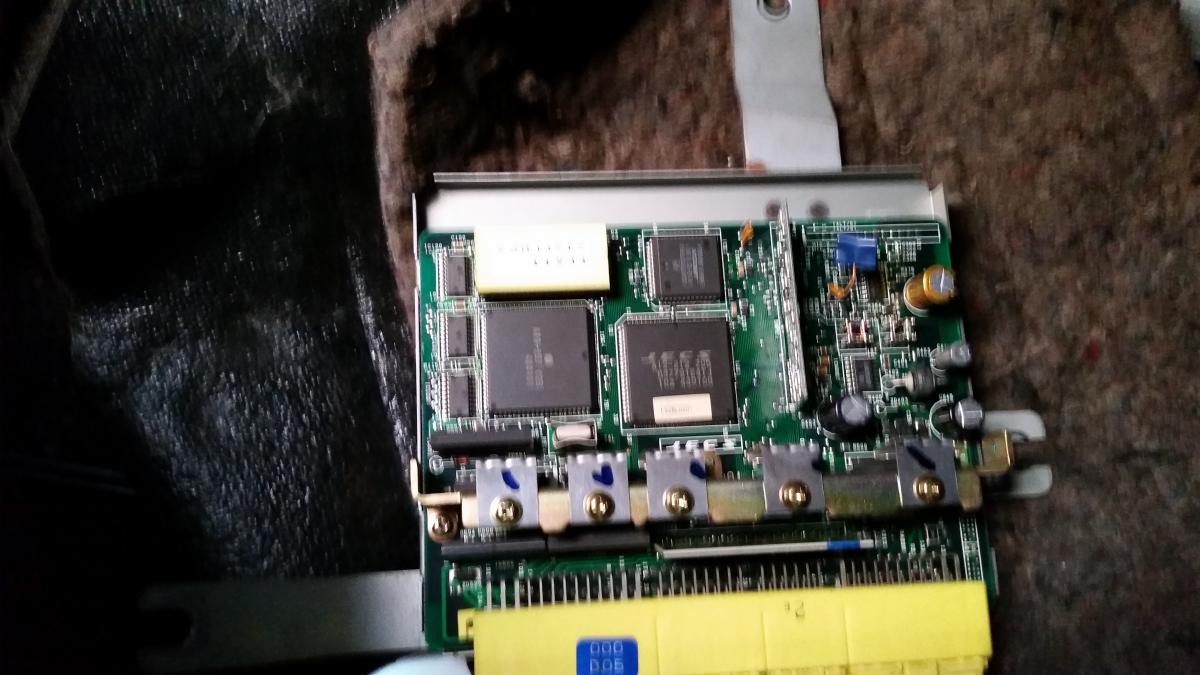

HULKSCOOBY Posted February 3, 2015 Author Report Share Posted February 3, 2015 Two quick photos i can get? Standard ecu? Quote Link to comment Share on other sites More sharing options...

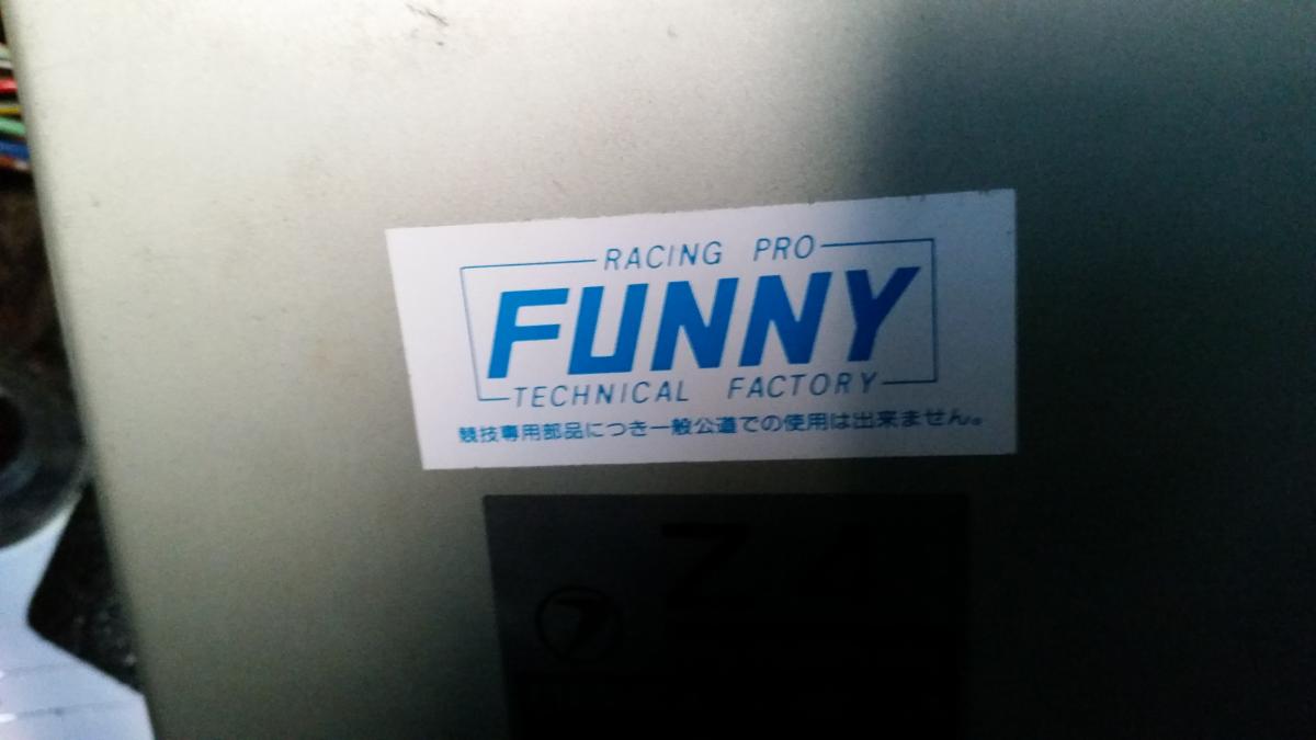

savage bulldogs Posted February 4, 2015 Report Share Posted February 4, 2015 I would've said it's standard as the esl board is quite large and distinctive but subaru standard ecus normally have a letter and a number (6s , sa, z4 ..... ect) on the casing . Have you googled the info on the sticker ? It might be chipped or be a aftermarket ecu , although I've not heard of the funny tech factory before . Simtek Apexi Gems Esl Syvecs Are about the only mappable options I'm aware work on the early classics . Quote Link to comment Share on other sites More sharing options...

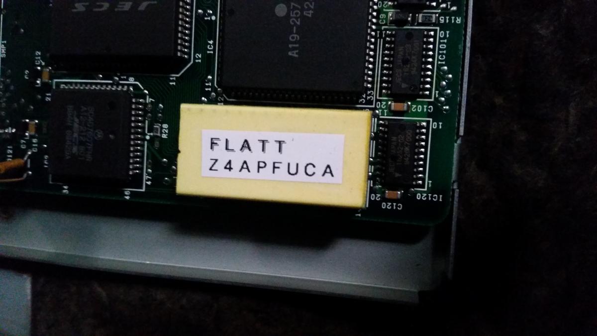

HULKSCOOBY Posted February 4, 2015 Author Report Share Posted February 4, 2015 The casing does have Z4 on the casing, there is a chip, however picture is not clear enough to read the writing on it. I am picking it up from my mechanics tomorrow so will take a closer look tomorrow. Should i run higher octane fuel, will it benifit the vehicl? Quote Link to comment Share on other sites More sharing options...

HULKSCOOBY Posted February 5, 2015 Author Report Share Posted February 5, 2015 Anyone seen this chip? Is it standard? Quote Link to comment Share on other sites More sharing options...
savage bulldogs Posted February 5, 2015 Report Share Posted February 5, 2015 I can't help there I'm afraid as I haven't seen the inside of a standard ecu , only esl'd ones and my current apexi . Quote Link to comment Share on other sites More sharing options...

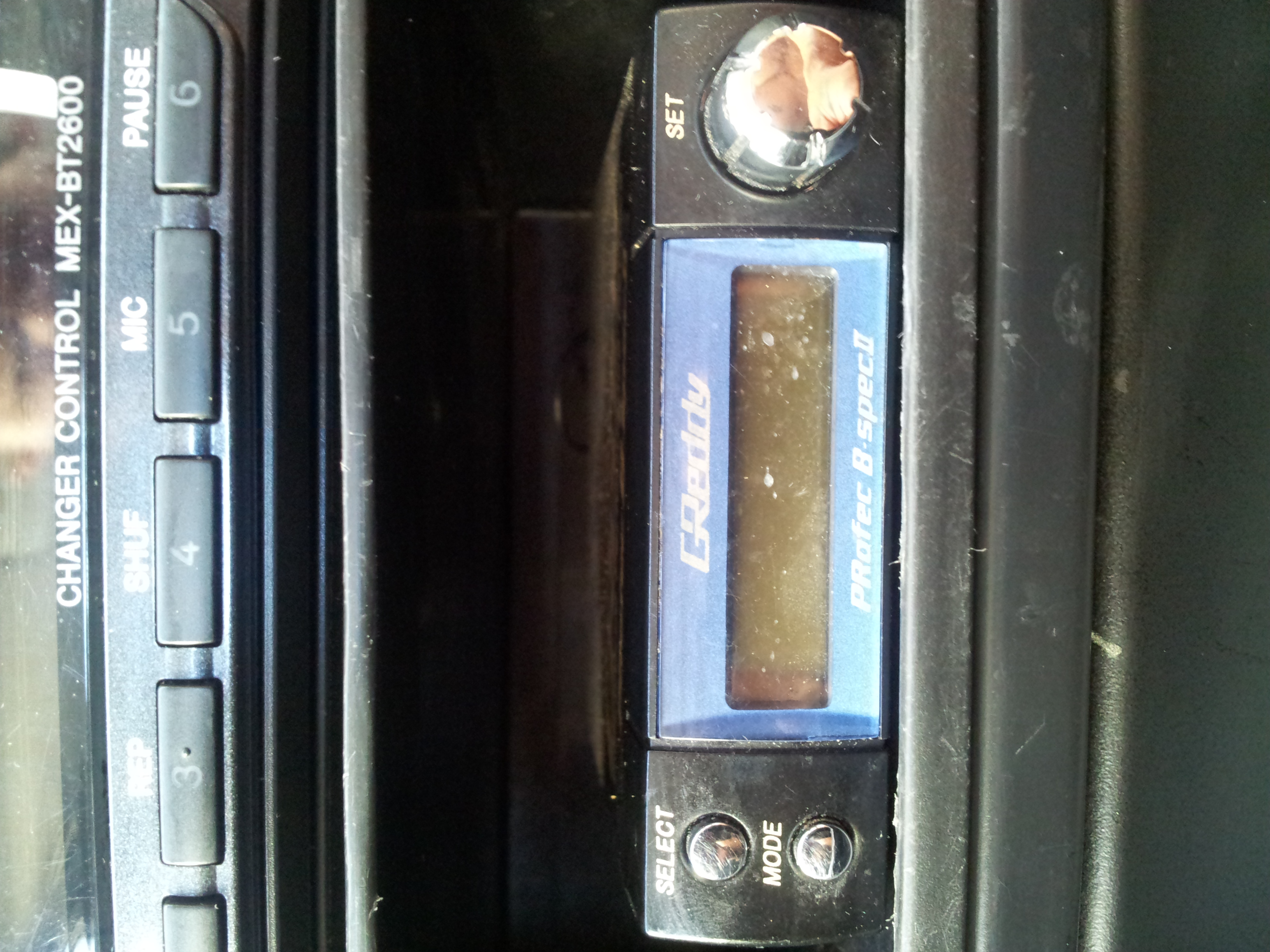

hurrell942 Posted February 22, 2015 Report Share Posted February 22, 2015 There is a small gadget under the Stereo that has a little blue screen which is reading - 55 And fluxtuates to about -65 ?? Is this the gauge you speak of iv been trying to google what it is .the bloke I bought it from wasnt real helpful but I liked the car . Quote Link to comment Share on other sites More sharing options...

Steveuk260.Esq Posted February 23, 2015 Report Share Posted February 23, 2015 Like I thought its a turbo boost controller. meaning it bypasses ecu control it is not original part of manufacturing it has been added later. As it stands it could be set up wrongly that could be your issue. Quote Link to comment Share on other sites More sharing options...

stants Posted February 23, 2015 Report Share Posted February 23, 2015 Sorted for you [emoji3] It will probably have a high/low setting I'd turn it right down until the garage looks at it just to be on the safe side 1 Quote Link to comment Share on other sites More sharing options...
