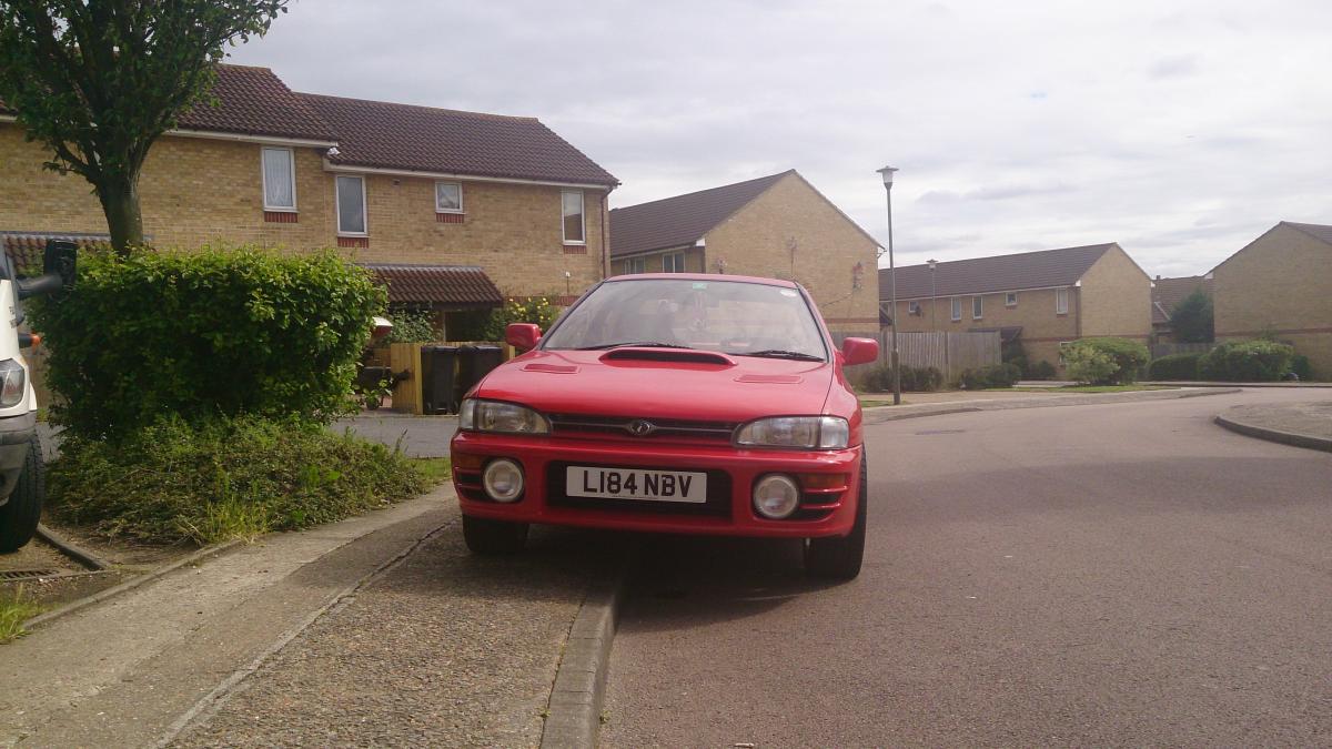

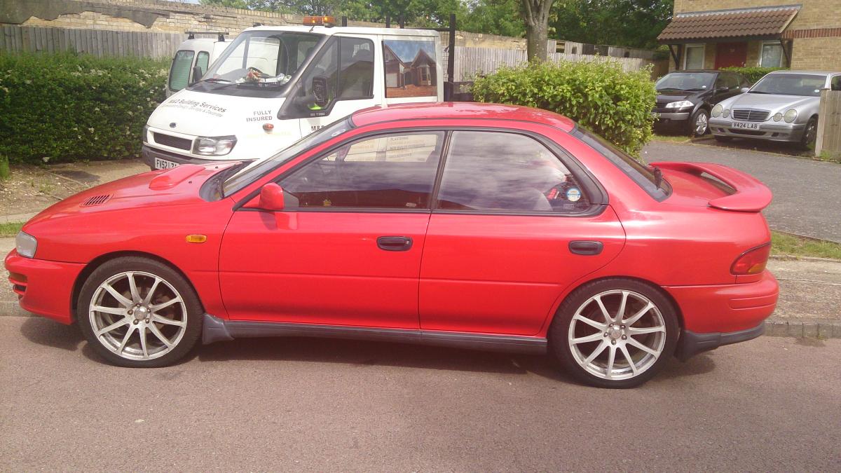

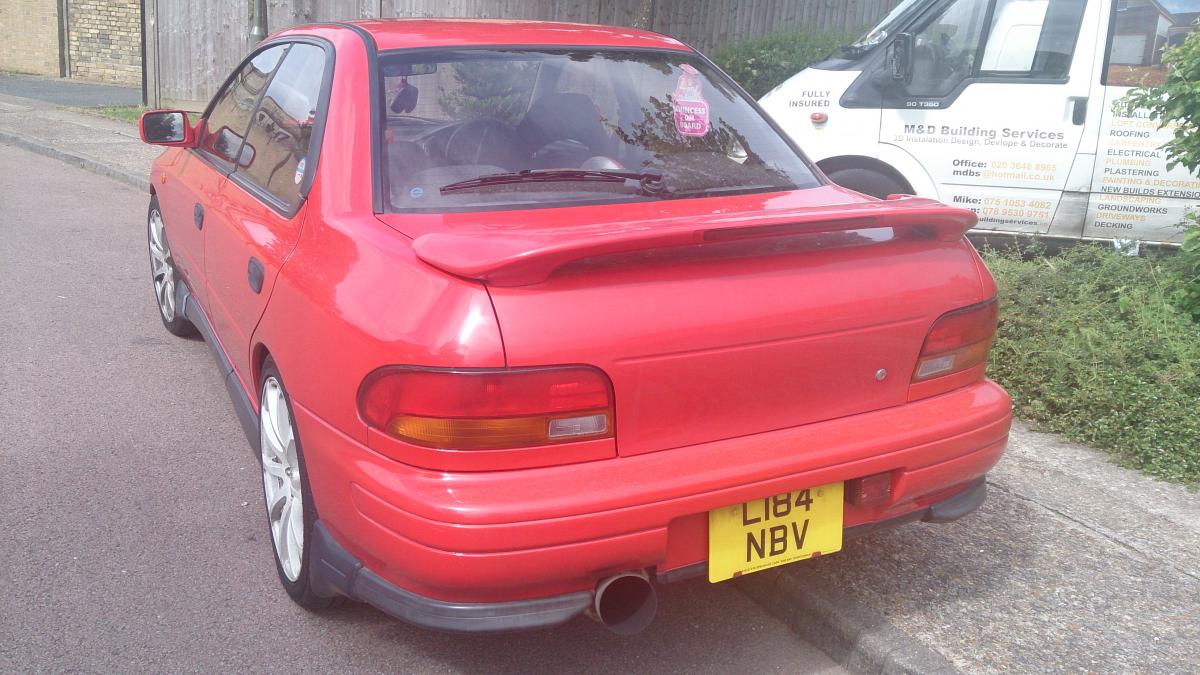

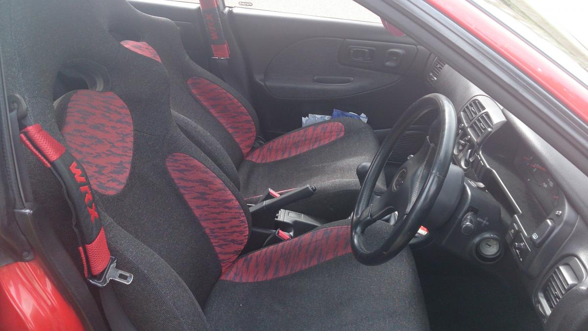

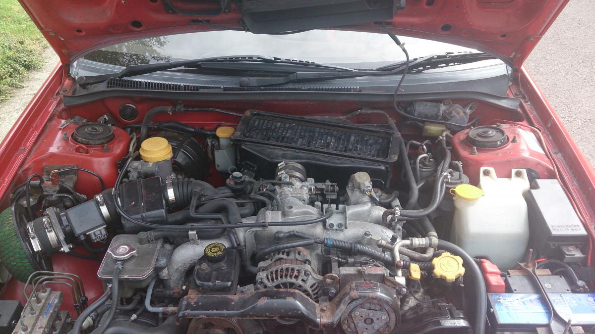

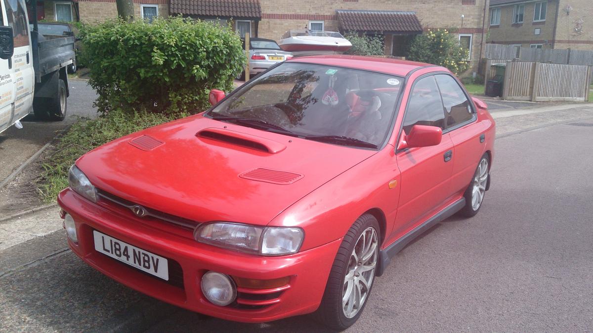

Going to get some pictures and I'll post them thru. You will understand what I mean about the rims. Once you see the pics. What would you guys recommend as some of the best performance upgrades?
Other than the straight through exhaust, and the rims car also has a HKS air filter.
Let me know what you guys think!!

Car looks tidy though. Myself it was mine would colour code some of the body parts and slap the STI spoiler on the back but part from that think it was a good buy :)
