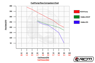

I'd recommend the rcm pump a few people have had problems with warlbro pumps recently and the quality has gone down a bit.
With a new pump and remap you should easily see 270 ish, a td05 or vf series turbo would be the next size up, you'll have more power obviously but it will be slightly laggier

I was going to go for the walbro but after the stories I heard I'd rather pay the extra money to protect my engine.
When I was researching I found that most of the complaints about the walbro were that under load and high demand from the engine(high in rev range) the walbro would drop a lot of its pressure delivery. There was just too many horror stories for my liking.
If you're going for a larger turbo then you're definitely going to want to make sure the fuel pressure stays strong after 4-5k rpm.
