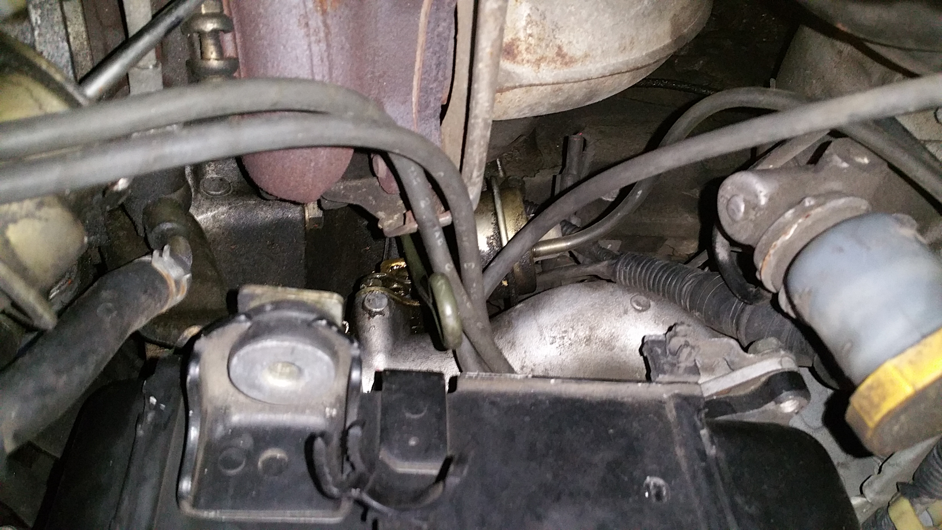

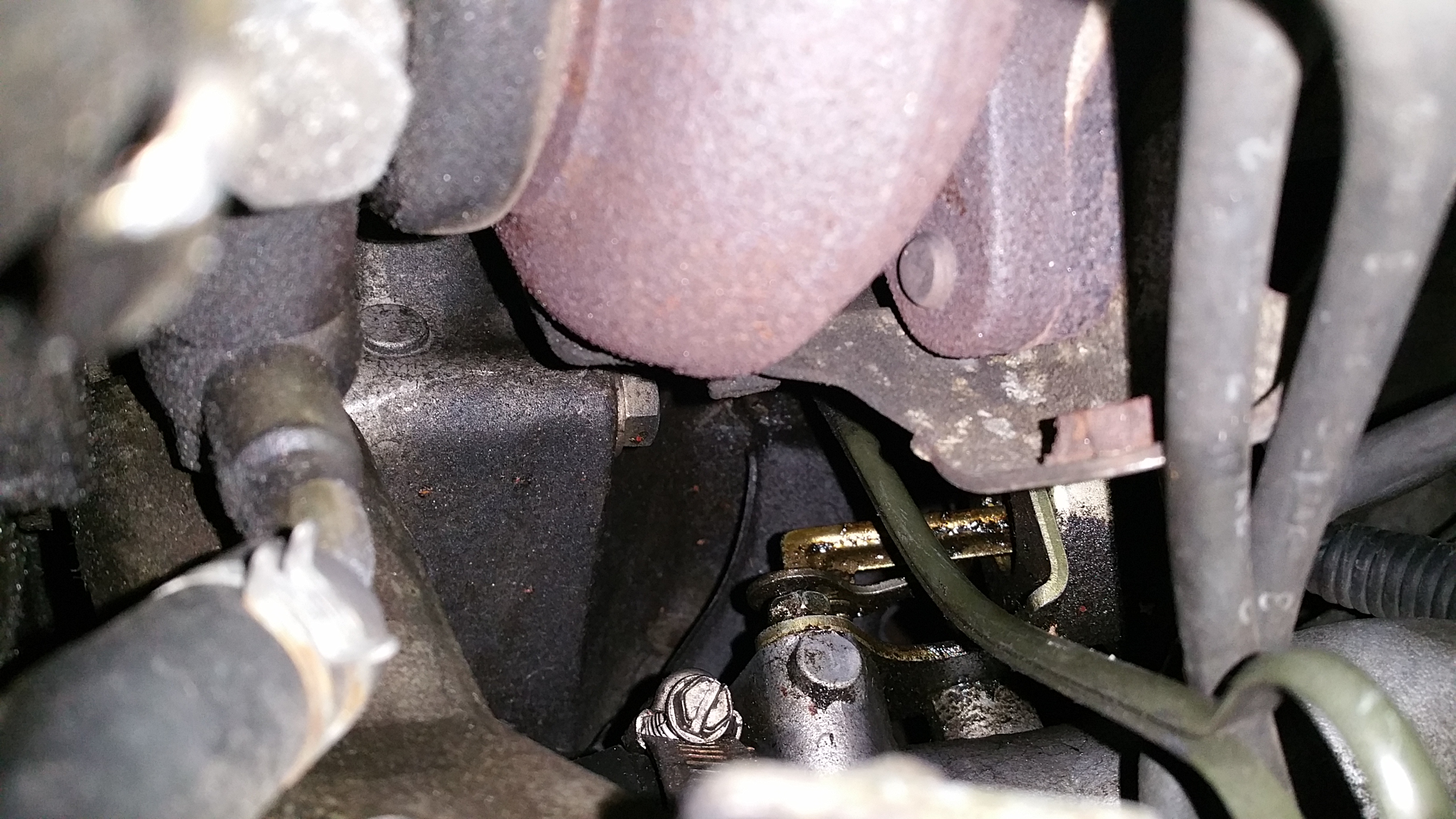

So ok guys I need your help. I opened the bonnet today as I have an oil leak and was poking around and I noticed what looks to me like the blow off valve leaking oil. Is this normal? If not how do I fix it?
Cheers.
I will post pics shortly.
I'm a bit unfamiliar with the legacy set up but the factory recirculation valve is normally located on the passenger's side of the tmic and aftermarket blow off valves are normally fitted just before the throttle body .
The area in the pic is very close to the turbo and there's only a few places that have oil running through them (on a single turbo set up) so maybe have a look at these to see if you can find the issue .
If the turbo seals have gone it normally pushes oil into the inlet tract and you'd get oil in the tmic /throttle body and blue smoke from the exhaust tail pipe .
The oil feed to the turbo is connected via a banjo bolt which might be leaking onto the outside of the turbo .
The oil drain pipe (from the underside of the turbo to the head) this pipe gets a bit brittle and somtimes weaps/splits .
The oil drain itself can get blocked and cause back pressure on any of the above causing a leak in that area
Hopefully it's a easy fix for you fella , keep us posted
Don't panic, that all looks very normal. Oil residue/vapour finds its way out over the years. If you took the IC off you will find a small amount of oil running around inside it. It's not ideal but it's not anything to panic about. It might simply be a pipe clip not as tight as it was when it left the factory or something similar.
The stuff you have seen has built up over time, it's not suddenly appeared.
