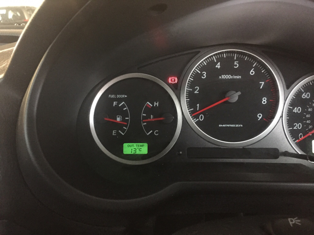

My question is: my temperature gauge on the dash, it seems to early always be in the same spot all the time, between a 3rd and half way, even after it's been sitting turned for an hour or 2 (apart from when it's left over night and you start it in the morning) and even then, it seems to get up to temperature really quickly, like 2 minutes. Is that just how subaru's are? All my other cars have taken much longer to warm up. Firstly, it's the first time I've owned a petrol turbo and i'm all paranoid about warming and cooling the turbo down as it is, secondly - my last car temperature gauge seemed to work even after my engine overheated and destroyed itself.

With regards to my first question. Does everyone's temperature gauge act like mine. As in does it warm up really quickly with slow driving and does it stay around the same temperature even after you start it up again after the car being switched off for an hour or so?

Yep the temp gauge is a bit poor to be fair,
As long as you let it come up to half way before giving it some you'll be ok,
Mine takes 5mins of stationary idle before it's about halfway, the only reason I don't drive before that is mad piston slap which is embarrassing.
Anyway it gets up to temp and doesn't move that much, but by the time it's gone to the red you'll have problems cooked the engine anyway. So you could either fit an aftermarket one if your that worried, or just keep an eye on all your fluids.
It's a big old engine with the blower strapped onto it next to no 3 cylinder so it takes a good couple of hours to cool completely
Have a look at the expansion bottle about an hour and a half later and it will still be at the hot full line
They do take some time to cool. I've been shocked sometimes after leaving the car a good hour + only to come out to a warm car. I still do a cold start to make sure the oil is warm and circulating again. I let mine get just above the bottom line and then trundle along in 1st to the end of my road by then I'm up at half. Still give it some time after to let gearbox warm up. My needle sits below the bottom line before moving up after a minute or so.
That's is as highly as the needle ever goes. The fan kicks in from time to time so I'm assuming the thermostat is working fine. I just timed it when I just left my house. It took 6 minutes of slow reasonable driving until it reached that point and never went any higher.

The temp gauge does go up fairly quickly. Well say 5 minutes of driving. And after that because it's warmed the engine up already doesn't seem to take as long as in the morning. Your oil will take alot longer to get to full optimal temperature though so just keep in mind even if the needles been sat nice and warm position for awhile.
Basically the gauge should not fluctuate much over the normal hot running point, jap cars tend be very efficient on temp control & don't spike so high before fans kick in etc so overall the coolant stays in a tighter controlled range. You could get a data reader display for the OBD output to read coolant & other values or adding some extra guages is not a bad idea.
Ok. Cheers guys. If I'm honest I didn't really fancy fitting the extra gauges but if that what's needed to stop me worrying then maybe that's what I'll have to do. So does where the needle is sitting look alright or should it be bang in the middle, if different scoobys sit at different levels then I won't worry but if mine is the only one that sits at that level the. I'll have to dive deeper into why.

Mine sits below halfway. But have seen it go to just below half when it was a hot day stuck in traffic but the fans brought it down again and we had started to move again. But only time ive noticed it go that far up. But I'd say each car is a tiny bit different. Because of grades of coolant and such.
Cheers Gambit. That puts my mind at ease, and good point about the coolant. For all I know there is no anti-freeze in there at all. I'll probably have a better idea how it really is next week after I've changed the cam-belt and serviced it.

On my old legacy I had a temperature guage that sat a bit low (lower than yours looks), when I replaced the thermostats the entire Middle had been cut out!
I then discovered the temperature sender was knackered because I could get the supposed engine temperature to drop by bringing the revs up...
Long story short, yours seems to be reacting normally.
