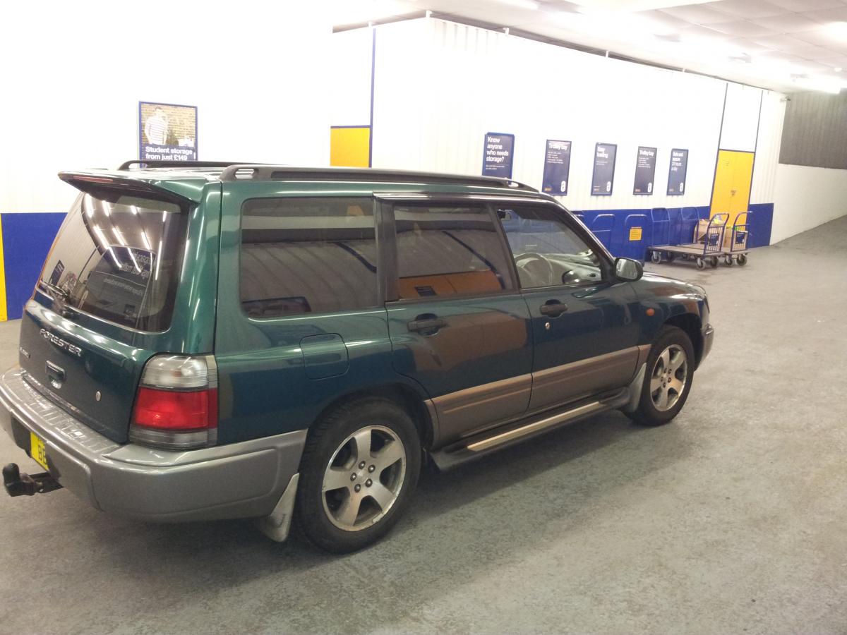

I've started the weight reduction programme (not that it will make a blind bit of difference) it looked poo and was doing my head in. The more i poked around the more i found i could remove. Initally i've just taken the sticky out bit with the ball on, but it looks like the rest of it's bolted onto the rear box section. And not welded is i assumed.
Does anyone know if the bar is bolted on using captive nuts like it looks like ? I don't wanna get half way through removing it and have to resort to cutting it off

oh and usually the towbars are just bolted to the car, if the bolts aren't visible through the boot floor under the carpets that usually means they are captive nuts on the top side of the bar, if you were closer i'd offer to help you remove it with my air gun, much easier and quicker than a ratchet

The chap who i bought it off said it's got a bar on but never been used for towing, shame about the caravan club sticker in the front and the spring spacer/supports for towing a caravan that are fitted.

Closer inspection it's in 4 parts, two backets a long cross member thing and the bally bit. To be fair the 1st nuts came off ok with a 2ft long half inch drive bar and a healthy spray of plus gas,

I don't tow anything so it was just a load more weight to be pulling around. plus i have a louton tranny if i need to move anything that wont fit in the car.
the whole unit weighs close to 80kg so it made sense to remove what i could, i've left the hangers on as the back box hanger s bolted onto it .
