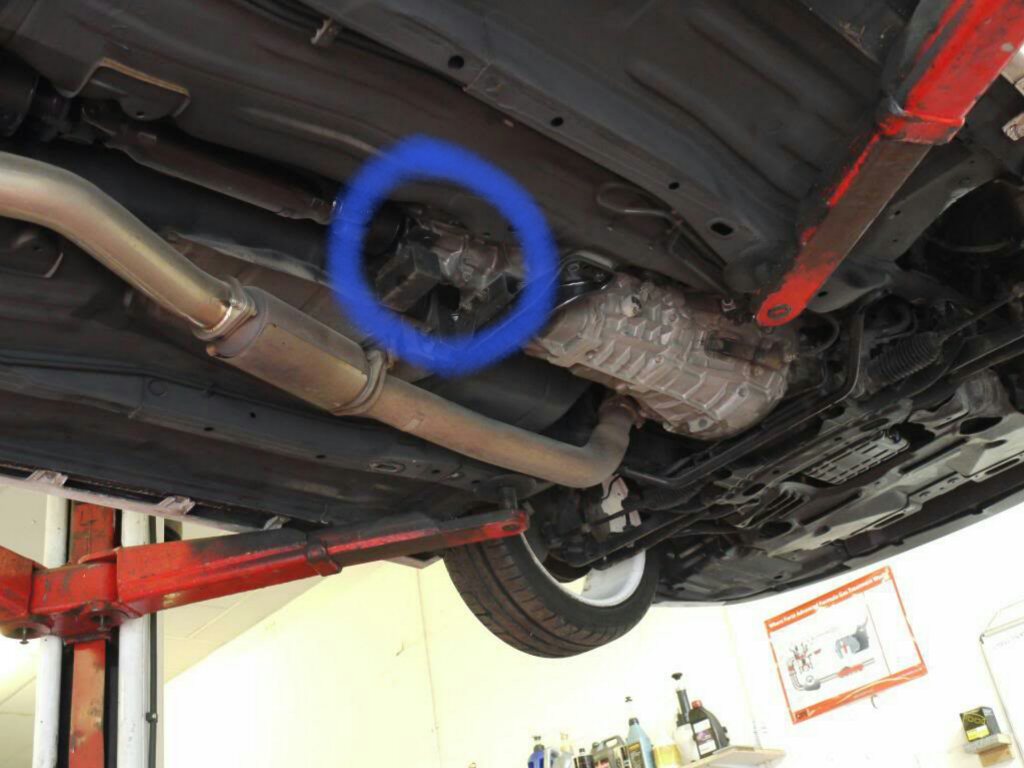

post-3548-144303855984_thumb.jpgProbably not the best pic but I borrowed it from Google and circled where the linkages are. You may not see it with a glance under the car. It's up in the tunnel with the prop shaft. You should be able to feel it and then get someone to wiggle it. If you have a Jack it'd make it easier. I nearly said ramps but that won't help in 3rd gear [emoji28]

Thanks so much lads- picture was bob on- managed to find a 10mm nut and bolt to stick in to get me home- works perfectly! Another win for SOC! Strange though- never heard of one of these pins popping out before- especially as my car's only just hit 50k!
