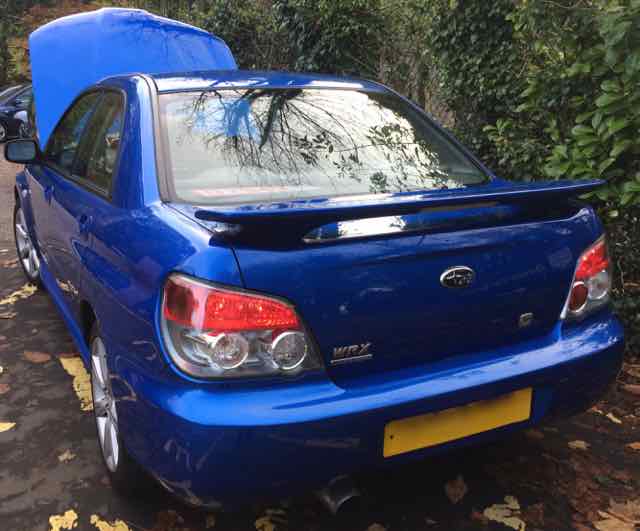

So I have just purchased my first ever scooby. It's a 2006 Hawkeye WRX. Totally stock with 77k on the clock.

Wotcha and welcome - sounds like you have a well cherished example - but of course we dont believe you without photographic evidence ;) :D

and does it get through the MOT with that without any issues? Also i have to be honest, i don't understand the different dump values as i know you can get a couple of types, obviously i want it to sound good without reducing the power or changing it too much. Your car looks great BTW
