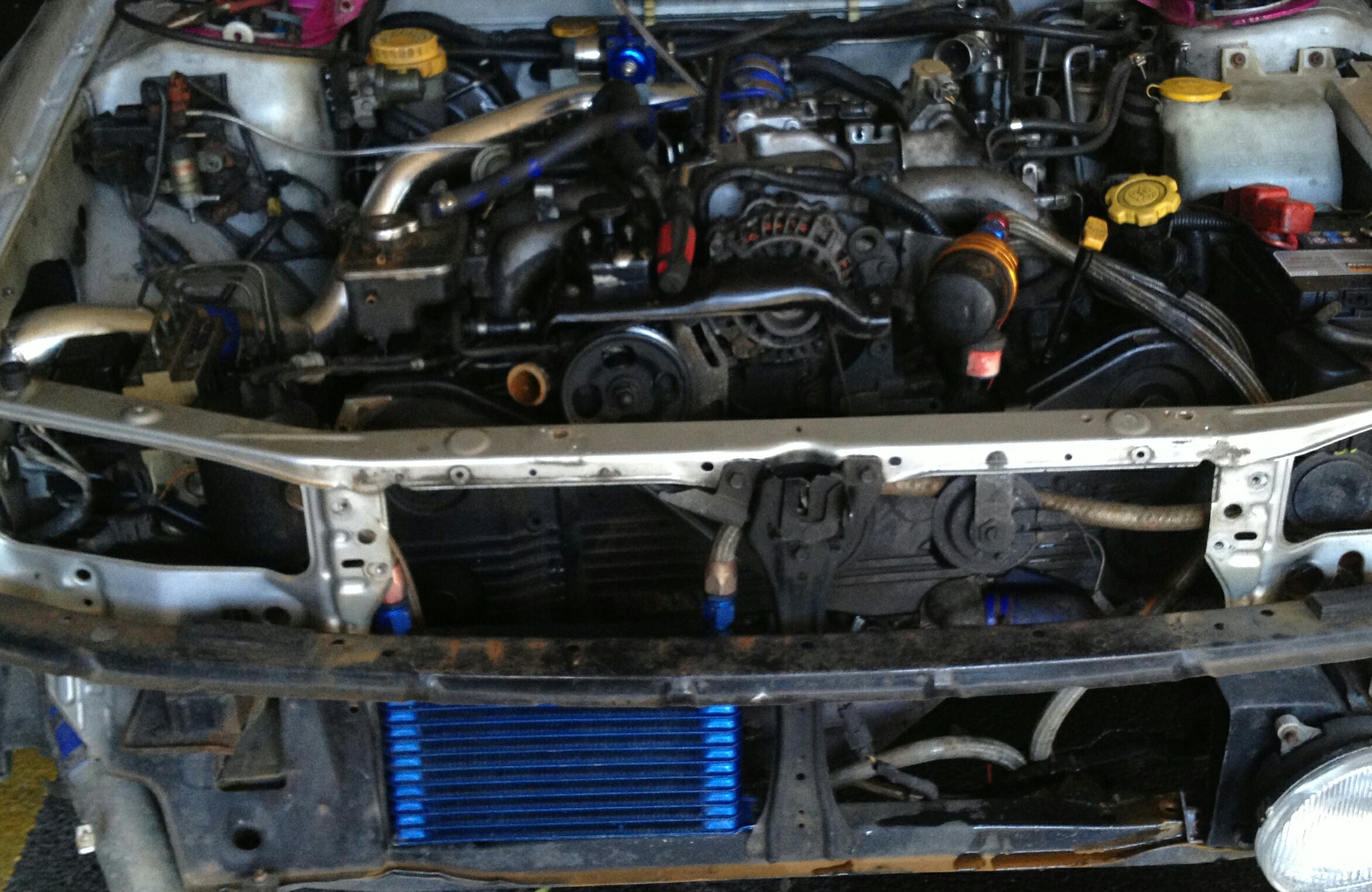

Could have an oil cooler fitted and braided lines putting the filter in a different position. Had one on the old impreza. post-3548-145065353803_thumb.jpg
Oil cooler is the blue radiator type unit. Oil filter is up where the air con would be.
