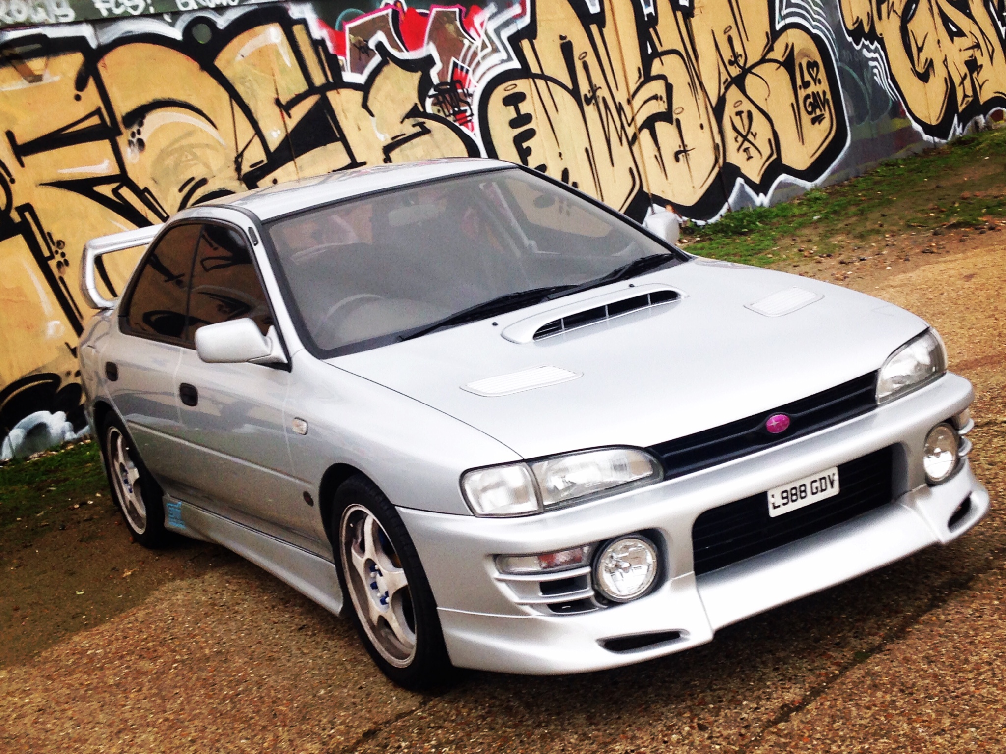

Hi all, new to the forum. Currently on my 4th scooby in 5 years :)
Have never been one to fiddle about with mods etc but alas i'm considering moving up the ladder lol
I currently have a 1995 JDM WRX. Its got the TD05 turbo,FMI and walboro fuel pump so i thought i'd look for an upgrade in ECU but after opening up the current Z4 ECU i realised the previous owner had the ESL 92-96 daughterboard installed.
I've been told that this is mappable but i was wondering to what extent? what are the features? and if it is a good enough outcome with the ESL chip, does anyone know where i can get it tuned from in or around yorkshire.
Thanks
