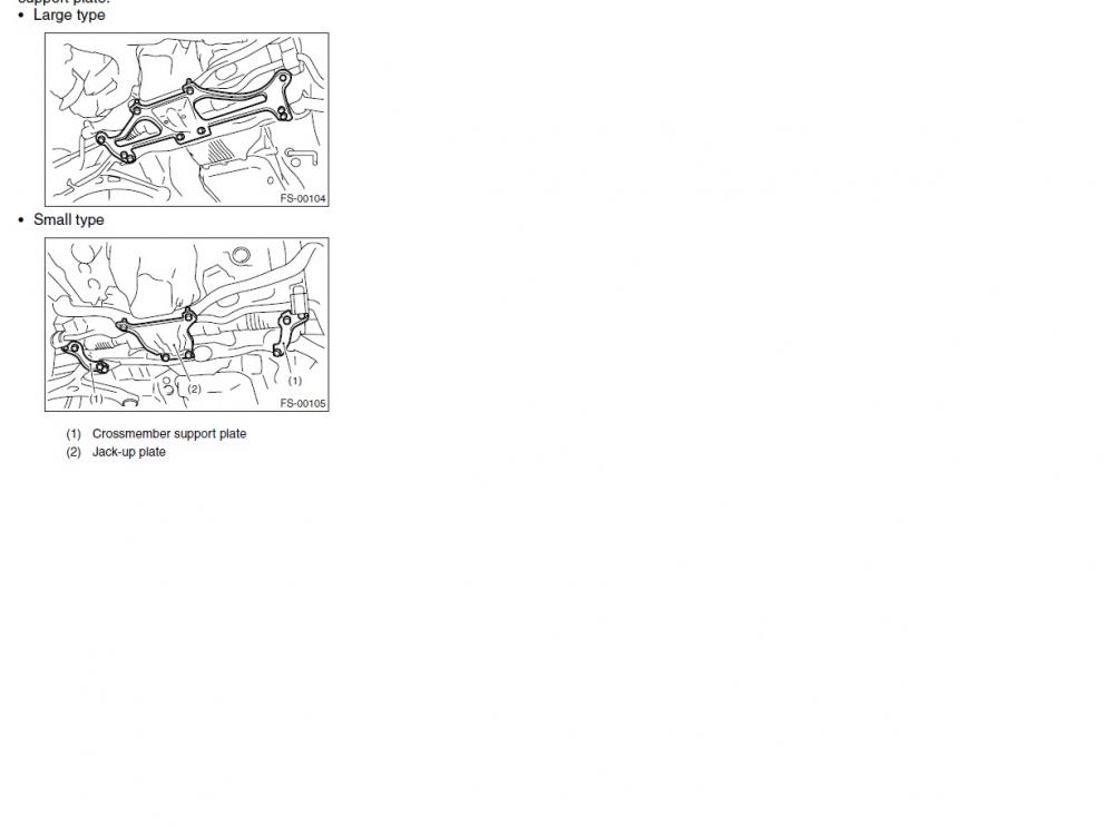

david1972 Posted April 26, 2016 Report Share Posted April 26, 2016 On 28/02/2016 at 3:25 PM, Greenmamba said: Rich_Brum - I just realised I sent you the owners manual. Probably little interest to you? I have the FSM on another pdf, only problem is it's 74MB so don't know if the site will allow this posting. PM me if you want me to try emailing it? I Hi - does this manual have clear pictures of where the jacking points are for a trolley jack please? My owners handbook doesn't seem to include this information. Thanks Quote Link to comment Share on other sites More sharing options...
Greenmamba Posted April 27, 2016 Report Share Posted April 27, 2016 I haven't checked the manual, it's over 6000 pages! I would use the diff at the rear, front there is a cross brace behind the sump and to which, apart from other things the under-engine cover attaches, which is what I'd use at the front. 1 Quote Link to comment Share on other sites More sharing options...
david1972 Posted April 27, 2016 Report Share Posted April 27, 2016 Thanks...do you have pictures of what they look like. I sort of think I know but don't want to make an expensive mistake and see my car crumple lol Sent from my iphone using Tapatalk Quote Link to comment Share on other sites More sharing options...
Greenmamba Posted April 27, 2016 Report Share Posted April 27, 2016 What is it you are intending to do? Working on or under a car supported by jack/s only is not recommended and you need to be confident of the securing points especially with trolley or bottle jacks (single point of failure). Picture of front cross member (2 types shown). My car has the large frame, yours may be different. Regarding the rear diff - confirm you need a picture of what a diff looks like? Quote Link to comment Share on other sites More sharing options...
david1972 Posted April 27, 2016 Report Share Posted April 27, 2016 It's just to change the wheels over - thanks. I don't need a picture of the rear diff Quote Link to comment Share on other sites More sharing options...
