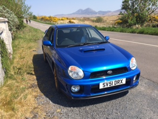

I've just bought my first Impreza!!
Its a 2001 WRX UK300. Being a limited edition car I need some wise advice.
I am going to be doing some necessary work on the car, it needs new brakes, some cosmetic tweaks and the underneath wax oiled.
Would it be better to upgrade the brakes to the bigger STI's brembos and thus needing different alloys to fit them, or would it be better to keep the car as original as possible?
Also the headlights are not the original rally style headlights. I have tried to find the originals but they are extremley hard to come by. I was thinking of fitting the bugeye STI headlights but dont know if that would be worth spending the money on different headlights to the originals.
What would be the best course of action to take?
Thanks
Welcome!
Car looks tasty!
The calipers and discs are a nice upgrade and can be found for £500-600 ish, example below.  Your discs are 294mm and you'll go to 326mm :smile:.   Id keep the wheels and get some spacers, I think 5mm should be ok but hopefully someone can confirm for sure.  That way keep it looking original!  Maybe look at some alternatives longer term.  My Rota's clear fine.
