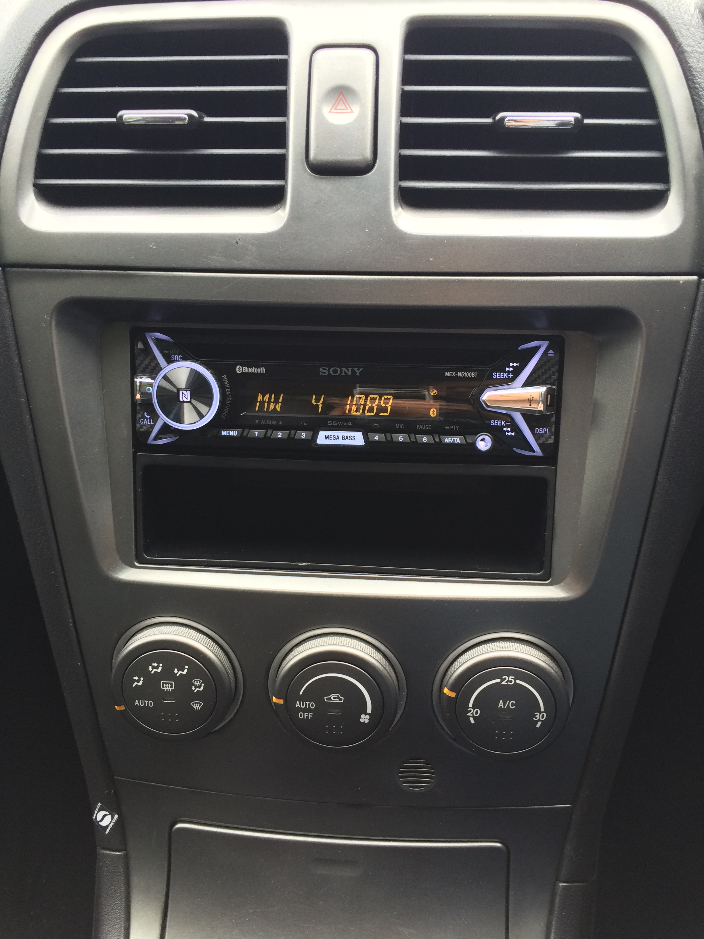

@Piggysniffer - I fitted a Sony MEX-N5100BT head unit to replace the stock single DIN one. It was an easy swap, just followed a handy youtube video - just a few screws to remove and use the existing bracket.  Had to buy wiring loom adaptop from eBay at £3.50 and also ISO to DIN adaptor for the radio aerial cable at £1.60.
https://youtu.be/Uj9lzb3dcCM
thats the video I used - OK its a double DIN but same principal.  I didn't bother completely unscrewing the gearstick btw as it wasnt necessary.
eBay bits needed:
http://www.ebay.co.uk/itm/250413926808?_trksid=p2060353.m2749.l2649&ssPageName=STRK%3AMEBIDX%3AIT
http://www.ebay.co.uk/itm/252218630012?_trksid=p2060353.m2749.l2649&ssPageName=STRK%3AMEBIDX%3AIT
and the final result...
