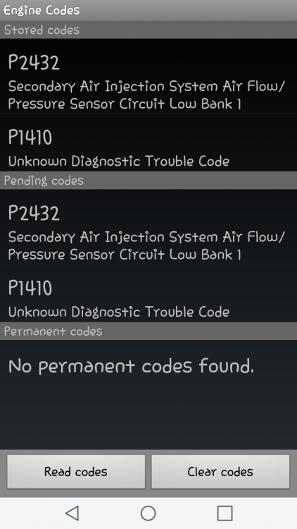

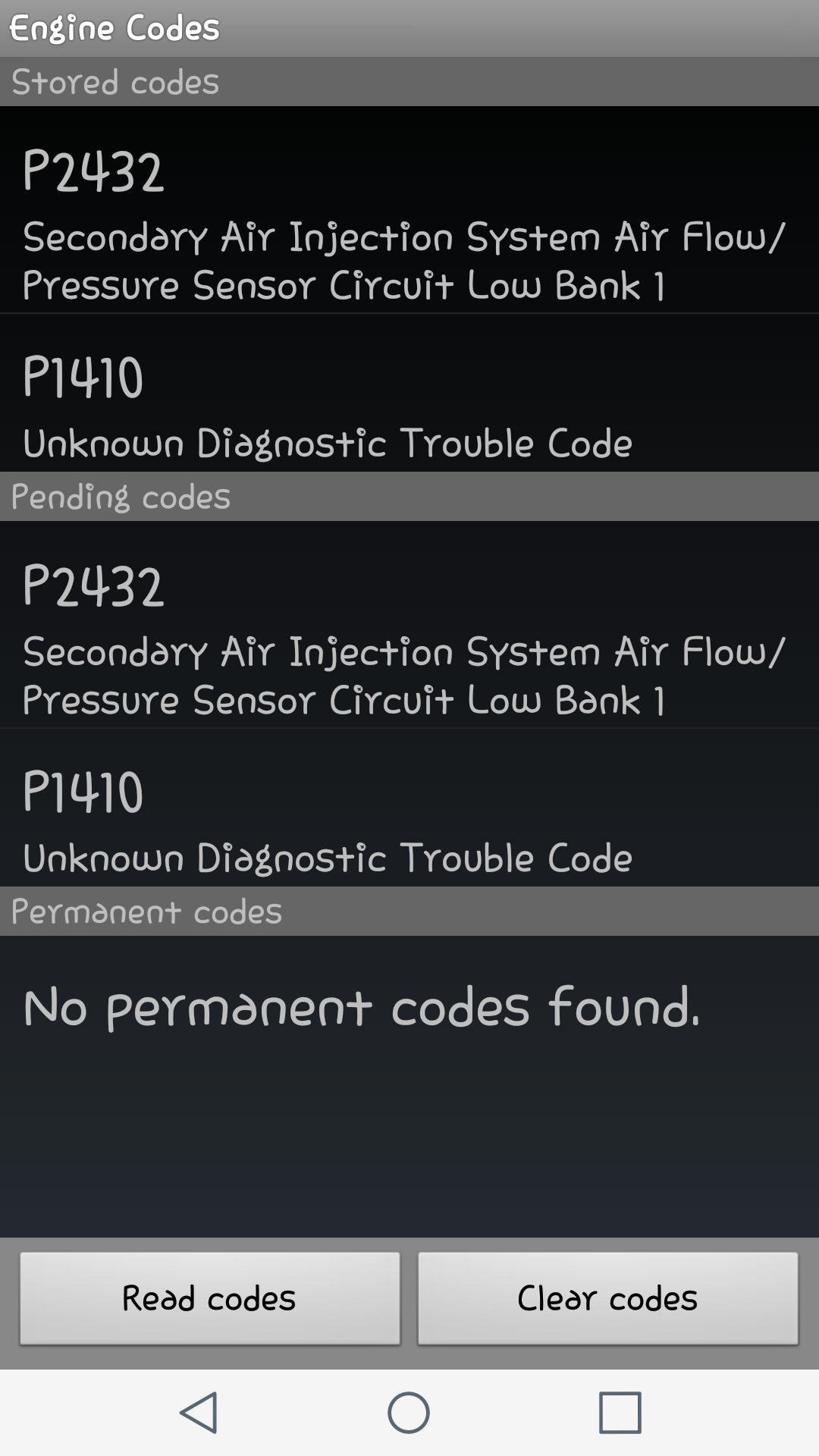

Annoyingly cel light came on yesterday with codes P1410 and P2432.

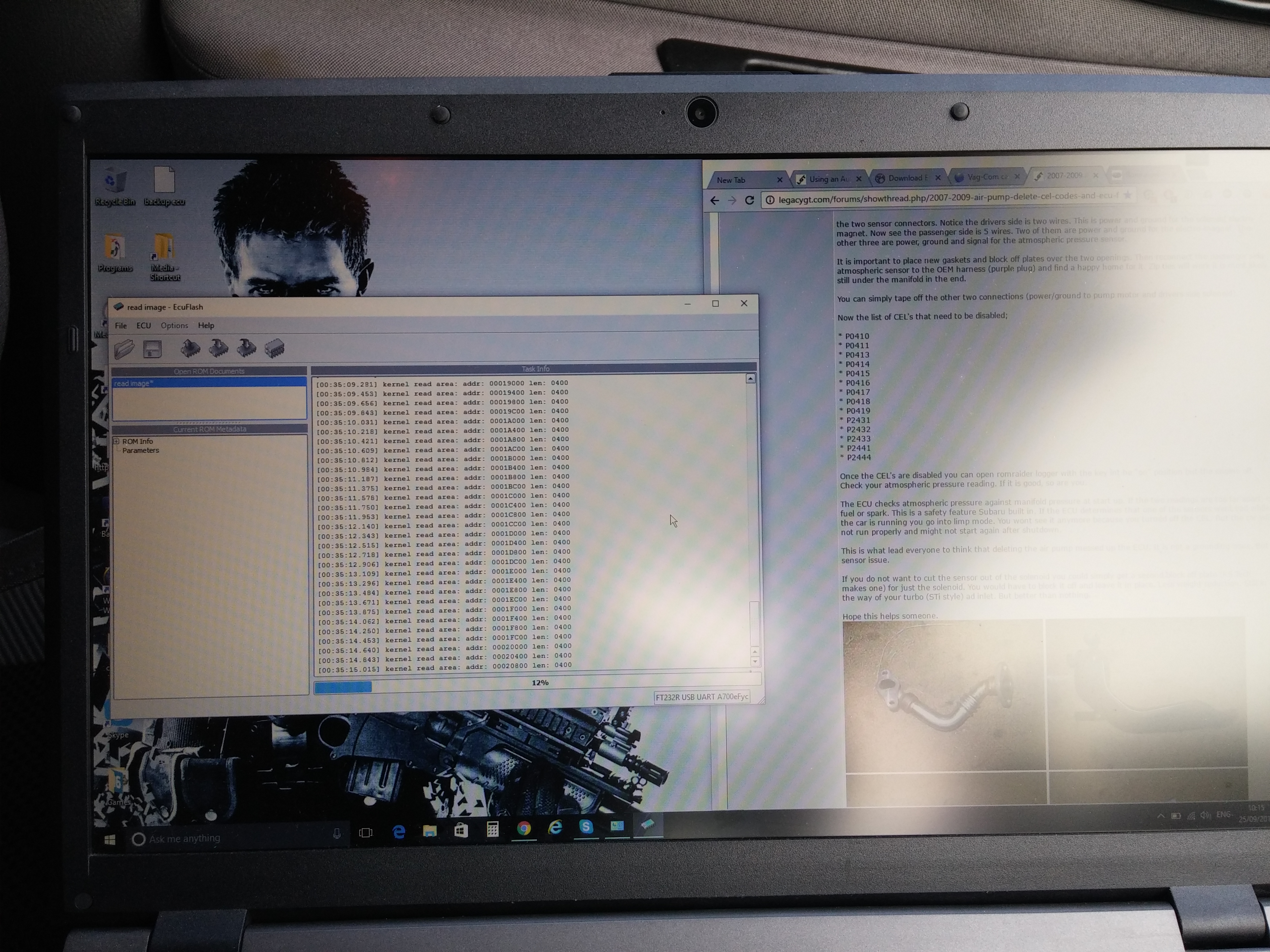

Once installed go to device manager,find the cable under com ports and change the BAUD rate from 9600 to 4800
I then installed ecuflash 129a.
i tried the latest version but would not work, apparently after 129 it checks the brand of cable.
Connect the green test mode connectors under the dash
Plug in the cable, turn the ignition to ON, EML will be flashing and fan start and stop
open ecuflash

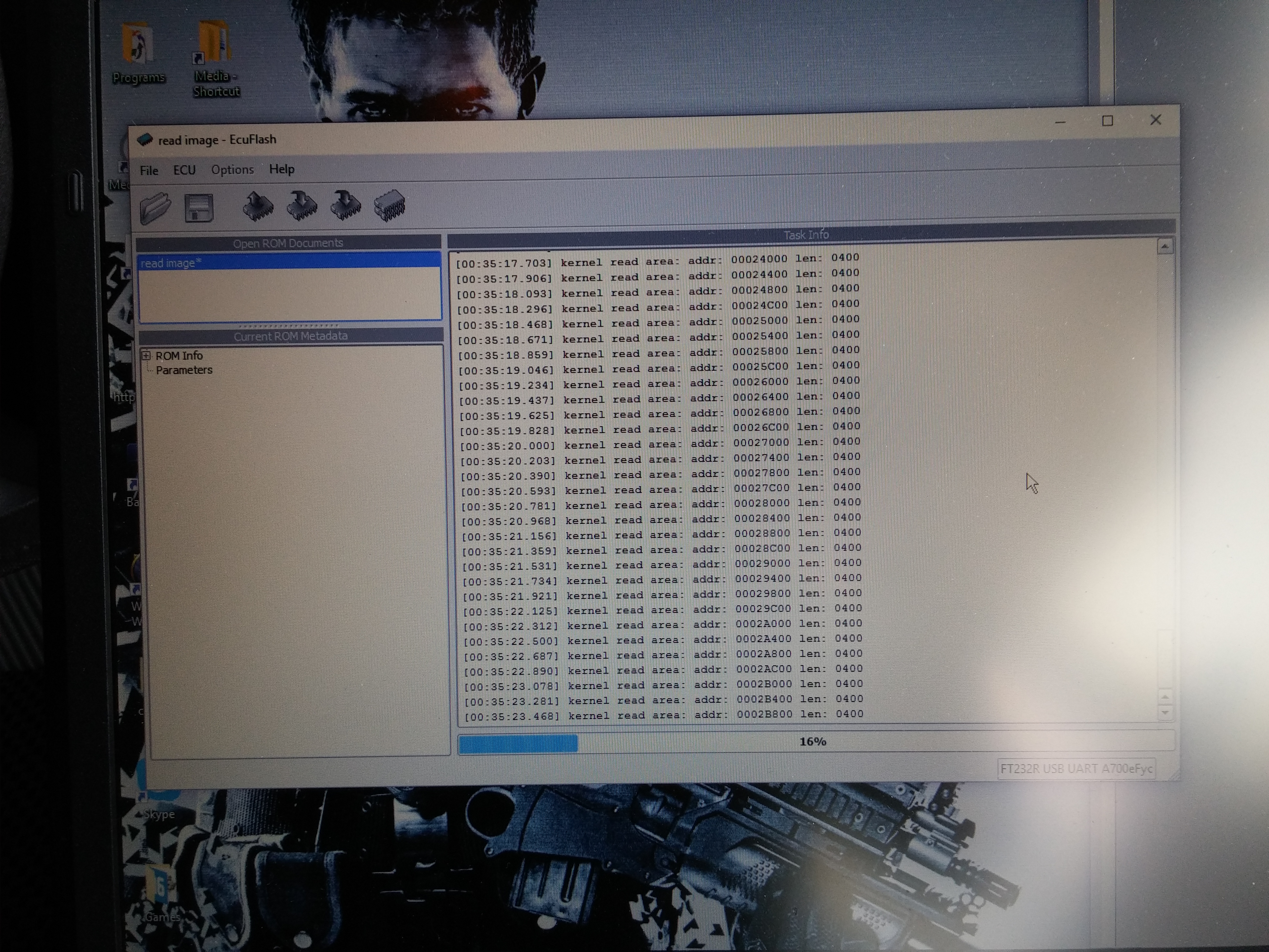

click read from ecu, a menu pops up. choose model of car
fan stops
reads the ecu
make a back up

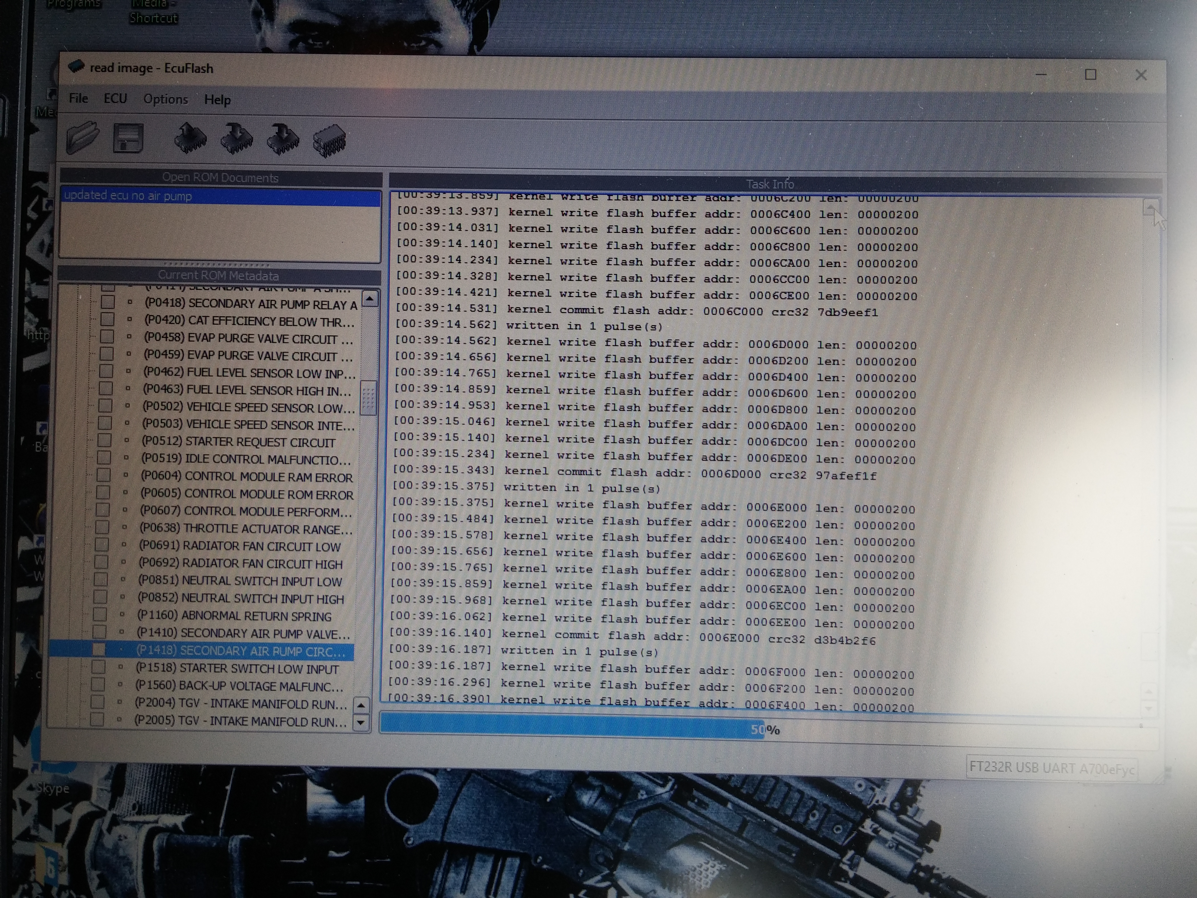

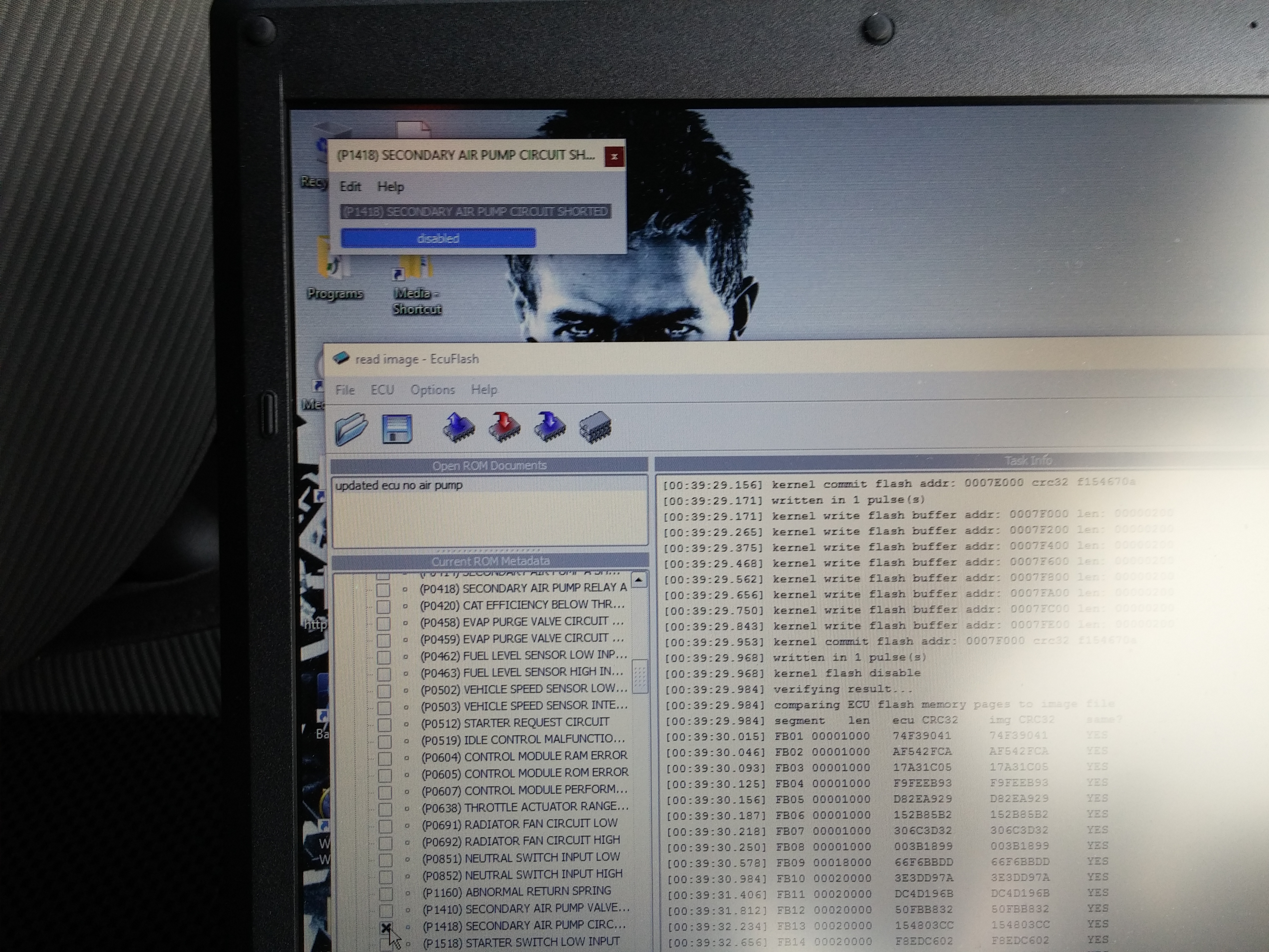

I then went and found the codes, clicked on value and pressed + to change to disabled.
made a second backup with new values
test wrote, was all ok

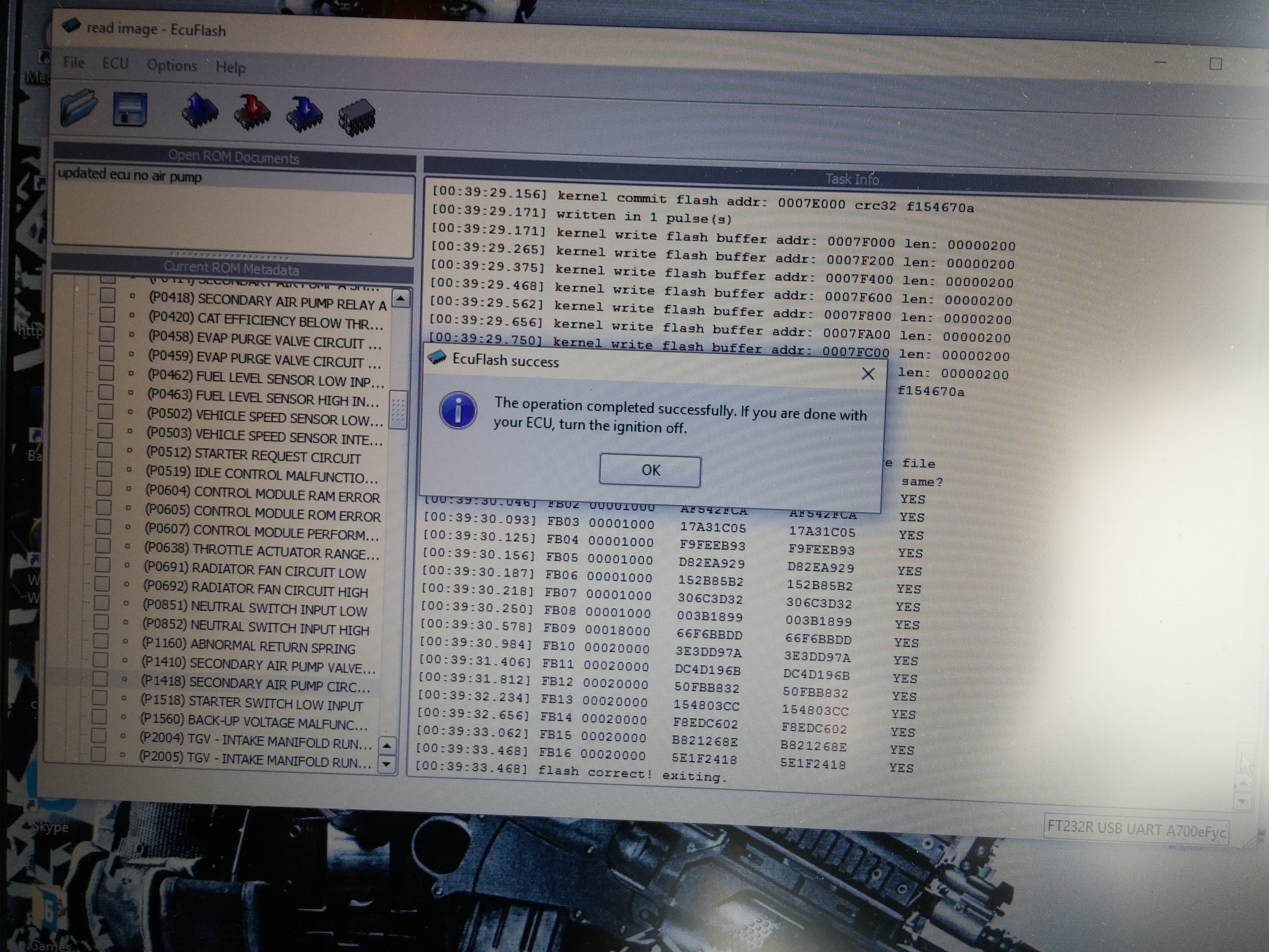

then wrote to ecu
click ok, close ecuflash
turn off ignition, unplug test connectors, turn back on wait for 20 seconds before firing up. done
I should say I did this 2 times in a row as I missed 2 codes off the first time (followed a list of codes to delete for problem but it had 2 missing), after flashing the first time there was no problems with battery. I then re did this and deleted the extra 2 codes. If i had got them all the first time I probably would not of had any battery problems.
