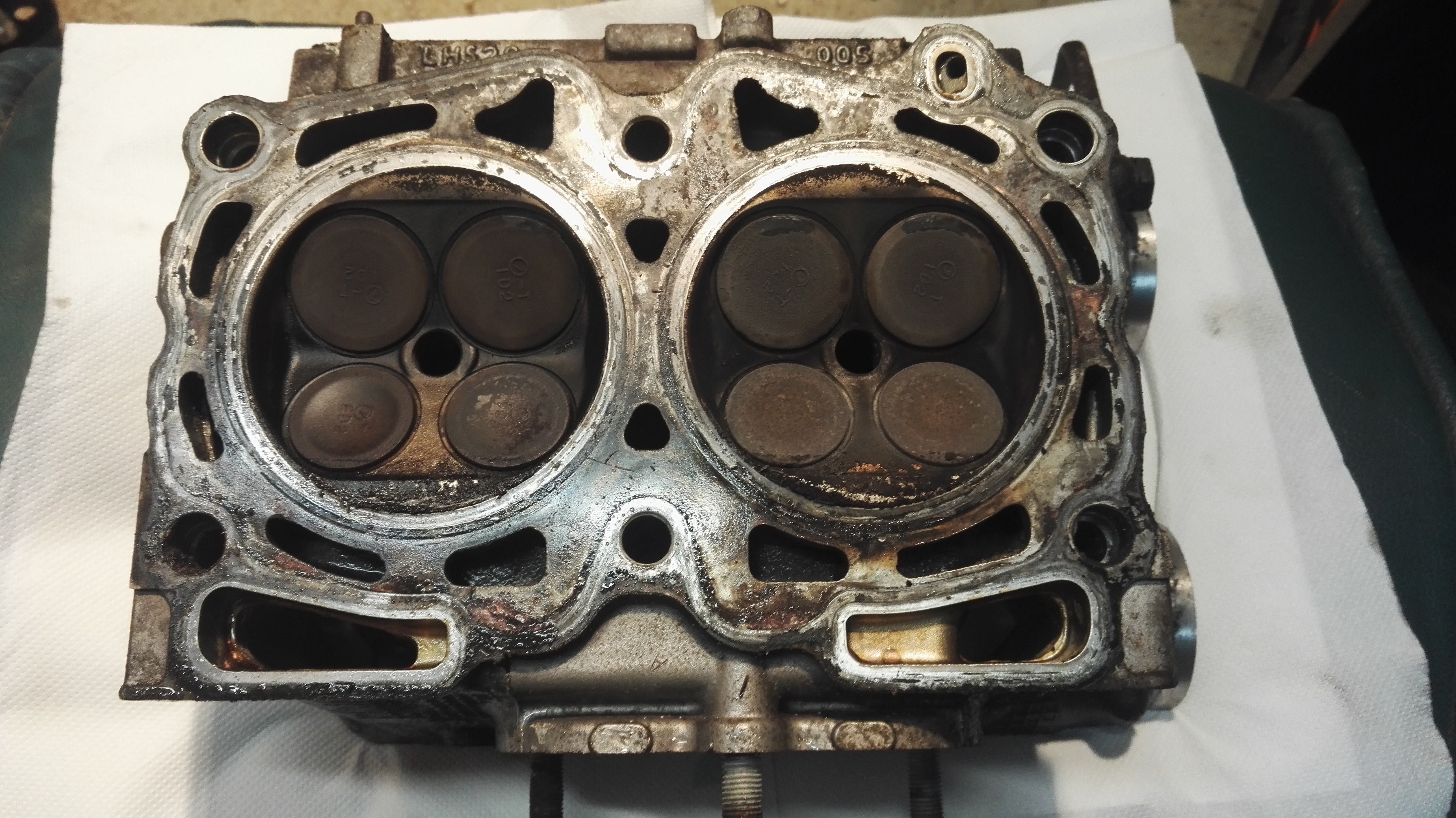

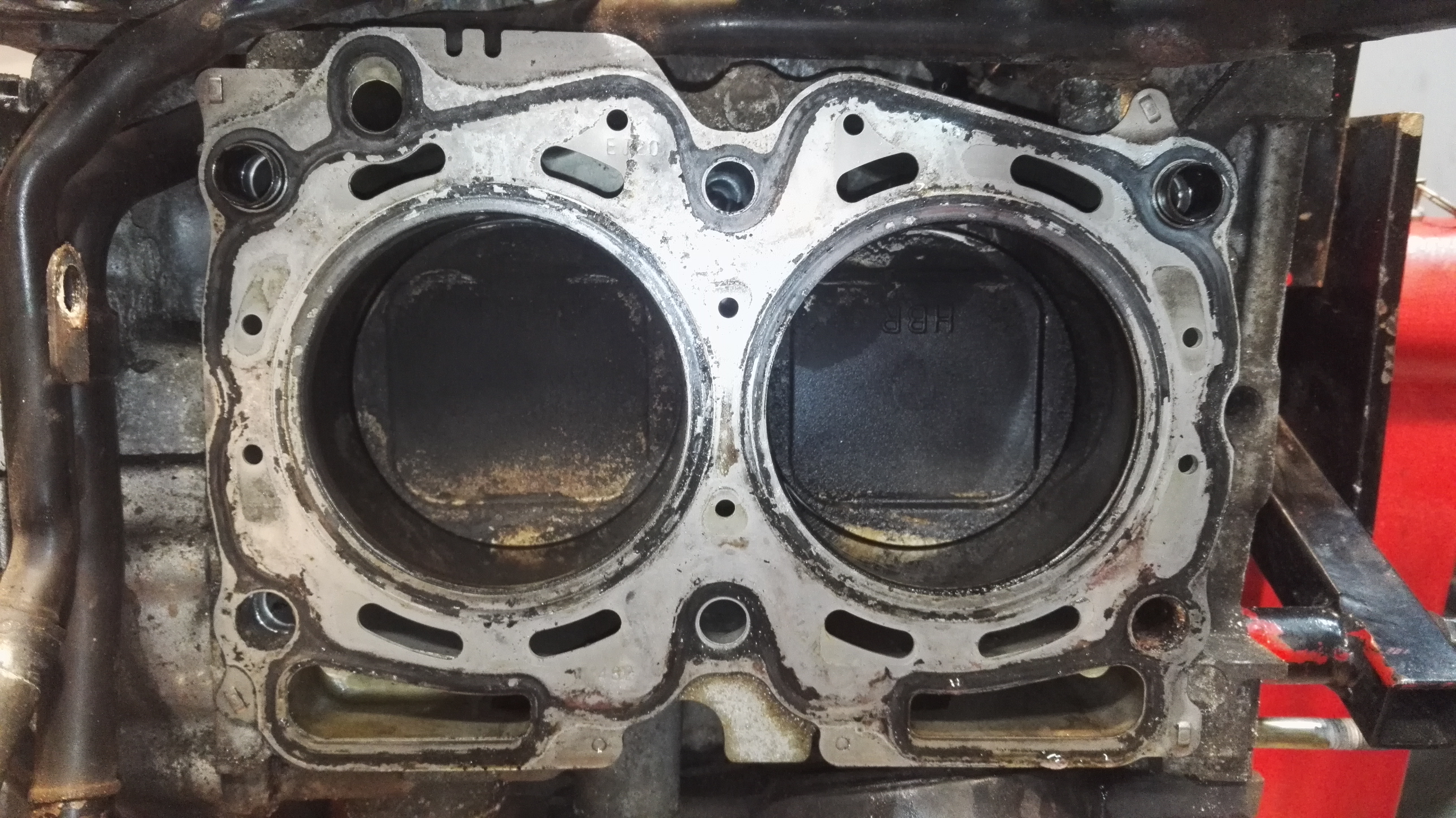

So... the other week, my water pump failed, shredded my timing belt and caused a fair whack of bent valves.
On the plus side, it has given me the opportunity to remove my first engine and learn some new ways to become frustrated.
The engine (EJ205) had around 50k miles on LPG and did not have valve saver/lube so if anyone is intererested in what the valves look like then I'd be happy to post up some pics as I remove more. as you can see the inlet valves on the right had side have taken a bit of a thump.
I'm not sure if the level of carbon build up is fairly standard for a 185K+ car or if it has been increased by the LPG or the fact that for the final few miles of its life I think the timing had slipped at least one tooth.
Anyway, if it is of interest, let me know what you want to see and I'll do my best to pull take pictures.
