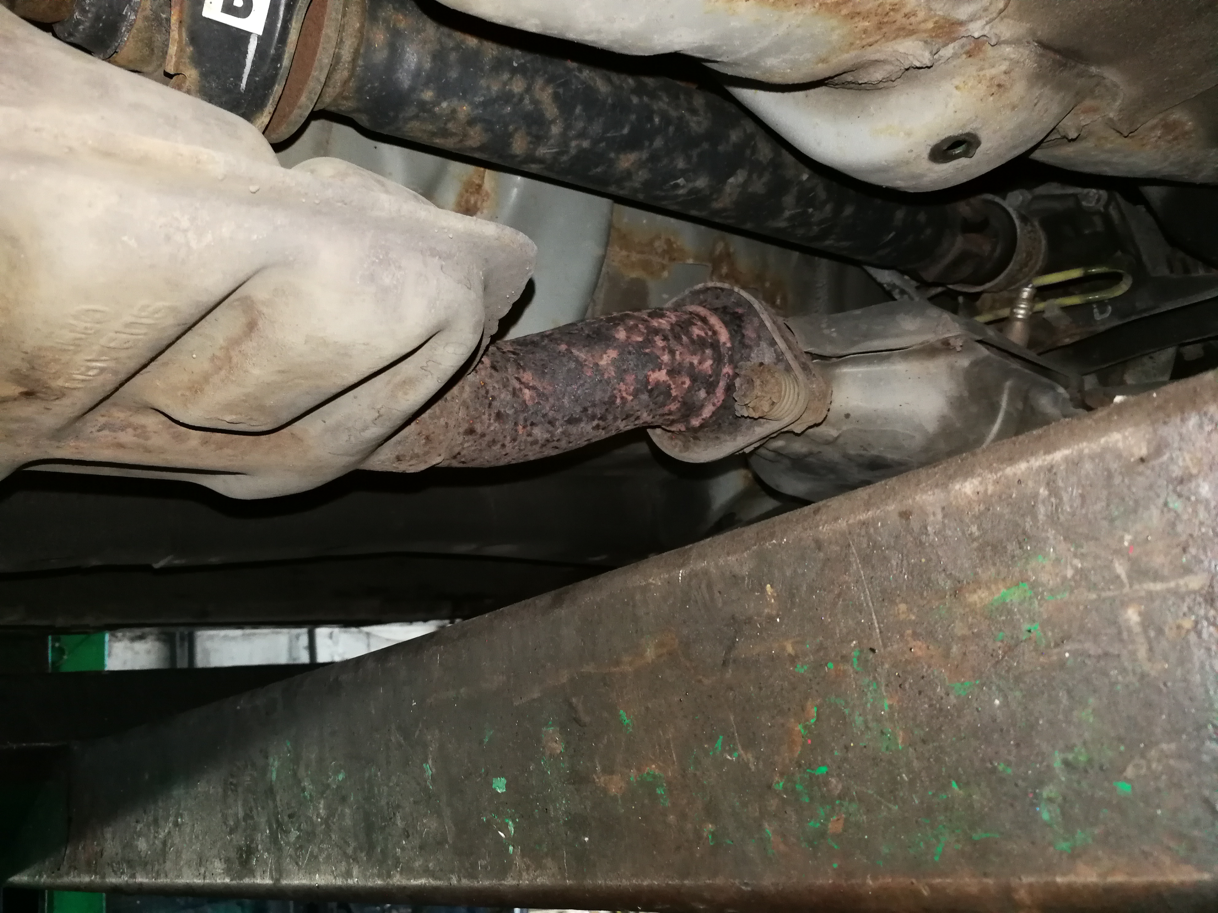

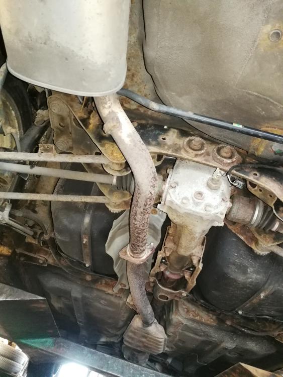

I've managed to get some pictures.  The clamp that connects the cat to the mid-section is rusted and the pipes that connect the mid section to the back silencer have also gone.
But the picture of mine is different to yours.  theres a cat, clamped to a mid section that runs through to the rear silencer.  You might me much more of an ex[ert than me in working
out whether it's the same shape - what do you think?
out wIMG_20170519_145530.thumb.jpg.2ef6682d6d92b6399a0d652e9215ba15.jpgdifferent to yours - IMG_20170519_145540.thumb.jpg.4a3629c012510ed8677a94c0757260cc.jpg
mine had the 2nd cat delete, and two resonators in the middle section instead, but it looks the same in shape and length to be honest,
simplest solution to get what you want (pipe size, neat fit, sound and tip style) is custom made from powerflow dealer or longlife dealer in your area .
should only need mid section and rear as front and cats normally fine/serviceable on later SG, cat flanges can corrode but if rest not bad it easy enough cut and weld new flange to them.
other option is 2.5 sti made to fit via new hangers and slight extension on rear. would go powerflow or longlife route unless find oem sti exhaust for cheap .
