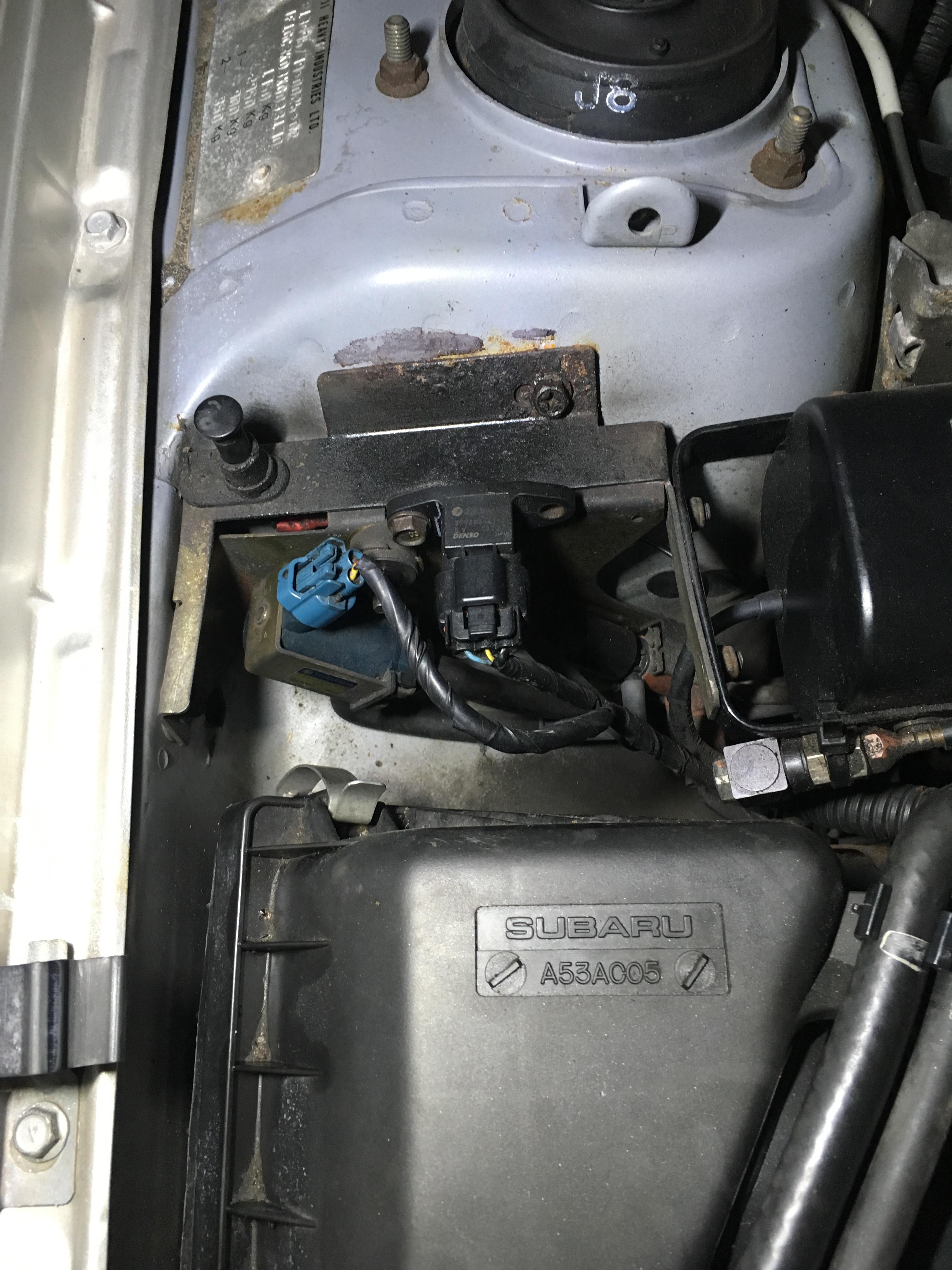

Ive put a pic on. The boost valve is behind the air box. There’s a video on YouTube showing you how to do it. Instead of me writing it out. Ha.

Hi mate depending on what year or version you have the cars came with either a 2 port boost solenoid or a 3 port solenoid,
The 2 port one is good at controlling regular levels of boost, but if your going over the 300bhp then a 3port one will control the boost alot better, and avoid any unwanted problems, with overboost or spiking or bleeding of and leaving you with none,
If you look at the engine bay from the front of the car you'll see it attached to the suspension turret on your left, there's alot of pipes and vac lines running around it.
2port 1st pic
3 port 2nd pic
