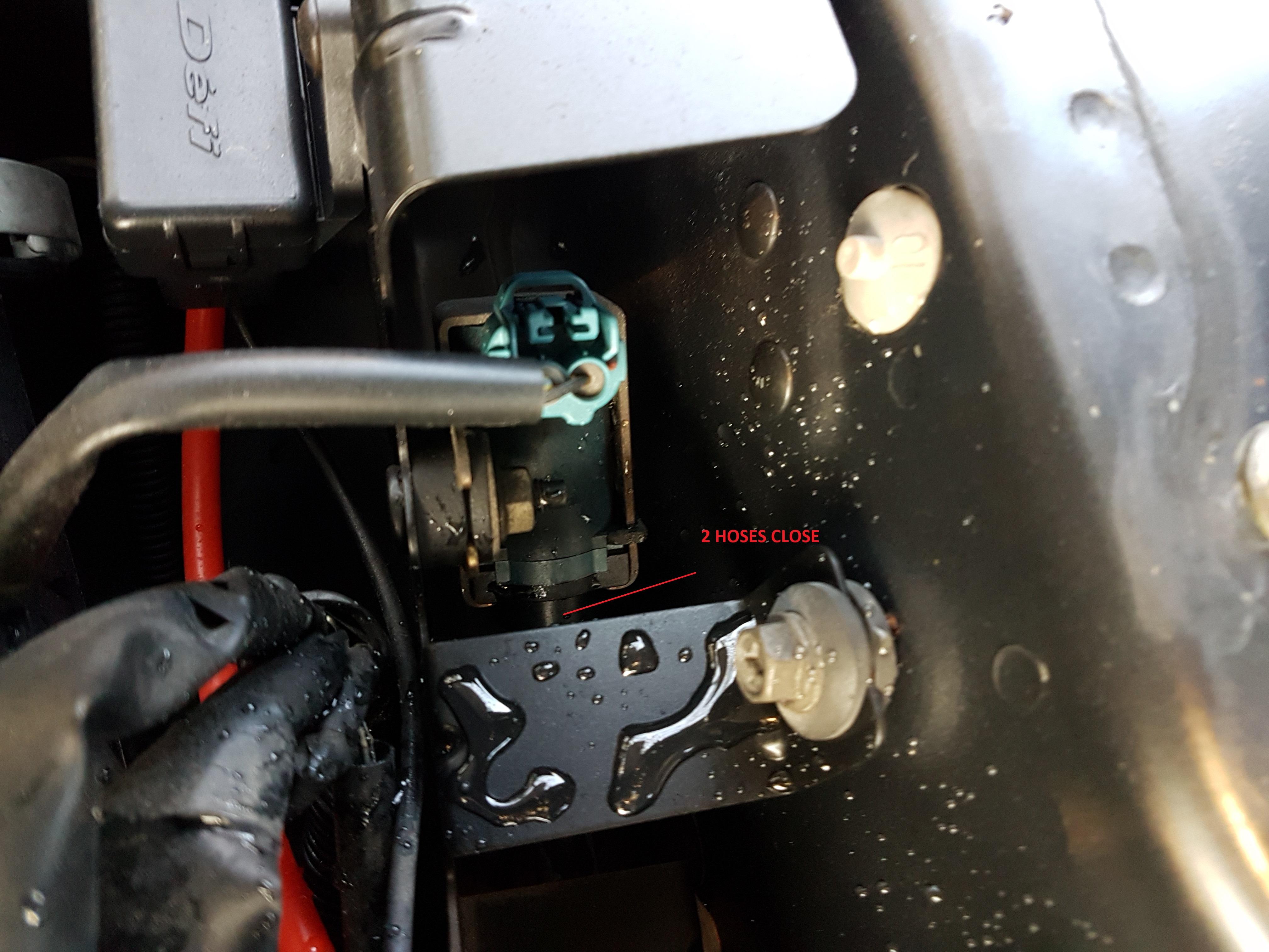

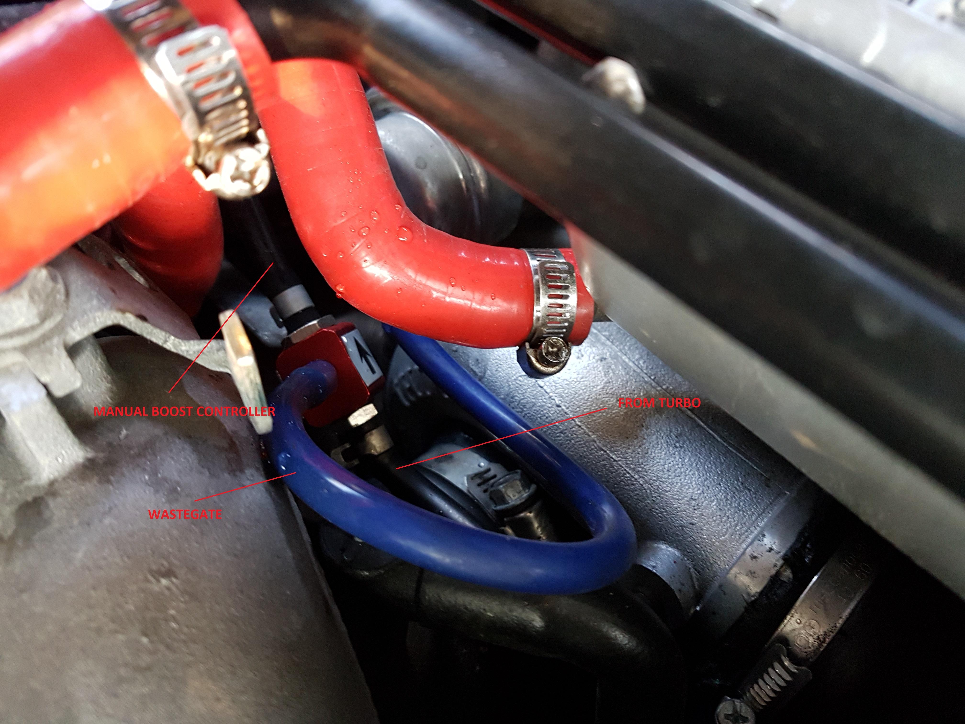

i just need to connect the hose coming from turbo and wastegate together and then to  original boost controller and the other hose coming out from original boost controller to intake ?CameraZOOM-20181021173308513.thumb.jpg.20705cd9acd7d56e7e7061af7dd614cc.jpgCameraZOOM-20181021173228896.thumb.jpg.2a205d77f3a05df9972c472e4c4d2d41.jpg
You should connect the turbo hose in T splitter, one side to the wastegate and the other to the bcs.
But pay attention, inside the hose that goes from the turbo to the T should be restrictor pill. What size to your car exactly I don't know you have to check it.526bb202ef0fd3817af7dd49f4a0f2de.jpg

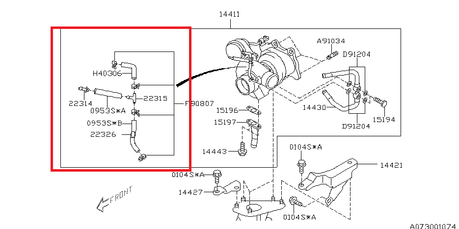

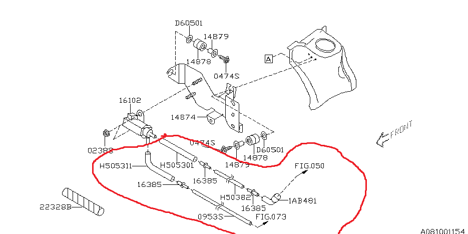

i buy restrictor pill,  1.2 for wrx 2005, but i dont have hoses and the other restrictions for everything, they cost more then 80gbp. can i only buy restriction and then measure  and buy silicone hoses? (n.16385 ,22315,22314)
resource2.png.dc9541dc20cc7befce267694f8d31025.pngresource.png.0fa3c10dd0b91fc4c8ef83d3c27b29e9.png
I also didn't buy OEM hoses by the time I replaced mine, just put 3mm silicon hoses between the T and the wastegate/bcs, than from that 3mm hose you should get connector that goes from 3mm to 6mm and from there to the bcs with 6mm hose.
The same I did with the hose that goes back to the intake, 6mm hose the connector the other side is I think 4mm (that what I put,don't think it matters what size the air going back to intake) than another connector from 4mm to 6mm again. Hope you understand me.
