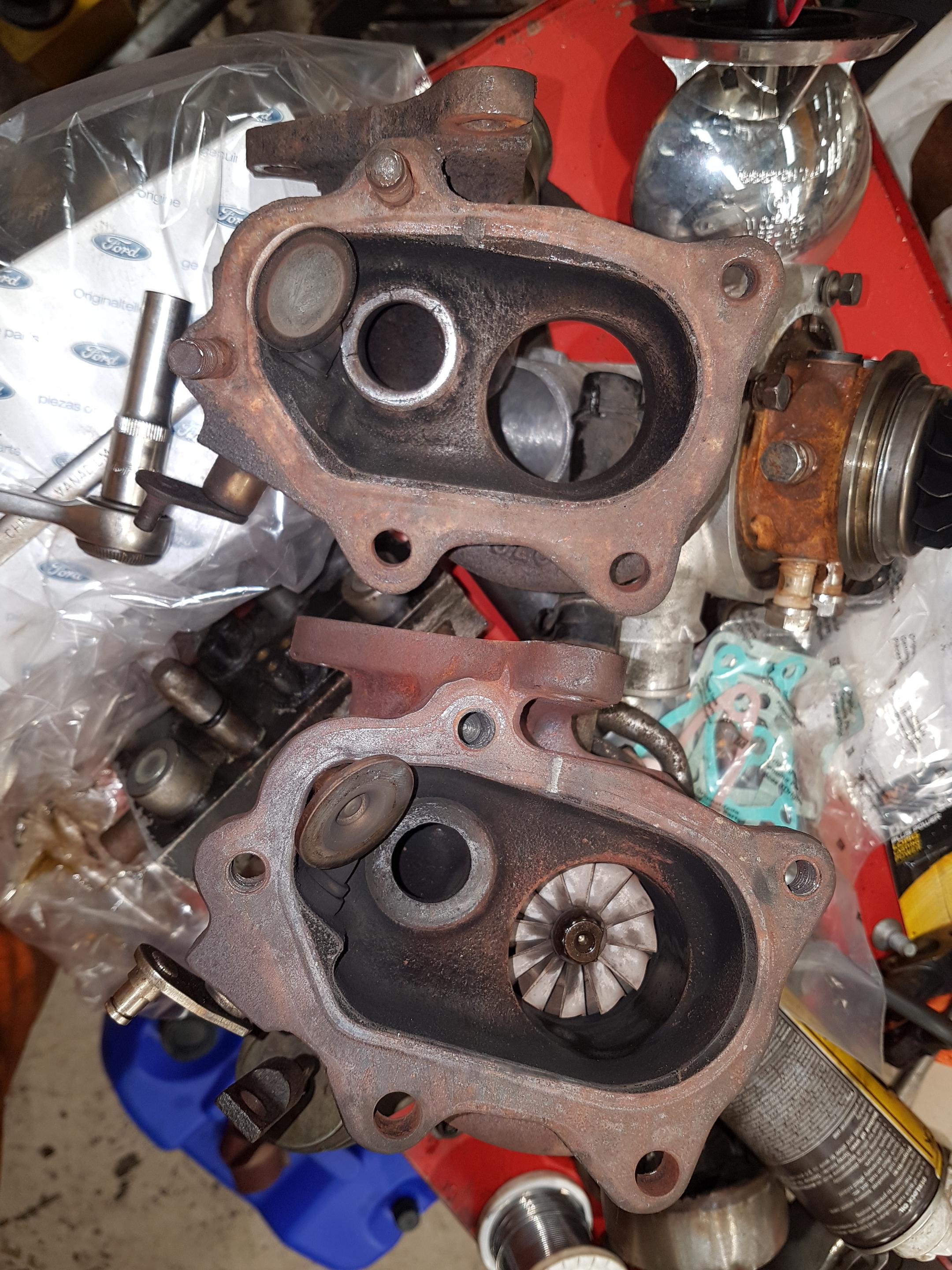

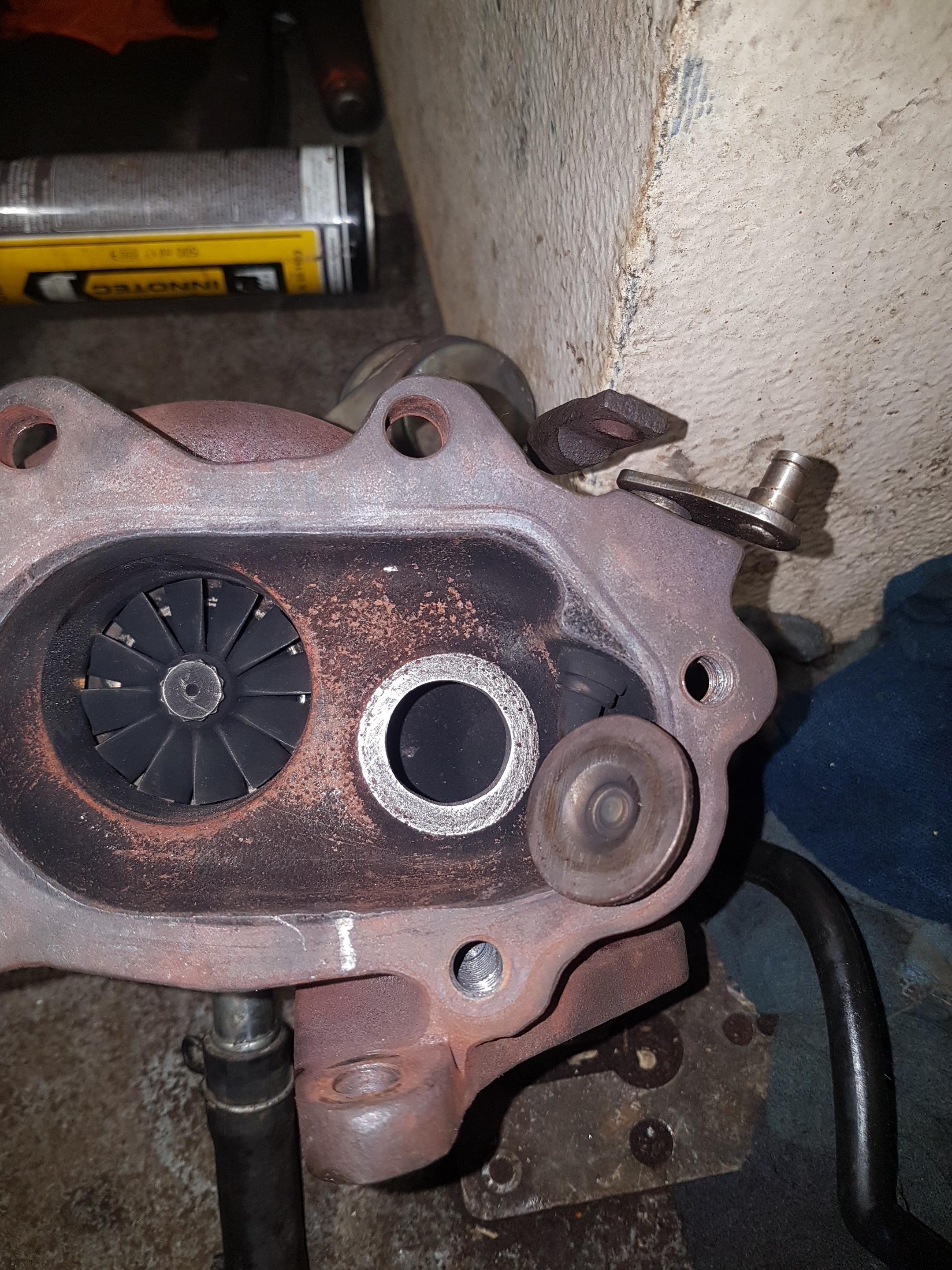

Been having a little boost spike problem since repairing the turbo so took it off and found the wastegate hole to be 10mm smaller than on the original one so must be a copy exhaust housing i bought, the original wastegate hole is 25mm and the new one 15mmย
So i got my die grinder out and done a bit of self porting to make the hole the same size as the old one so as to give the exhaust gas a bigger surface area to push on the penny which in theory should open easier thus eliminating the boost spike ( hopefully )20190410_124103.thumb.jpg.fa4a962b617671e8858fa005e60feabc.jpg
, got the turbo back on after work today but not finished yet as have to fit a caliper to the wife's car ๐Ÿคจ๐Ÿคจ, will update tomorrow when i finish the job and have a wee blast along the road ๐Ÿ˜Ž๐Ÿ‘
Thought that might have been the reason for yourย boost issues but tbh my money would've been on a faulty actuator.ย
You might have to refit the actuator it was mapped with too , so it has the same strength spring that it was mapped with ๐Ÿ˜‰
Seems to have done the trick mate, finished it off last night and got it out today although i never really got to boost it much as was in traffic most of the way, going out soon so will see how things go ๐Ÿ˜Ž๐Ÿ‘
