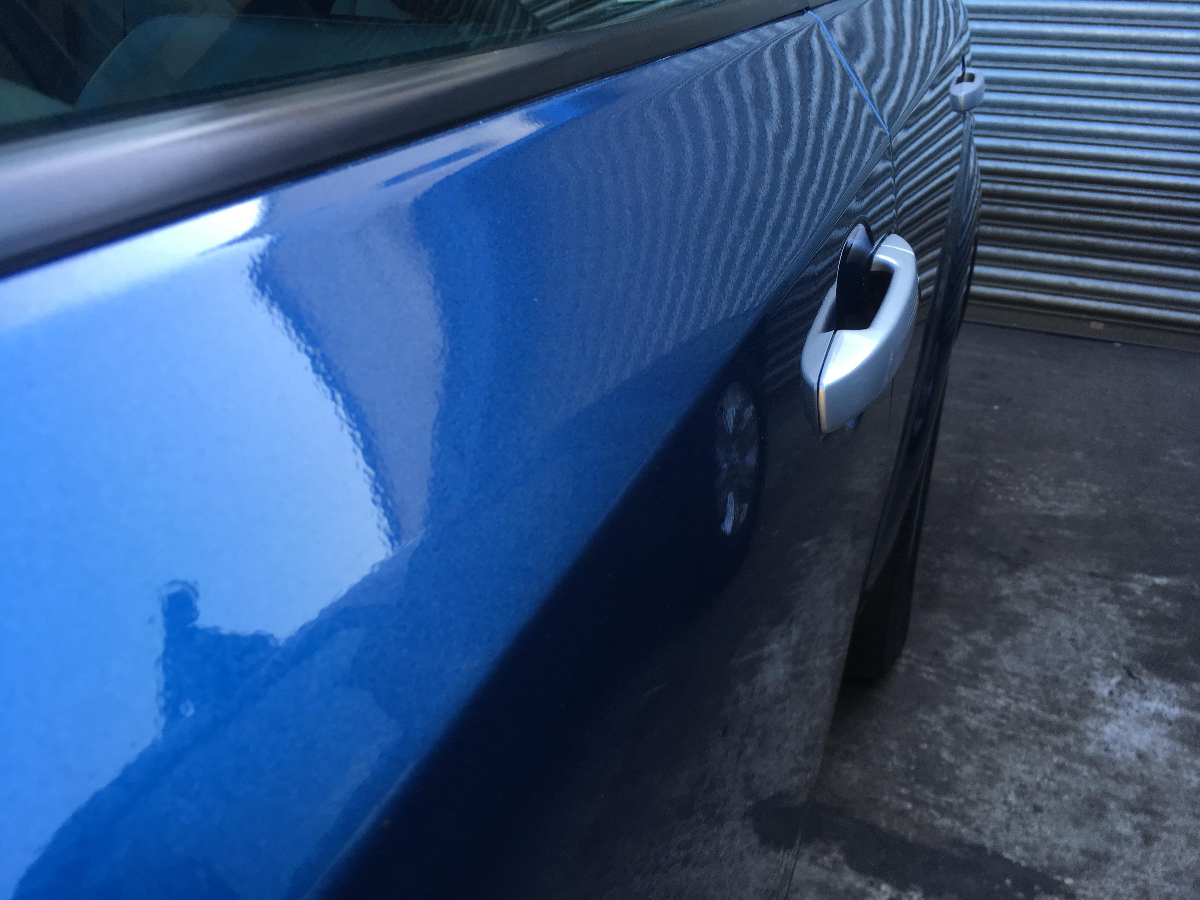

Been looking at a 2011 2.0 l manual XS, Forester, 89k miles, FSH, 2 owners, for sale in small dealership ( portakabin office, chain fenced lot )
Car seems to have been re-sprayed on passenger side. Some "orange-peel" paint, slight overspray inside wheel arch. Dealer asking £8,600
Would signs of a partial re-spay put you off a car this age?  It's easy enough to get a bad scrape across passenger side, I've done it myself.  Hard to know what it's covering though.
( The last Forester I was about to buy, in Wales turned out to need a cam-belt, even though advertised as "Cam Belt Done" "FULLY SERVICED" ( they didn't mention it was 5 years ago), rear exhaust box rotted & repaired with gum and was also a grey import from Canada, again not mentioned in advert) I'm getting weary.
It wouldnt put me off if the rest of the car was fine  -panels aligning etc, it could just be carpark dings or someone keying the car, If the panel was full of filler with a big dent the window would not go down, door opening mechanism fouling etc.
when you can see how poor the paint finish is on a internet picture it a pretty cheap cheesy repair .
Main issue is you don't really know why it done thus it a risk and the price really not reflecting body work state .
Your main issues will be future paint issues of cracking peeling oxidising, slight rust if edges not finished well (they not stripped trim to spray properly)
I would be looking at panel fit and tyre wear, and steering behaviour on a test drive, lot of cars won't be recorded for smaller prangs with no other party involved as if don't go via insurance and take to small bodyshop it not going be recorded .
I wouldn't pay much for example like that, main thing you got do when buying a used car is not give in to haste, keep calm and keep looking or be sure anything less than perfect is bargain price and you prepared except it or get it sorted as needed .
From my experience the biggest piles of junk and biggest prices ever seen always been via dealers and man do they lie and waste your time .
Decent panel spraying is expensive and none of it matches factory paint for durability so reflect on that before parting with your hard earned .
Due to fact you can see overspray under arch also possibly indicates work quite fresh as generally light overspray soon worn off or covered by dirt build up pretty quickly .

That annoyed me when I asked about possible re-spray, dealer says "I can't see what you are talking about, where do you see re-spray?"  ` I point out "orange peel", missing scuff protector on one rear wheel arch ( probably removed to aid re-spray) but still present on other side, overspray on plastic wheel arch liner. Then he says "Don't know, I suppose it's possible", "Must be a good job if I can't see it"

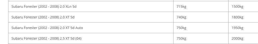

Delving further, it looks like the older 2002-'08, FG, 2 litre XT turbos can tow 1800kg which is very interesting!  That would probably meet my needs and would mean a wider range of cars opening up. Plus the old XT's have high spec, leather, Sat nav, reversing camera ( which is great for getting hooked up to a  trailer fist go, on your own)
Weirdly, the data base I found shows the 2.0 XT Auto as having a higher towing limit than the manual? Which makes me doubt the accuracy of the data base, unless the auto has a special trick that lets it tow more? maybe it's just a heavier car?

I think earlier SF sport or turbo also might be 1800kg but you need confirm that as fact .
you lose the low range on turbo .

I'd look at an Auto if I thought that table I posted earlier was accurate; i.e. 1900kg towing limit.  I'll need to dig around. It can be hard to get accurate info on towing capacity for older cars.

I was under impression actual tow weight not exact legal figure but just easier have insurance and prosecution if police pull you or you in an accident and you above the guideline figures .
I think the higher hp engines got higher limits as match the gradient pull off tests but I no expert in towing requirements so you need do some due diligence on that get the facts .

On the opposite side of that my WRX was in a bump which required whole new wing and paint job. As a buyer you can see the evidence in the gutter of the wing when you lift the bonnet (one side shiny other original matt), and would put me off. I know it is not problem and would by the car again all day long. Tricky but in your case the fact there is overspray and the orange peel it has been done on the cheap. What else has been done on the cheap? If you feel they are covering it up then stay away. Subarus cost enough to run without issues and nothing is worse than a cosmetic issue like it has as it will always annoy you. From reading the whole post I would look for another.
