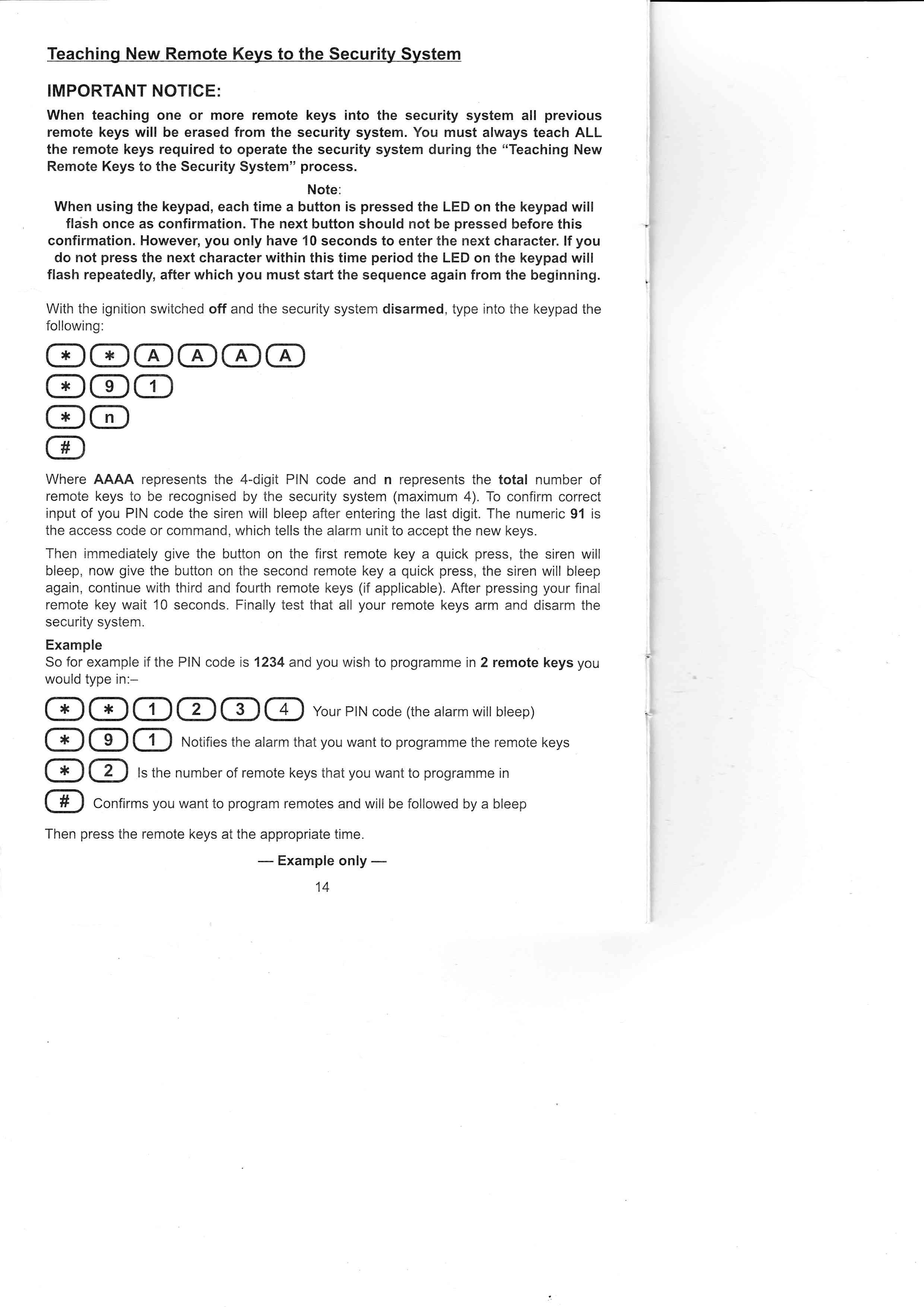

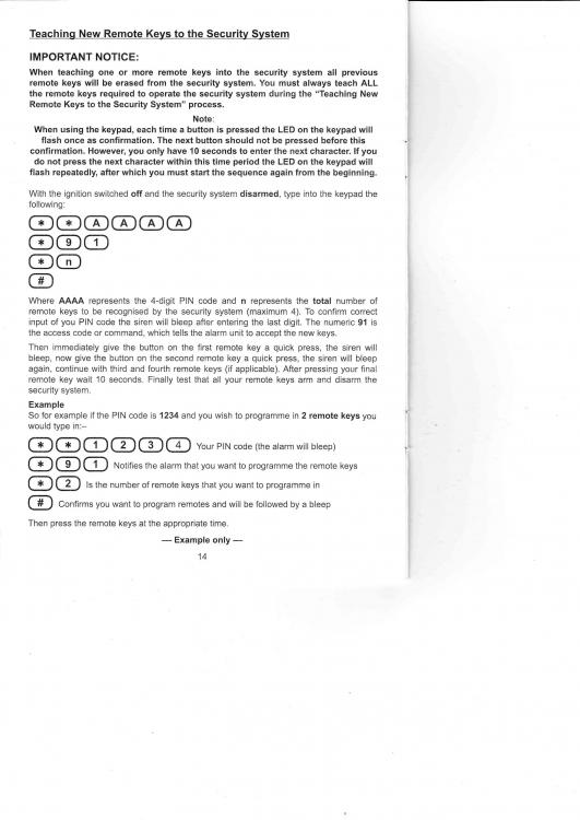

Siluro Posted August 31, 2019 Share Posted August 31, 2019 I have the manual in front me on how to reprogram a fob. Mine is a sigma M30 is yours the same? If so I will scan the page and upload for you. Quote Link to comment Share on other sites More sharing options...
Siluro Posted August 31, 2019 Share Posted August 31, 2019 Here you go anyway. Quote Link to comment Share on other sites More sharing options...
