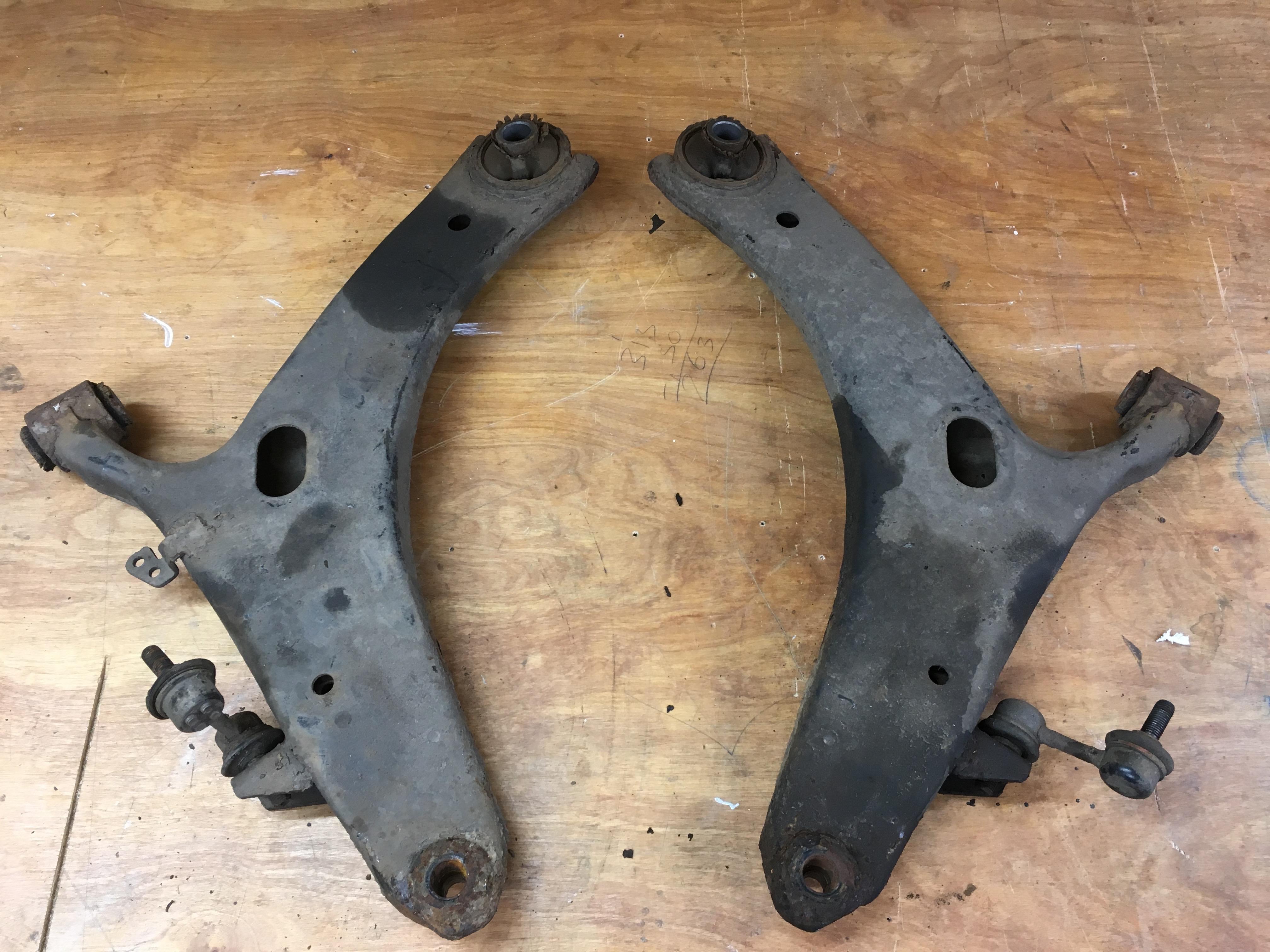

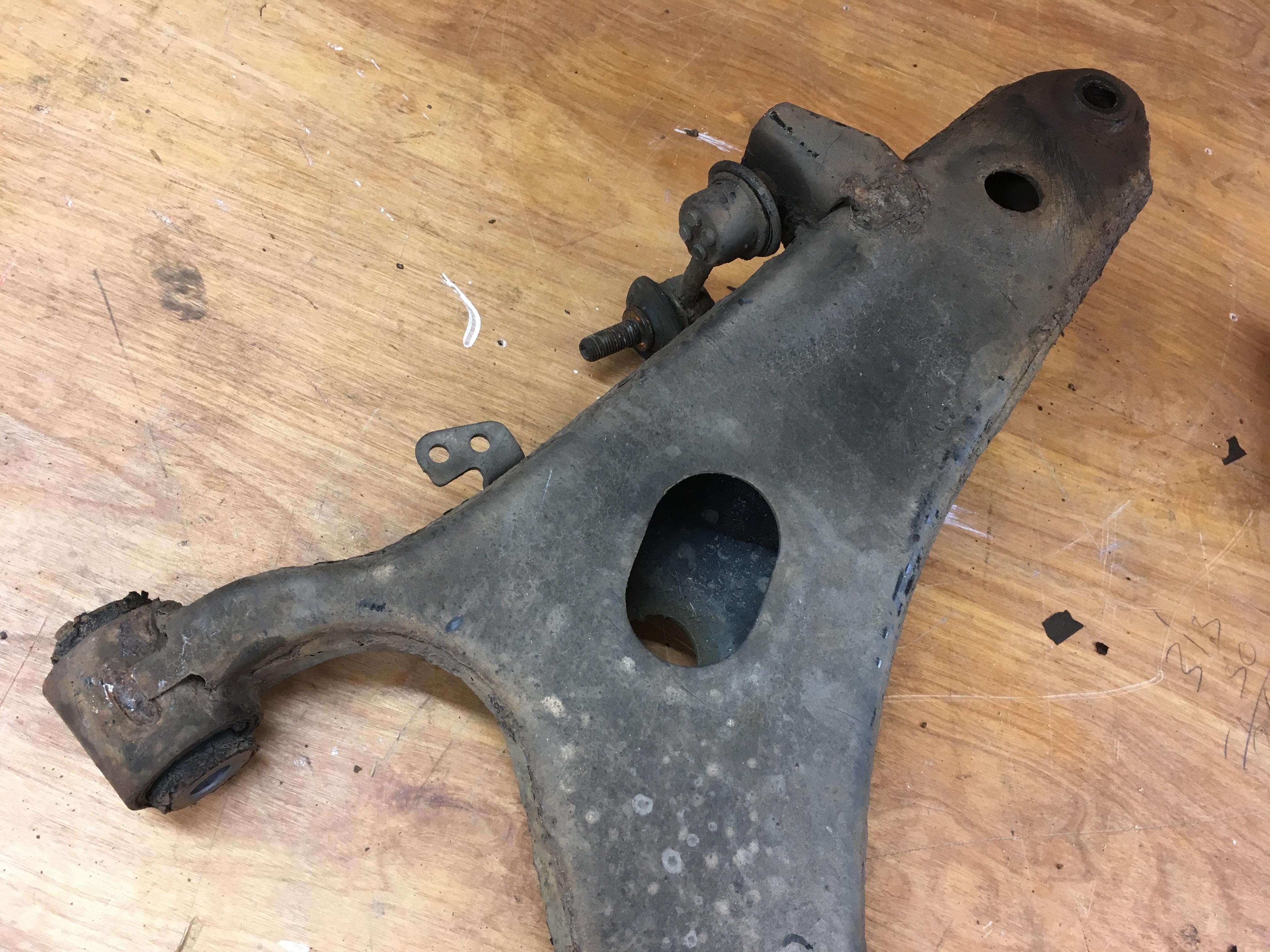

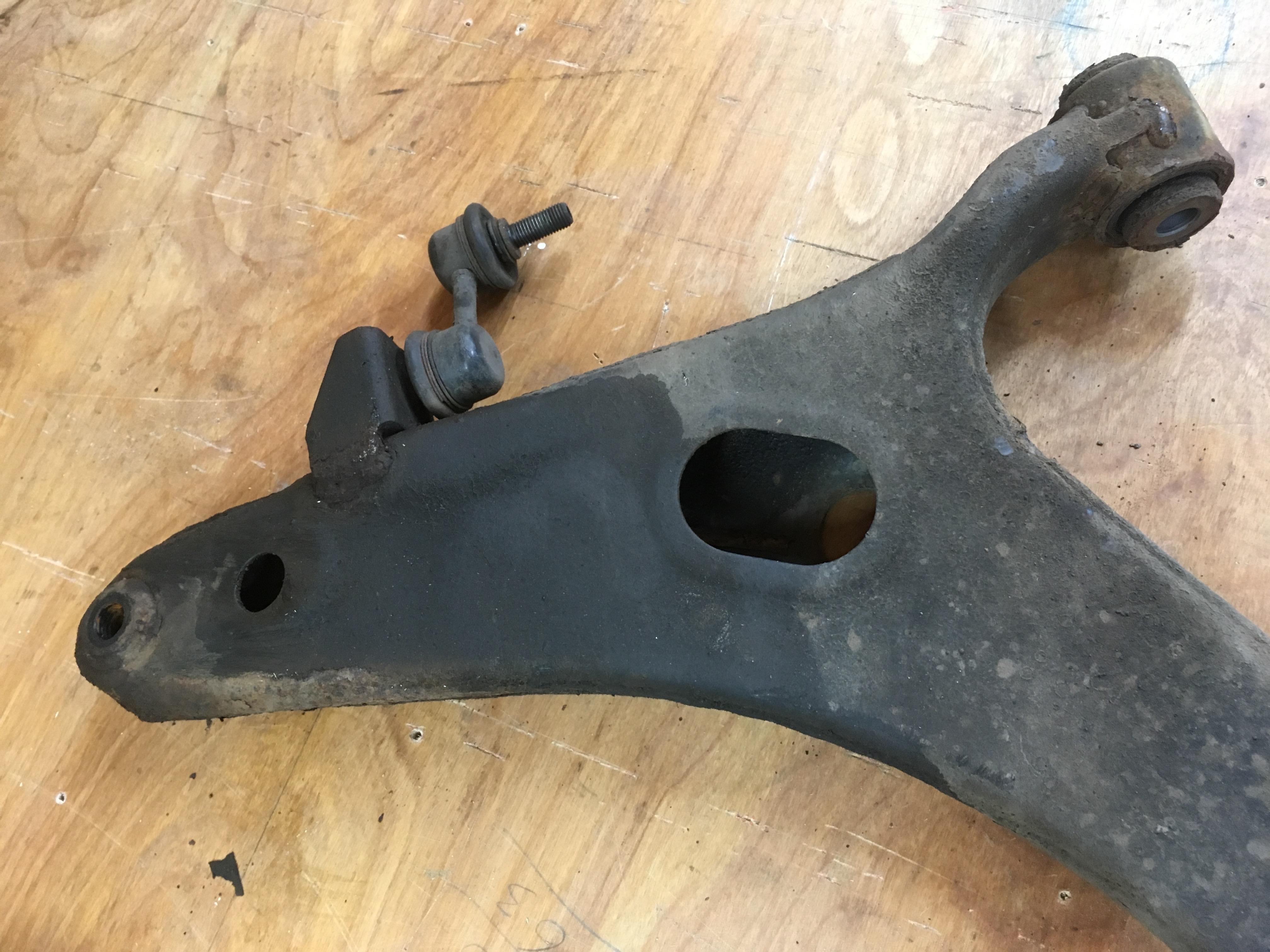

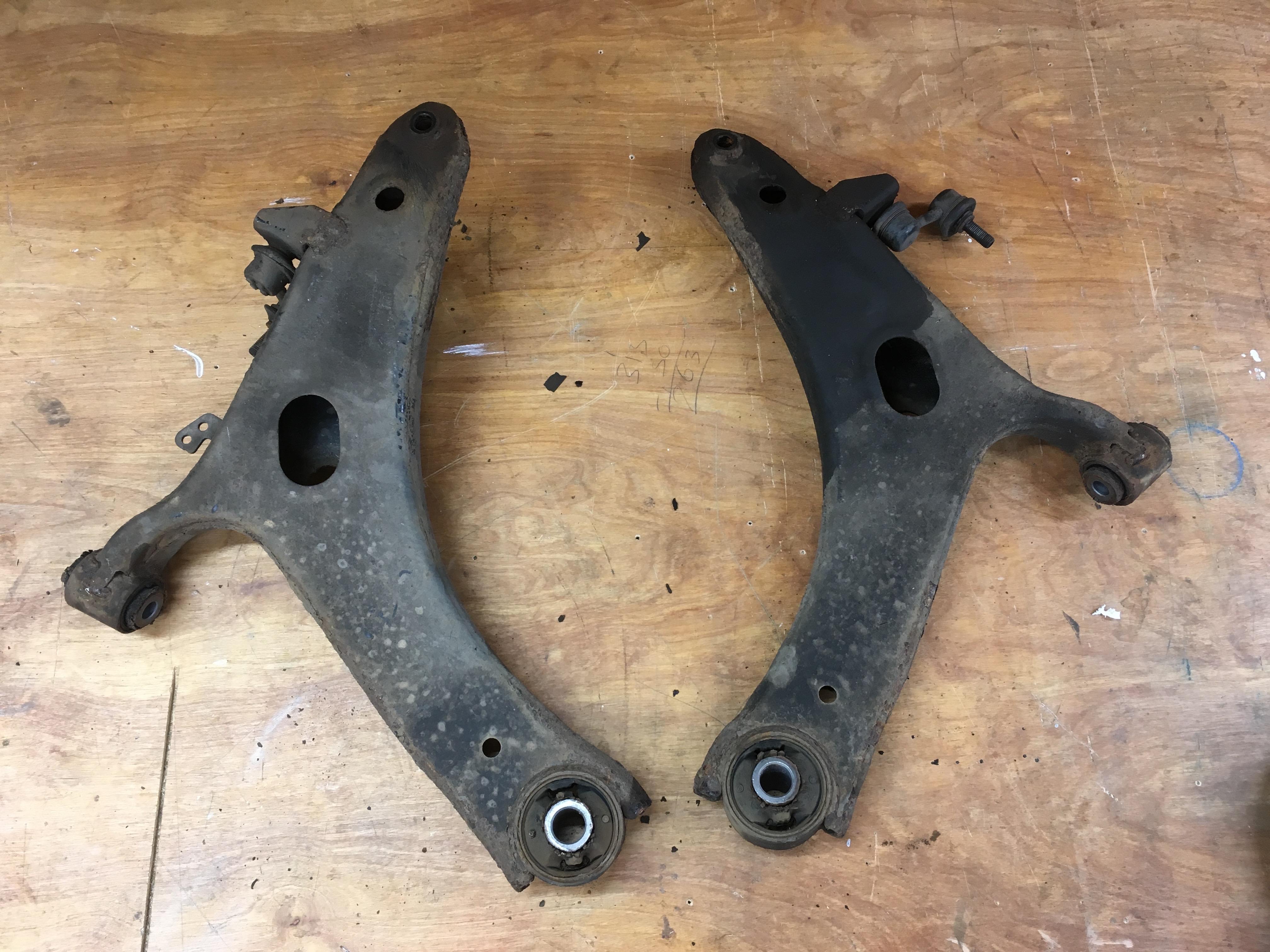

Thanks Mr B. I shall look into these for any future repairs. Below (hopefully) pics of what came off the car. Replacement arms, from Subaru main dealer, were £270 + VAT each! So £330 odd. Painful. My mechanic is good and trustworthy, even gave me a discount off some other parts to soften the blow and only charged what he paid for the arms. But maybe I can help him source cheaper Subaru "hard to get" parts in future.
Doesn't take long, either use hydraulic press or bush forcing screw tool set .
With bush forcing screw tool set and air hammer we can do some bush replacement without removing suspension arms fully thus saving time and parts needed .
If can't get them out in one, push rubber out first, then cut wall of metal sleeve with air hacksaw or recip sawsaw and tap it out, decent air hammer super useful here .
It takes me about 2hrs max remove rebuild and fit front pair lower arms, cheapest option is the pattern arms around £66 and just bolt on but quality not good enough for my liking on cheaper whole arms want use that route .
It a must for safety, end result drive feel and long life thus better long term value use better quality only for suspension repair .
Those horizontal mounted rear bushes don't last long, awful design when used on rovers decades ago and euro trash used it too, older design subaru front arms rear bush way better but not as cheap make 😕
too many accountants and not enough engineers in modern manufacture 😞
