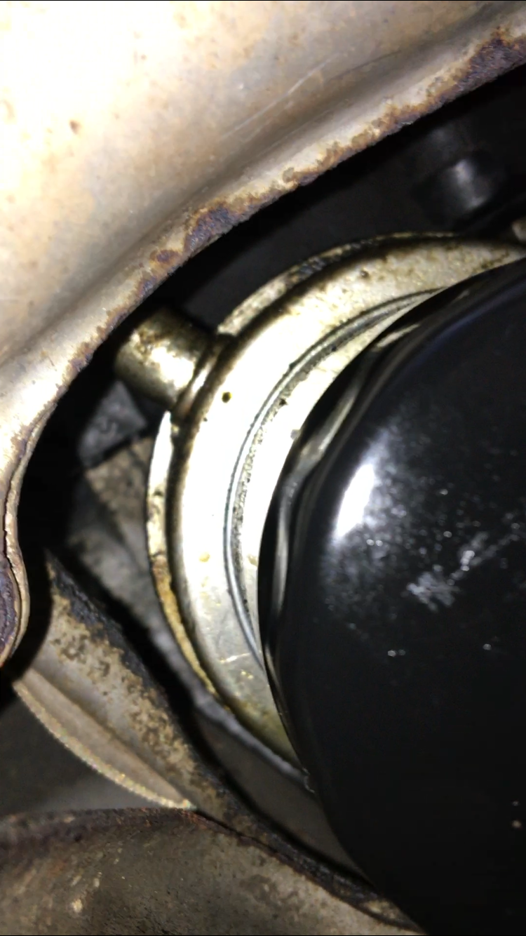

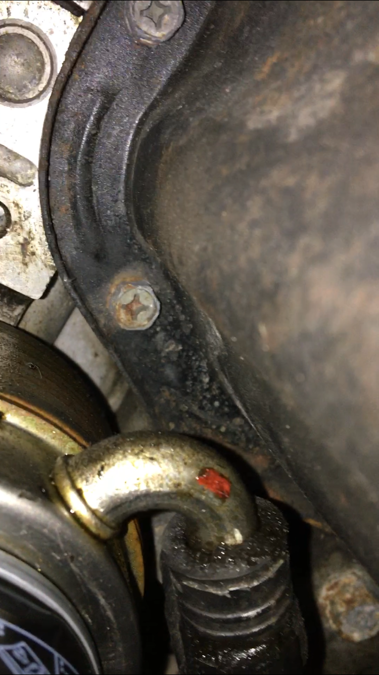

Hi guys I’ve just been under my car to try and find my leak looks to me like it’s coming from the feed line into oil cooler anyone see anything
tried to upload a video but says no to iPhone
It is from the oil cooler o ring ,there is 2 or 3 o rings.
Sent from my SM-A705FN using Tapatalk
Ahh I did change the o ring but had no idea there was more than one. I changed the one the connects to the block. It is possible I never done it right also but 🤣
On at least up to bug eye , that pipe with the oil on is for coolant that passes through the cooler /modine.
So I'd say it's either from the filter seal , modine , the main bolt that connects through the modine or from above that . Like sump, cam cover or cam seal ect

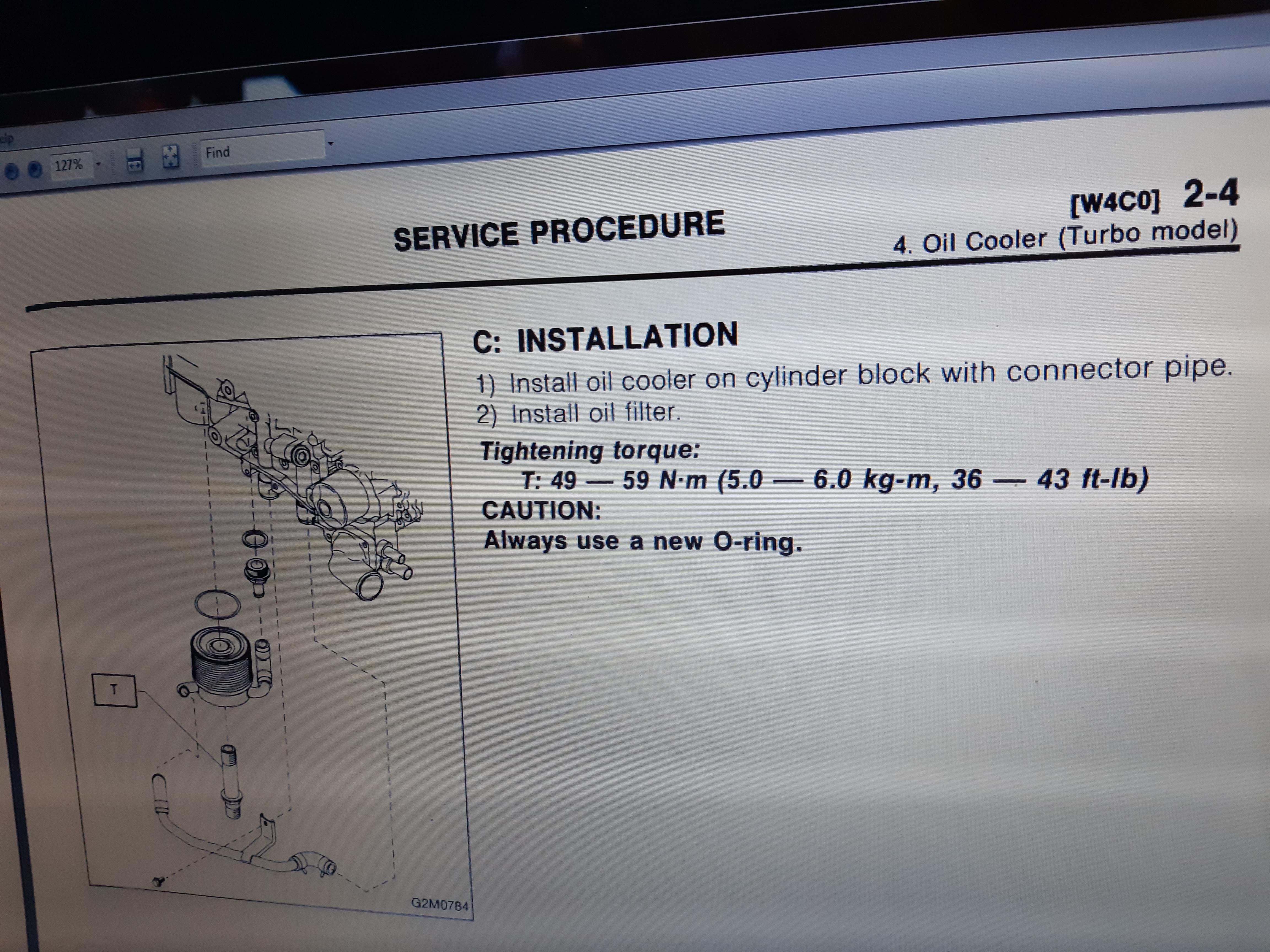

Here's a pic of the early 92 to 96 oil cooler set up for a v1 /V2 from my service manual that might help .
Thanks man I have paperwork stating the cam seal was done in ‘17 it also says that a used sump was fitted however so that is possible. I’ll just need to systematically go through the lot cause I’ve tried taking it to mechanic and still have leakage 😔  thanks for the replies guys 👍
