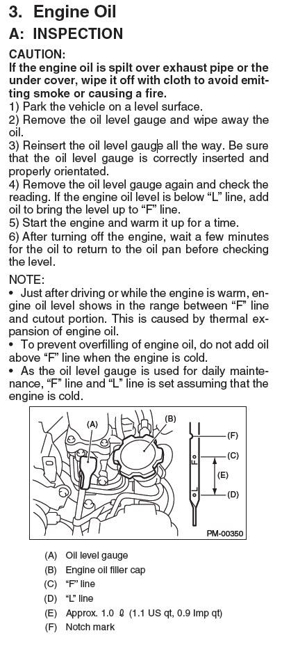

What's the little cut out bit on the dip stick for ?
I assumed the high and low marks were the little holes next to where it says H L ?
i dipped my oil this morning and thought the same, good question :)
God dam it I see stupid question and though nice one, one I can answer :D
Tuts gambit i was expcting you to have come up with an answer by now ;-)
If you have an owners manual (i don't) it would tell you. For anyone who's interested see pic

Ah no worries i was only pulling your leg. I stumbled across the answer when i was looking for something else, full of useless information me haha !
