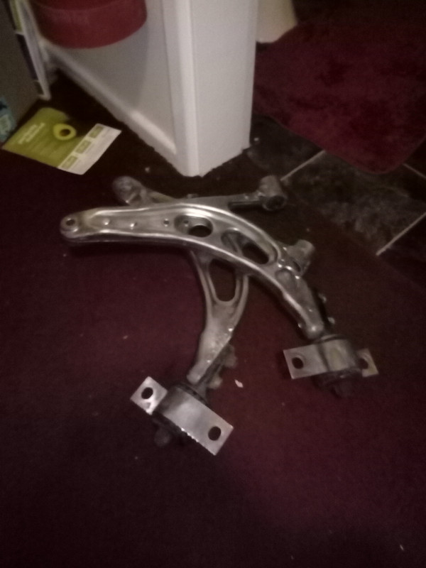

Finally got a pair of alloy arms. Didn't come with the cone inserts so thanks for noting them Mr B.
It was the second set I ordered so they did have the bushed already bolted on, but the seller had done a very nice job of cleaning them up. Installation was fairly easy this evening and been for a test drive. All is feeling good. This weekend I plan to swap the non broken side over to the alloy arm. Then I want to get the car properly alligned and tracked.

Typically I now realise I should have changed bushes at the same time, and will need to before my MOT in April. So now I have to decide whether I put new bushes in the second set of arms I ended up with (but that are a lot messier and need cleaning up) or use the messier arms temporarily whilst I put new bushes into the arms I currently have on the car. Either way the second set of arms means I won't need to disable my car for a long period of time, so right not works in my favour that I ended up with them.
