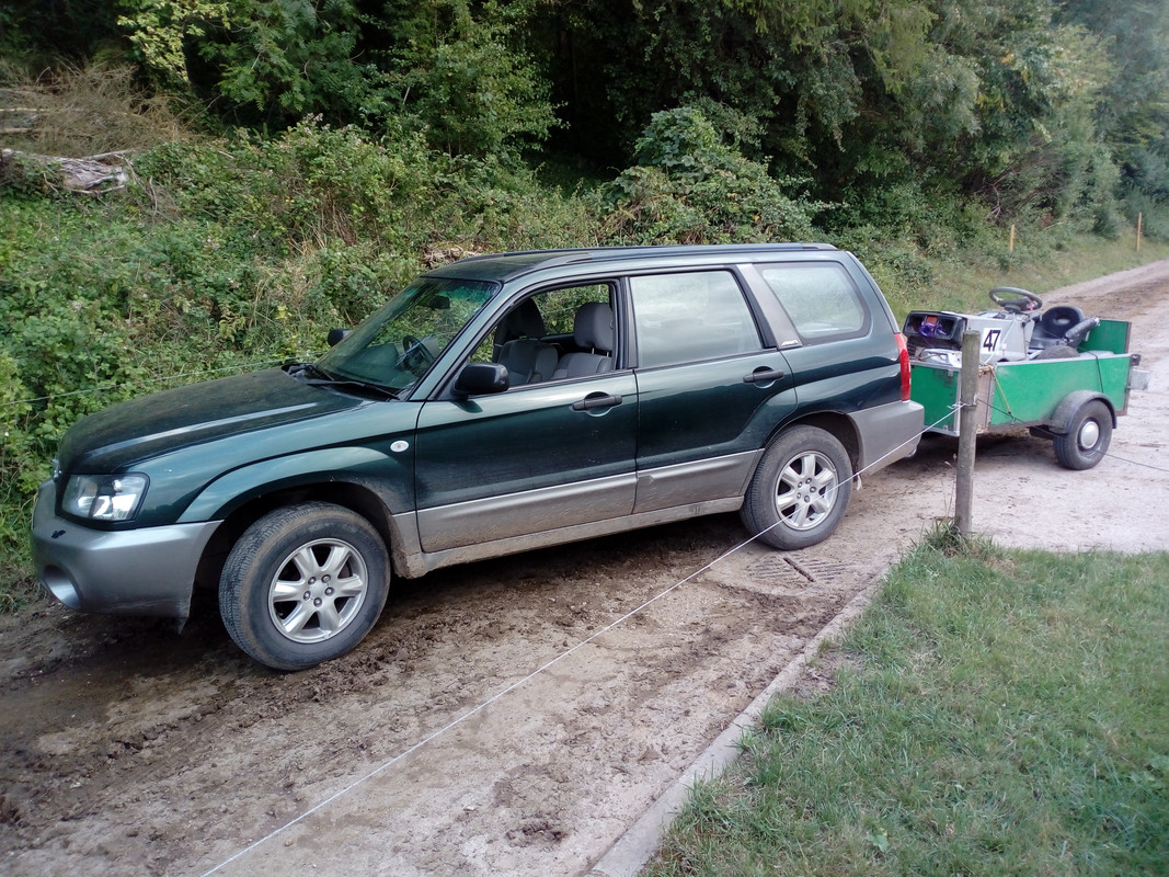

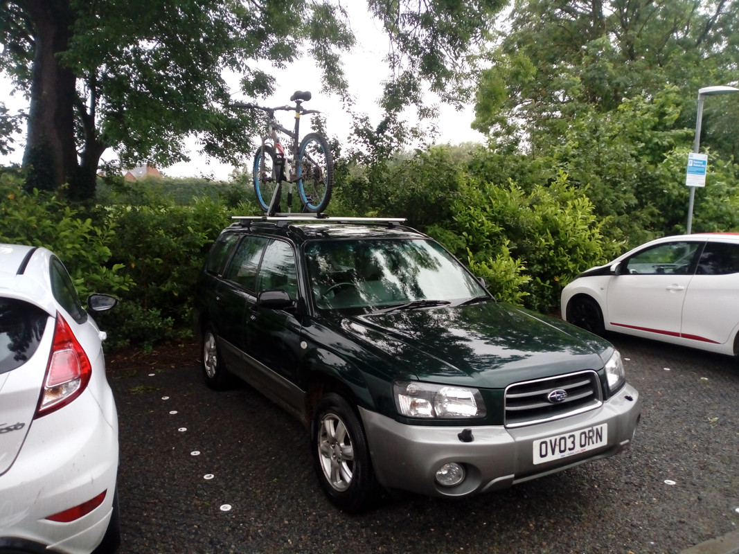

Hi All,
Thought it was time I got a thread going for my car, for all the odd little jobs I do that don't warrant seperate posts. Just to generally document what I do as time goes on. So I bought my 2003 Forester in April last year. It is a 2.0 non turbo that cost me under £1500 to buy, and got an MOT just before I bought it. Had a few jobs to do since, and tinkering here and there. I should say I am a uni student studying Off Highway Automotive Engineering, and this is my first car! So not got the greatest budget at the moment, but I plan on looking after this car and hopefully it will last a while. I hope it will get a few nice parts through the next year as I will be on a placement year working at Prodrive!! Further in the future it may even end up with a different heart when funds allow.
