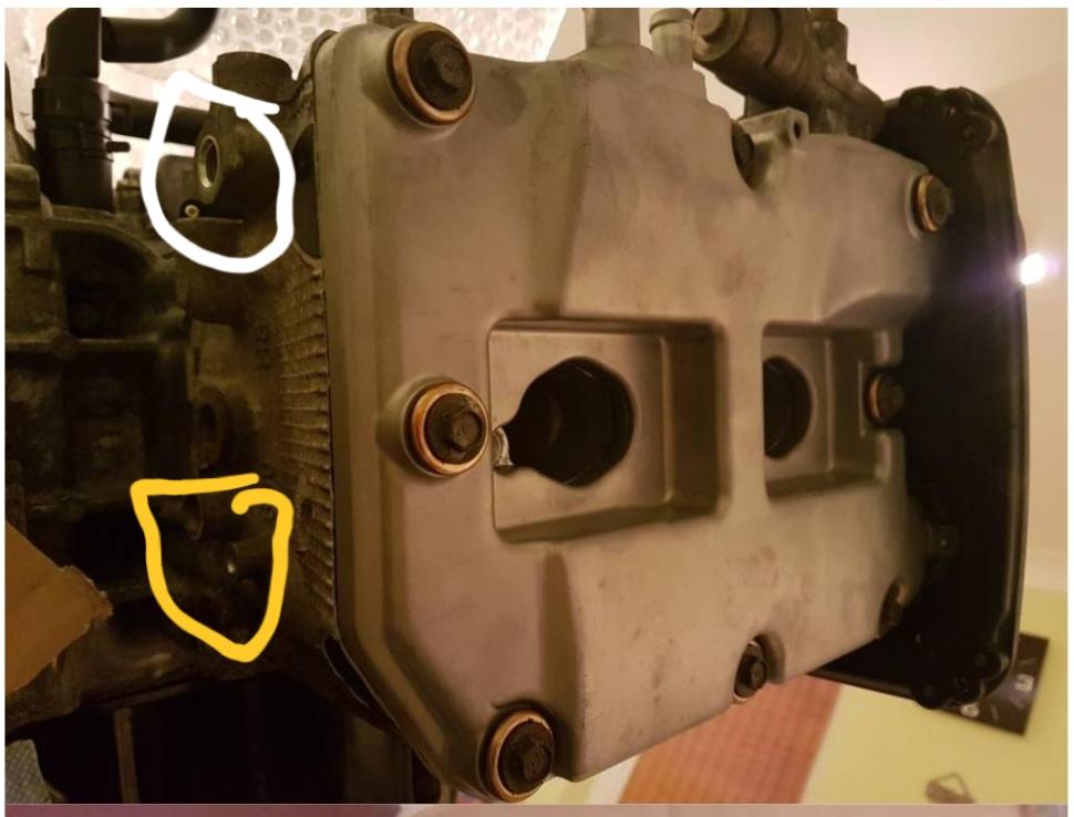

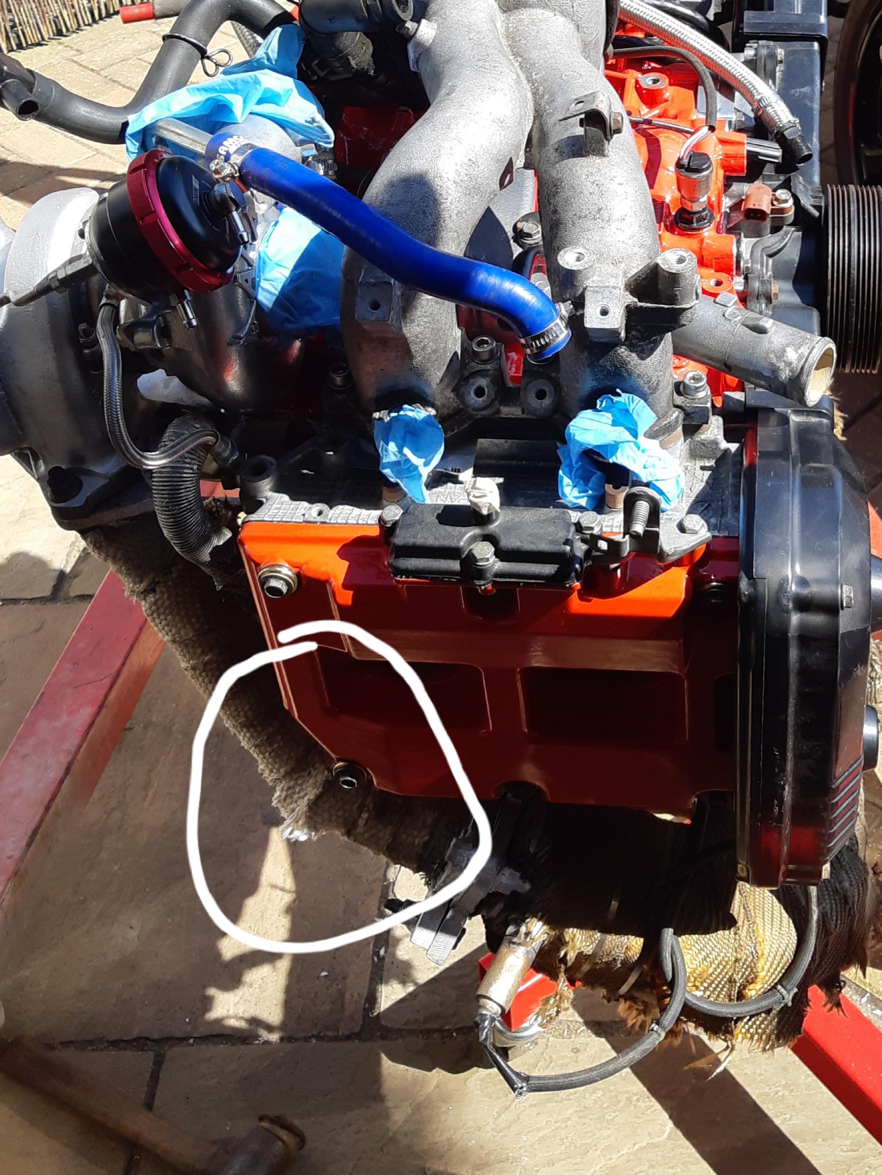

This is on a ej207 I built but the oil feed to the turbo connects to the white circle.
Then goes through the turbo , drains down a rubber pipe (bottom centre of the turbo) and into a hard pipe that returns the oil into the engine where the yellow "circle " (excuse my sausage finger circle drawing ) 😂
The turbo drain pipe is probably best seen from underneath and is held to the turbo oil drain take off and oil drain return hard pipe by spring clips .

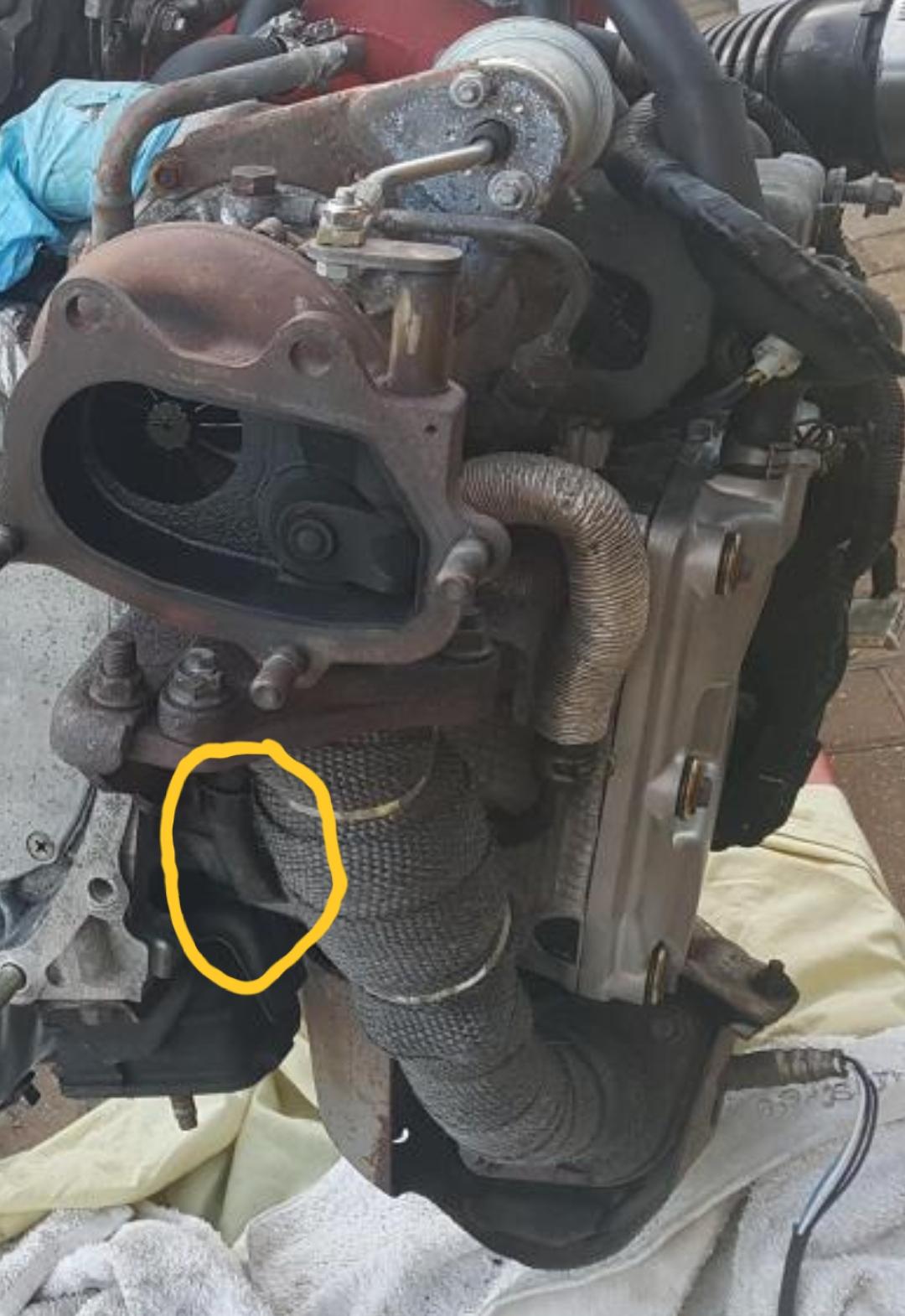

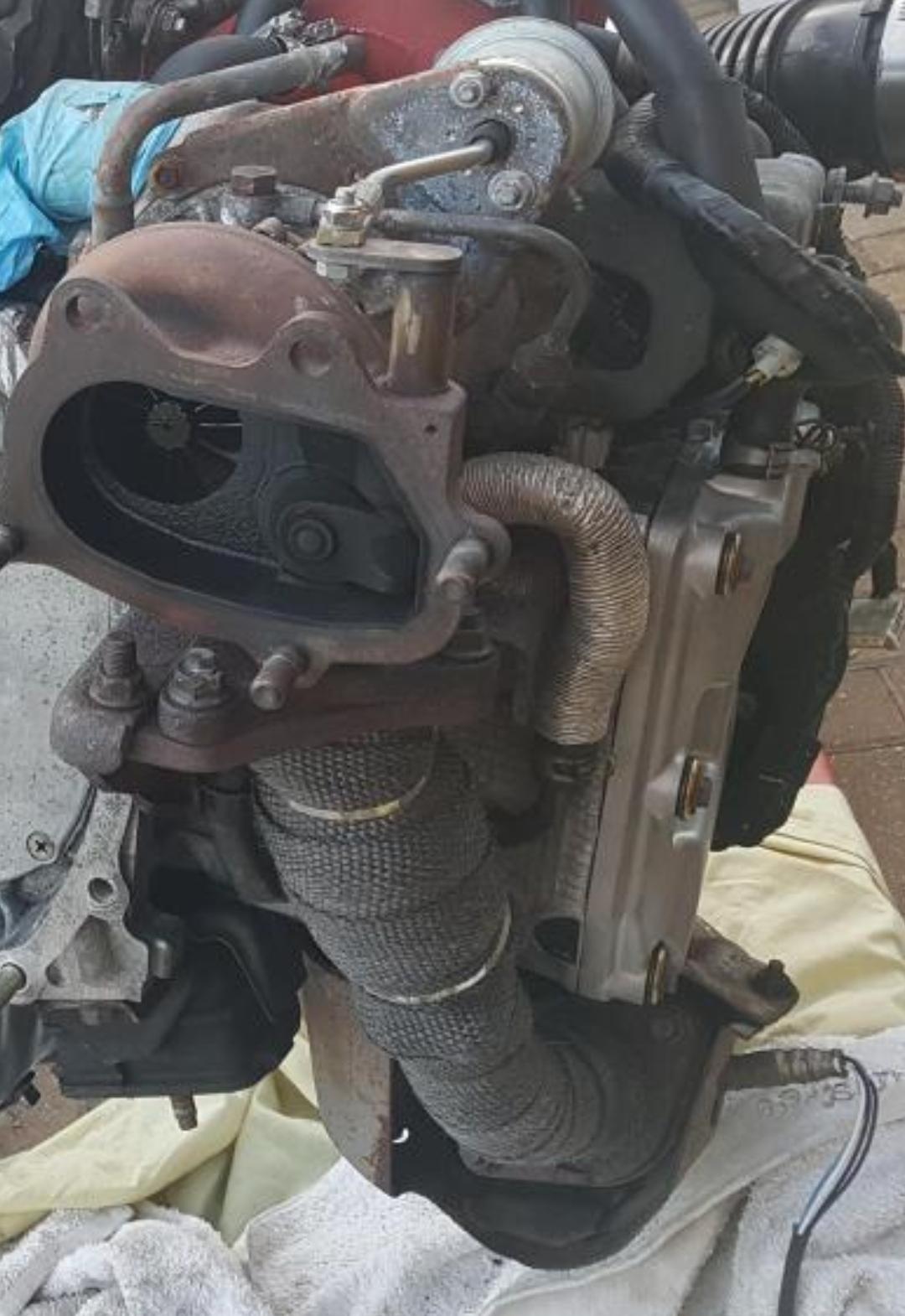

Gonna get it taken home an see if it's not a spark plug I havent tightened properly a few month ago🤦‍♂️. This seems like it's a completely different problem to the mystery turbo smoke, but thanks for the tips savage, that makes sense it being an external leak, one thing I did notice even after just idling the only odour this light smoke has is that heat smell, I just realised aswell the engine in the first pic you sent has a different turbo layout to mine  I'll try an attach a pic

It doesnt have a different layout I'm an idiot🤦‍♂️
My old bug sti ej207 might look a bit different due to the tgv delete and avcs oil feed but essentially all turbo impreza from 92 to late 04 (twin scroll) are a very similar set up bud .
Heres a pic of that area with the turbo fitted .530742458_Screenshot_20200621-111157_SamsungInternet.thumb.jpg.9b41ffb56955408ab95b1233dd6a45c2.jpg
The pipe with the heat shield fitted is the coolant return the oil return is the other pipe in that area but it's more central as it leaves the turbo drain pipe and attaches to the block on the lower left 😉
