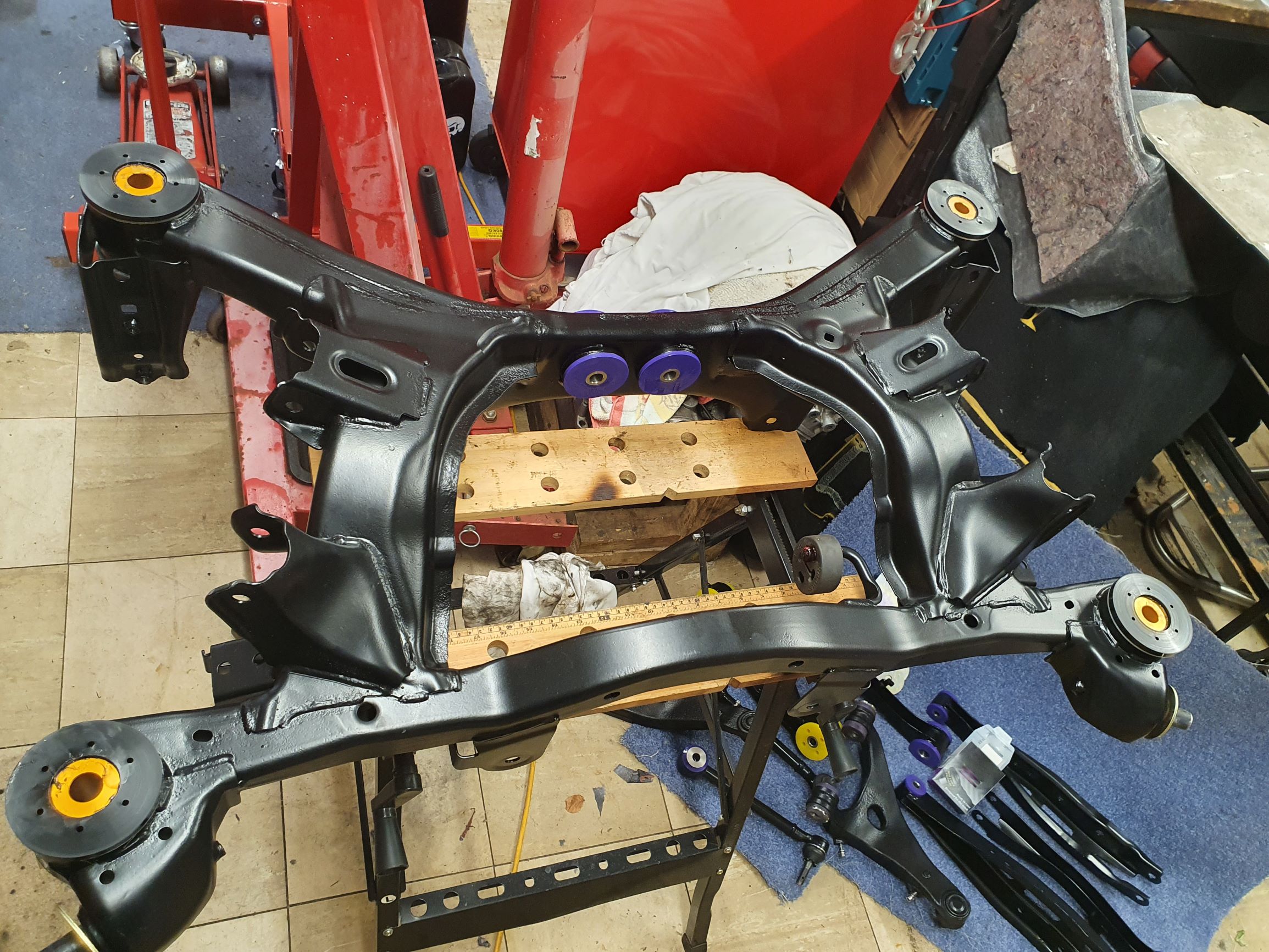

thanx Pete B and Mr B, I have trawled the web , looked at ICP etc for the last week and I have bought the only one I could find, which is the one on eBay which you have shown. Collected it yesterday, lots of surface rust and looked **** but spent the day with angry grinder, power file etc etc and it's all solid. Which is great.
So hopefully by the end of the week my SF will be MOT'd and back on the road.

Looking good 👍
Where did you get your bushings from ? I need a set of front wishbone bushes for fossy, may as well do the whole car over Xmas.

I used Larkspeed up Leeds way for most of it and ordered the whiteline stuff direct from their site as there was a discount code I could use at the time. Cannot rate Larkspeed service enough as the powerflex and superpro sites were not clear on the part numbers for my model, some bushes that arrived were for a BRZ. Larkspeed owned the issue spent the time on the phone with the suppliers and sourced the correct parts.
