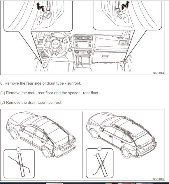

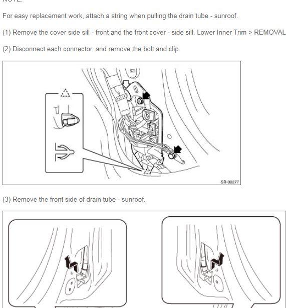

If it helps or is of interest, this is where the drain tubes exit on a Legacy, may be similar.

The drains on the Legacy are here but I think you may have to remove the headlining to reach them. May be worth having a poke round with a bit of stiff wire.
