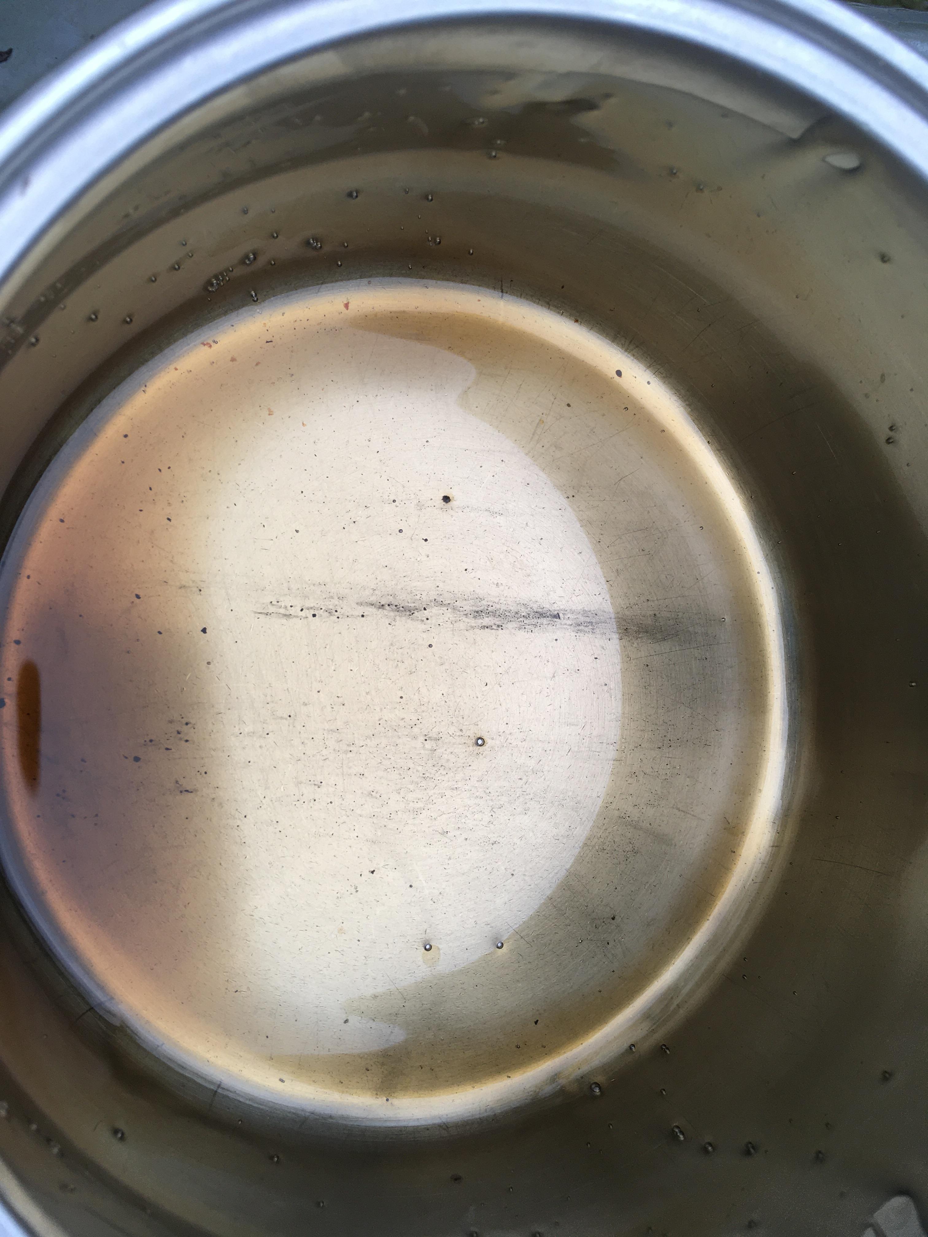

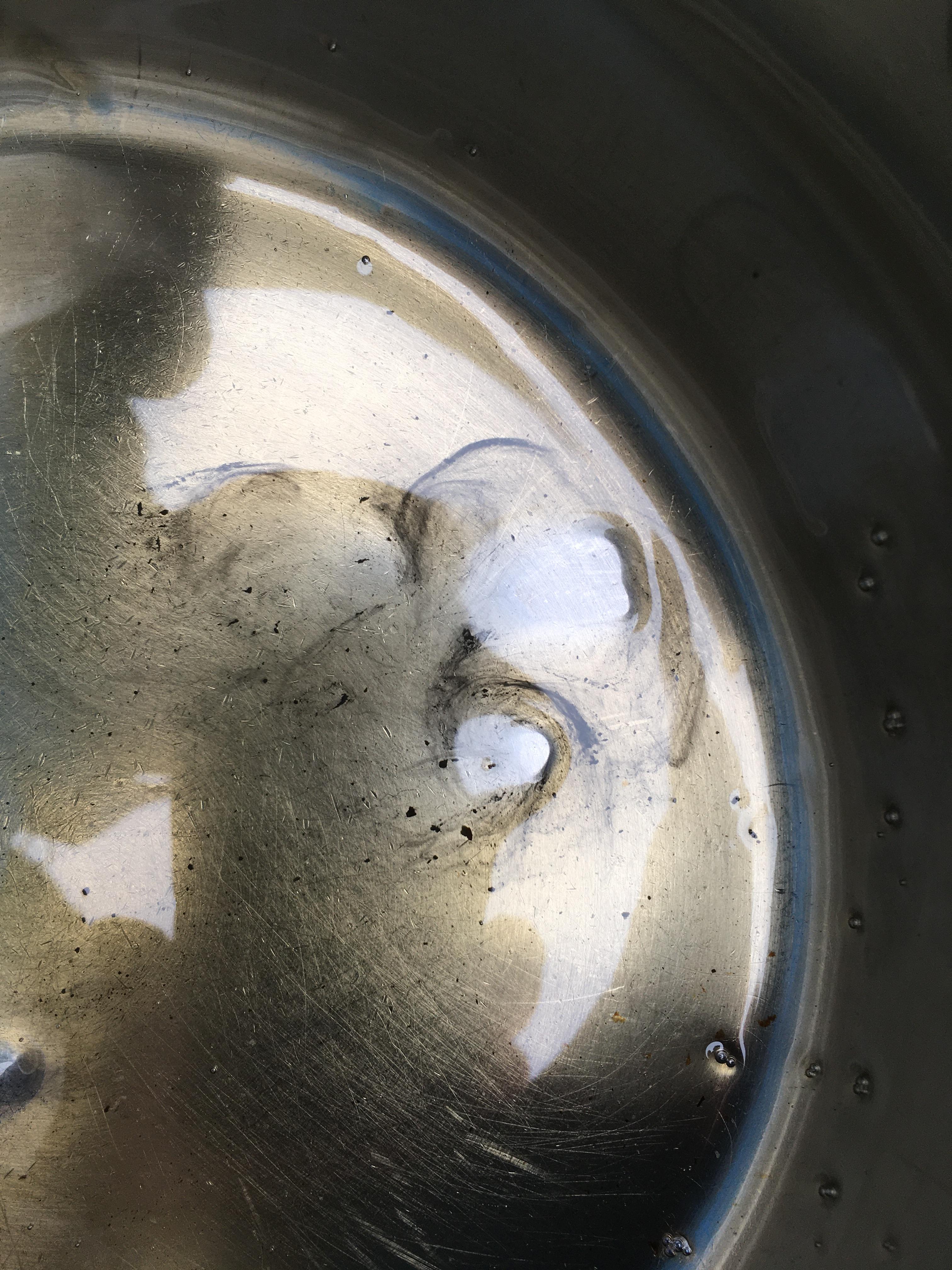

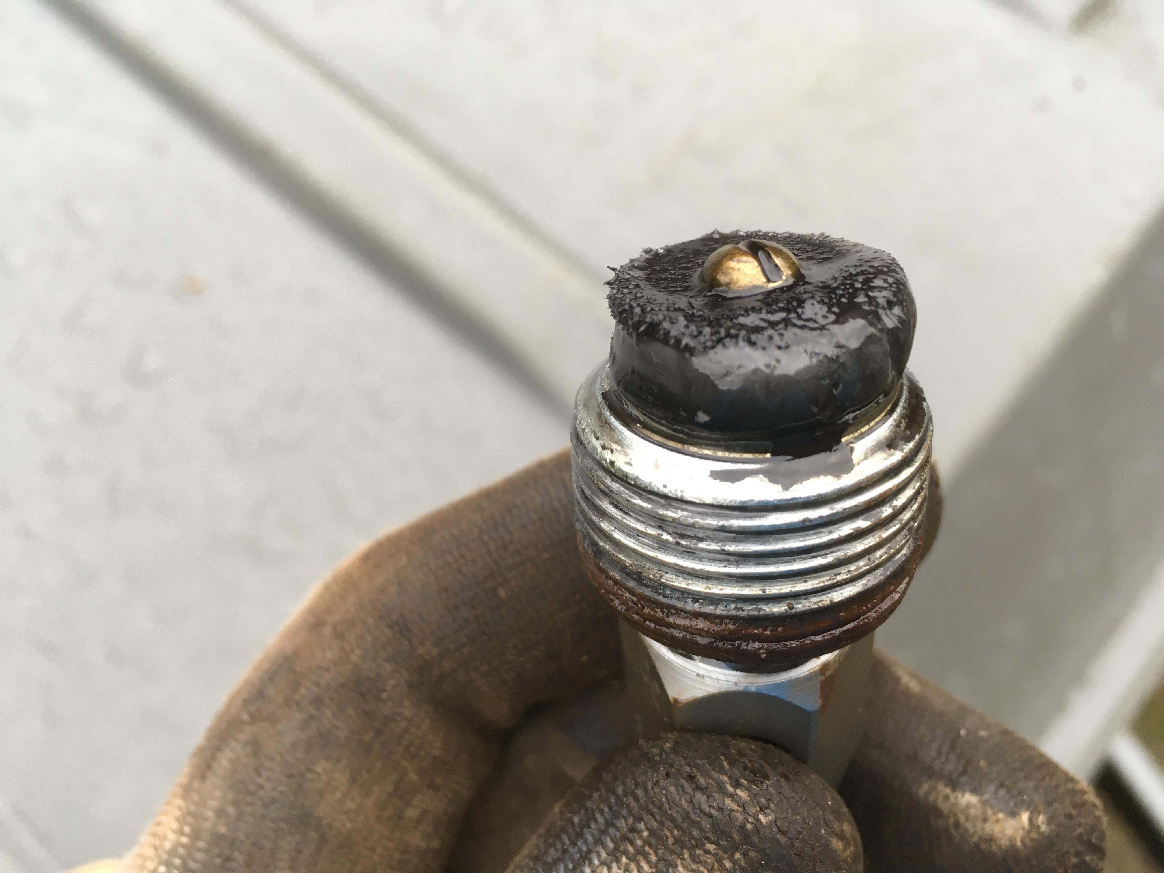

( I have changed the rear diff oil and it looked it decent condition, colour of golden syrup, no "glitter" in it, just a slight coating of grey sludge adhering to the magnetic filler plug. Any "bits" in the oil dissolved into grey smears when pressed and didn't seem to be bits of gears. So I'm hoping that the rear diff is not the culprit. I've also just fitted 4 new Michelin Climate Control+ 2 tyres and the noise is still there, so probably not rear diff "wind up". )

Diff swarf looks normal ...
