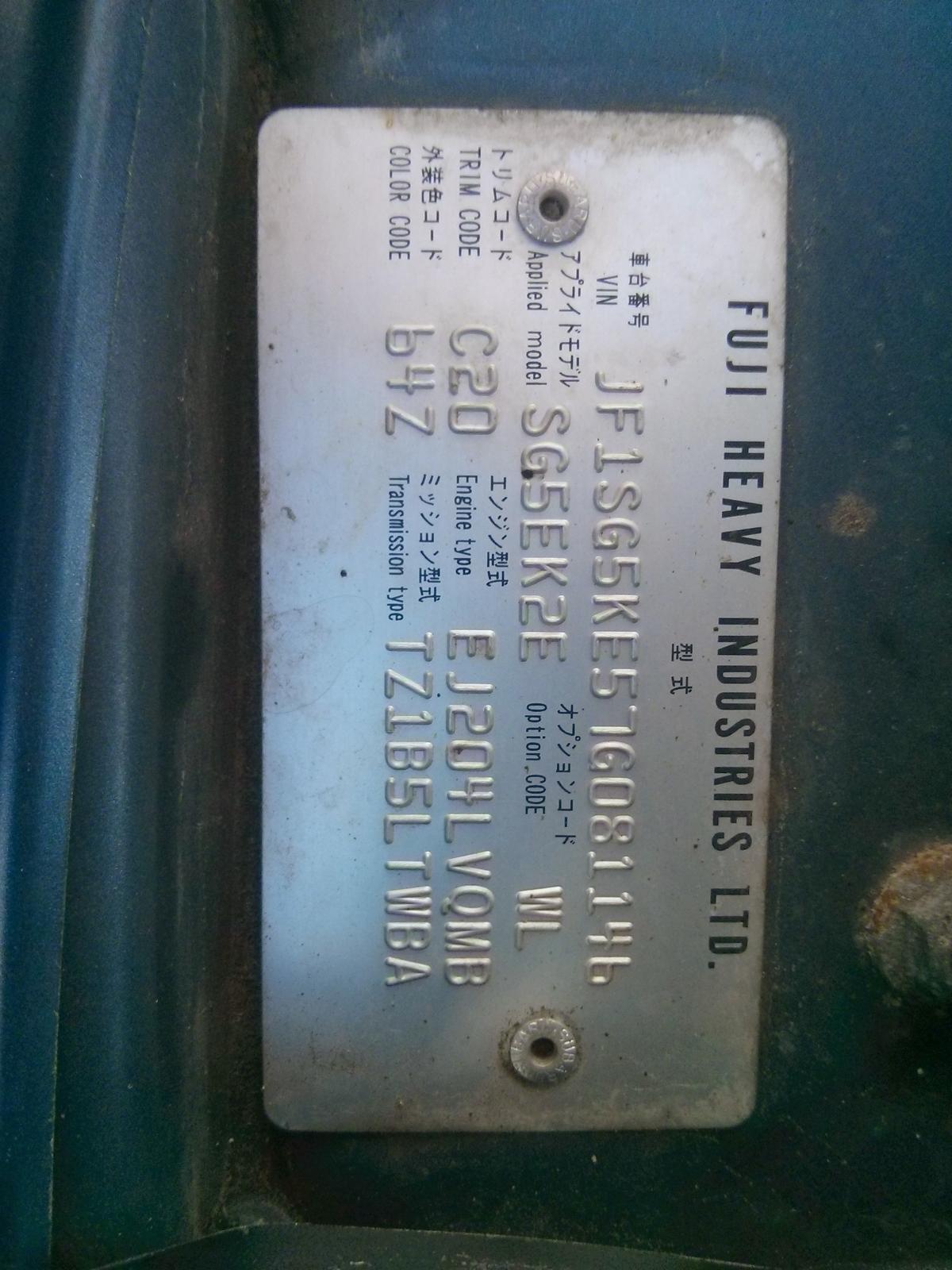

If you can find out wha the options code is i'll dof my cap to you sir !
Been hunting for ages there seems to be many conflicting vews i didn't even see the trim code until i look just now.
I guess i depends on where you cars from.
Neither of those links work for me as my vin is only 9 digits long (jdm spec vin ? )
Mine must translate as
Manufacture.Subaru.
Body type. forester
Engine 5 ? 2.0L 5 speed ?
Then the serial number of the car.
If the trim levels and what bot are in the vin (uk) why have a trim & option code stamped elsewhere ?
Yep it's extras like satnav and so on. And as for finding out the codes meanings for trim. It's like some top secret info. that only the elite must know :D
