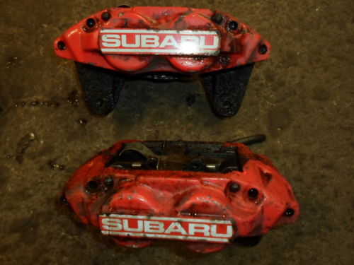

Well with any luck this saga is over *crosses fingers* got the caliper off, then the disc was stuck so had to use a bolt to free it up, gave the hub a clean and put the new discs, pads and calipers on, forgot to take a photo with the wheel off but took some after a quick wash. And with a camera not a phone so quality is good :)
and this is what the passenger side caliper looks like, bit mucky and horrible and not the best photo as the light in my basement is a bit ****. But you get the general idea
them calipers look OK on.
