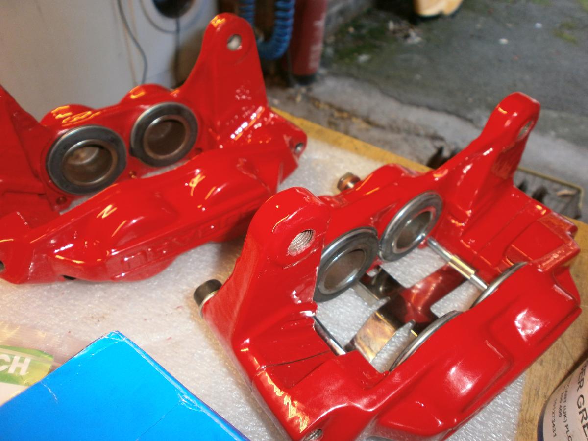

 and the photos of the old 4 pots is to be expected ive had some worse than them but after a session in my blaster and powder-coated and lacquered they look a million times better it just takes a little time and effort on my part to get them looking like this   ( post-1114-0-93638100-1393006031_thumb.jp)
Well when you look at them old ones and those newer ones they look spot on :D
