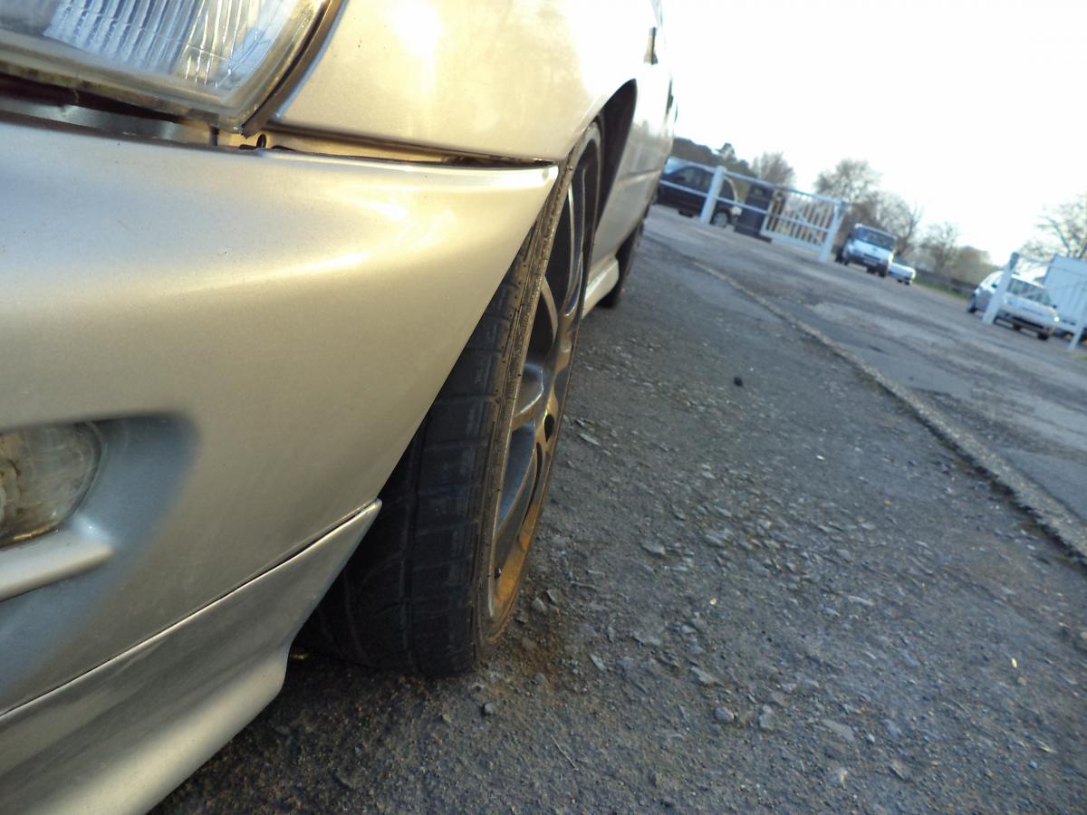

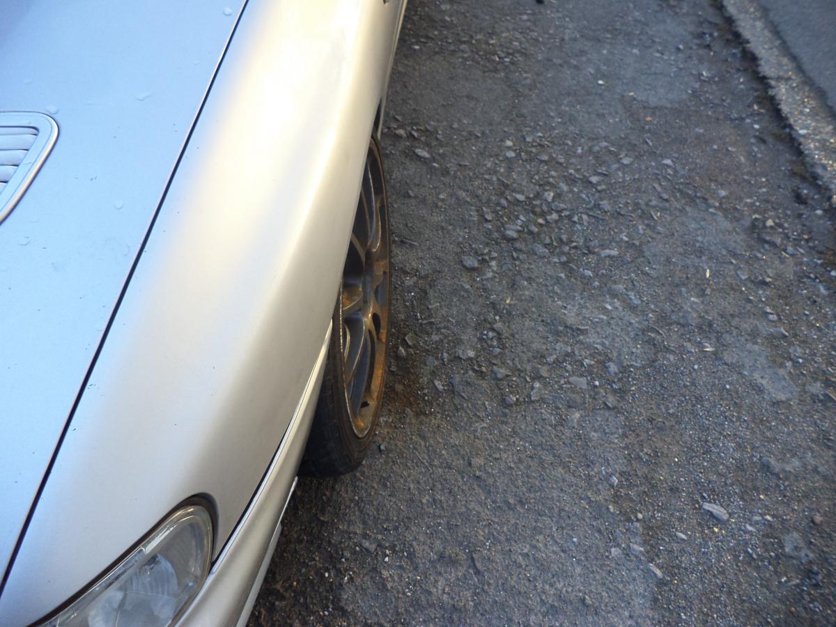

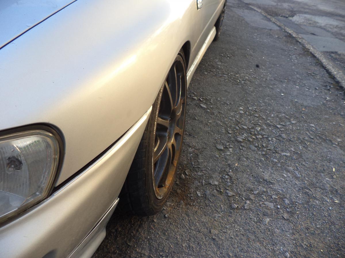

maxim Posted March 25, 2014 Share Posted March 25, 2014 Hi guys.I got jdm 1994 wrx. I was driving without front disc pads for 2 weeks short distances to work and back(hadnt time to fix it). Caliper was slightly sometimes touching break disc when i was turning steering wheel mostly. Yesterday i ve done few 5 sec 0-60 pulls with my friends and after that front left disc got almost seized by caliper (it stuck in 1 position constantly touching disc making nasty noise and slowing a bit car down) i decided to drive back home slowly but after 1 mile i had a trouble. See picture.. Car is not moving anymore but i can go through the gears 1st 2nd 3rd ! 3 healthy wheels dont move but something keeps spinning with noise in damaged wheel area. Is it normal or something else damaged (diff??)why only 1 damaged wheel tries to spin and the rest 3 stay? Please have a look on the picture what can be damaged(actually wheel angle more than on the picture after recovery wheel stay quite straight). I live in london. Any one knows call out mechanic who can have a quick look.Or subaru garage ? Any ideas? 1 Link to comment Share on other sites More sharing options...
Tlag Posted March 25, 2014 Share Posted March 25, 2014 I can't believe you have driven without front pads for 2 weeks! That's just unbelievably dangerous for you, your passengers and everyone else on the road. I could rant on here but I won't bother. I'm guessing what you have done is seized a hub due to heat. The amount of energy going through the caliper pistons onto the the disk would cause massive heat, even for short distances. That heat would directly transfer through all the components, so I'm guessing you have seized a hub. The disks will also need renewing. They will be warped and scored all over the place. 1 Link to comment Share on other sites More sharing options...
maxim Posted March 25, 2014 Author Share Posted March 25, 2014 I can't believe you have driven without front pads for 2 weeks! That's just unbelievably dangerous for you, your passengers and everyone else on the road. I could rant on here but I won't bother. I'm guessing what you have done is seized a hub due to heat. The amount of energy going through the caliper pistons onto the the disk would cause massive heat, even for short distances. That heat would directly transfer through all the components, so I'm guessing you have seized a hub. The disks will also need renewing. They will be warped and scored all over the place. Thanks Link to comment Share on other sites More sharing options...

Jay762 Posted March 25, 2014 Share Posted March 25, 2014 I share the others concerns about you driving with no pads - not clever. Did you have the car towed back, were the front two wheels locked onto a tow device, if so that may have damaged the transmission. Other than that it does sound like you have damaged the hub Link to comment Share on other sites More sharing options...
maxim Posted March 25, 2014 Author Share Posted March 25, 2014 I share the others concerns about you driving with no pads - not clever. Did you have the car towed back, were the front two wheels locked onto a tow device, if so that may have damaged the transmission. Other than that it does sound like you have damaged the hub. No No i didnt tow it that wouldnt be clever. It has been recovered by truck. Link to comment Share on other sites More sharing options...
