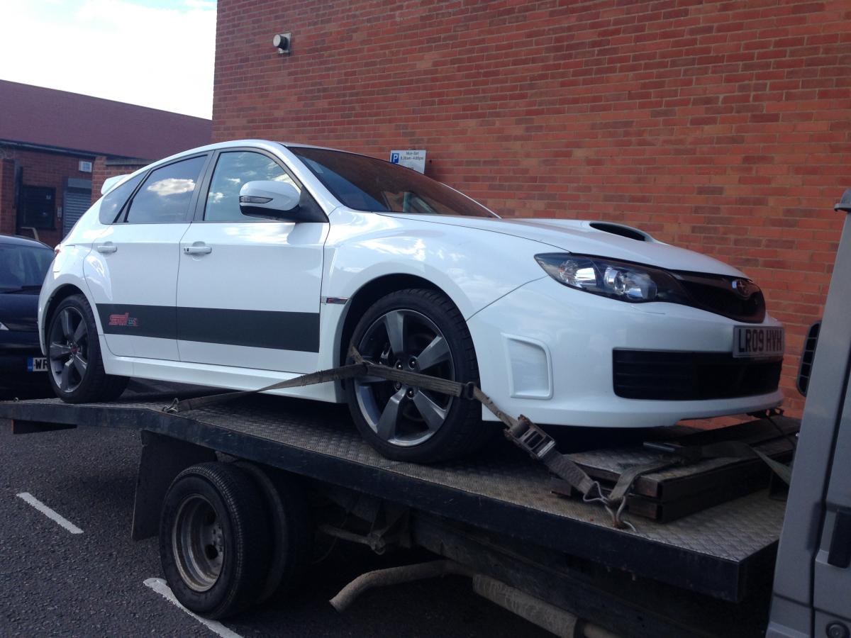

Car as it is now :-(

Seen that car before with that side stripe :-D

Can I used your car pic and put it on ScoobyNet?
