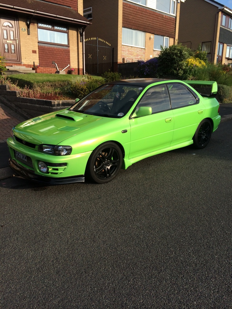

Just a quick message to say hi after buying myself my new toy (impreza wrx).
It's had quite a few mods done and I will be looking at doing the occasional trackday with it so any advice or pointers would be great.
