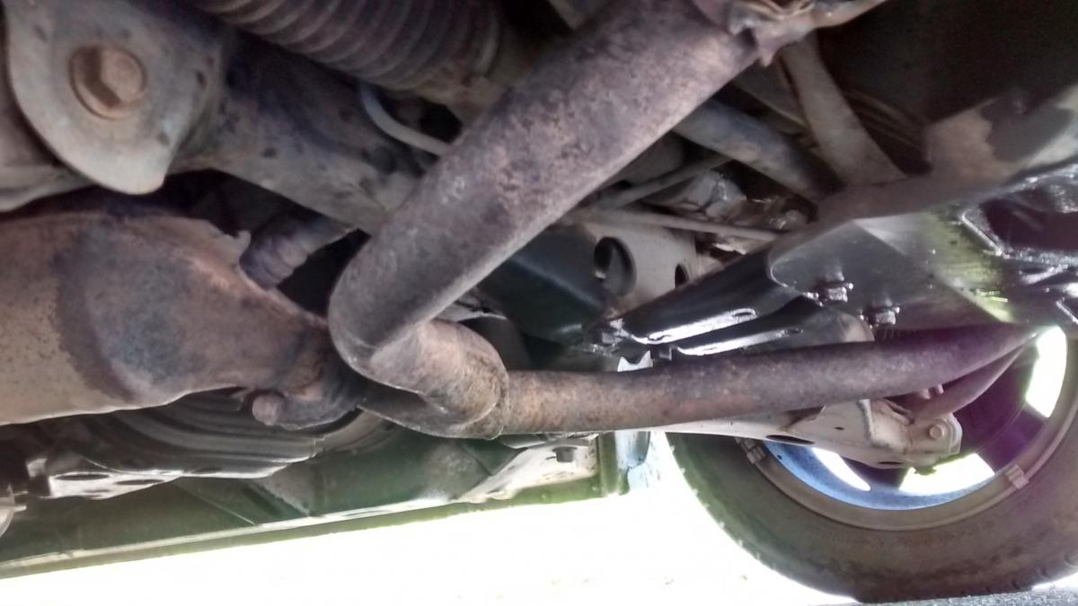

I don't think the unequal one would fit as it goes around the front of the car then pokes out around the o/s wheel. I'll post a pic up of what I mean in a bit.
Whats above the brace on the right of the pic ?

There's a heatsheild on the bit that runs along the front and thats in three bits where as the stainless one isnt. And the up pipe is missing but as sav says that will be on the left of the pic.
Youra looks like the cat would need replacing as it's at an angle where as the turbo cars is more of a straight route.

If you could get a better pic of the front underside of your car may be easier to see if you could make the unequal length sit there then get somone to fabricate another bit to connect the headders to the cat ?
Maybe send tlag a message on here he has more knowledge on legacies than I
Haha too much sun and ouzo = bad news, took me ages to write the last post. U can't fathom out which way round I should be looking at the eBay pic. The more I look at it it looks like it should but icant work out the angled bit to the cat. Has it been reversed in the image ?
