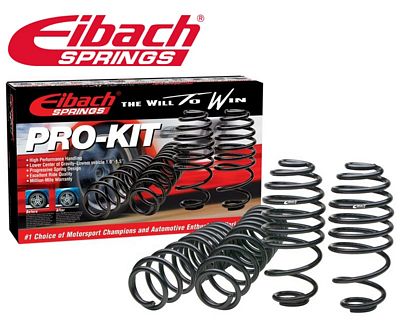

There's also Eibach, Bilstien, Koni plus quite a few others all depends on budget.

It depends on what set up you are looking for. If it just looks over adjustability I would save some cash and just lower it by changing the springs to Eibach or H&R.
