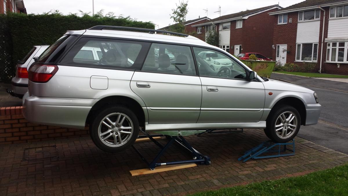

I needed a new exhaust so I bought one from my local car spares place and a small car lifter to aid access.

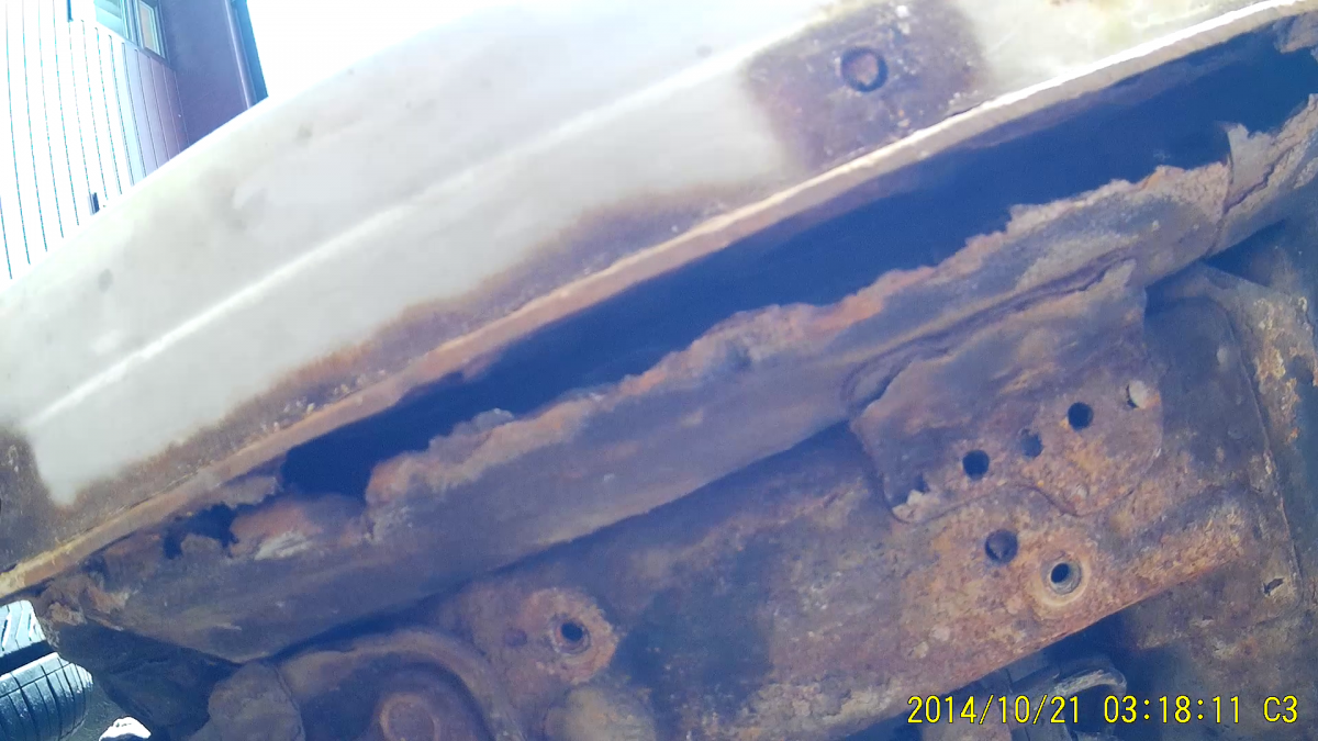

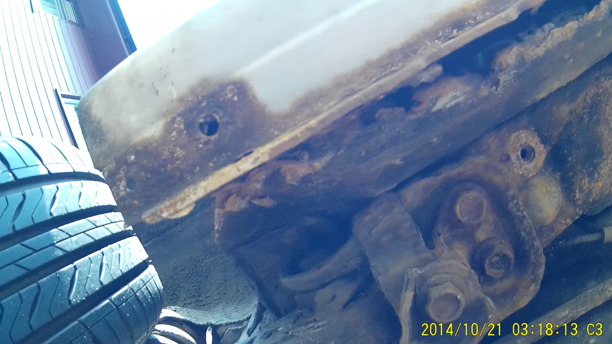

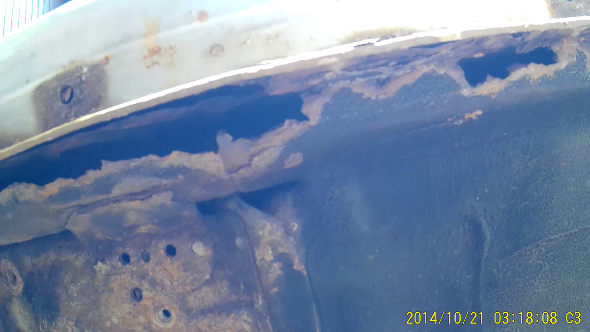

I then noticed a little rust on the inner sill. It goes from the rear of the jacking point to just behind the drivers door.
post-3336-0-92751000-1415542147_thumb.pn
post-3336-0-53457000-1415543161_thumb.pn
post-3336-0-82966500-1415543193_thumb.pn
Just wondering if it is worth repairing? and is it safe to drive?
It's a 2003 legacy estate 2.5 gx auto with 80k on the clock.
I haven't fitted the exhaust yet as it may not be worth it. :(
Thanks in advance
Wotcha and welcome - the photos may be deceptive but it looks to me like you will need a bit of plate as well as some welding rods - is it worth it - up to you what condition is the rest of the car in if it is all solid with good running gear then why not get it sorted??
The rest of the car is solid enough. MOT till August 2015. If it was just a bit of plating I would do it, problem is there is a plate inside the box section with big holes stamped in it which is also rotten where it attaches to the sill. Even the jacking point is none existent.
Have aword with a local body shop, get some quotes and mull it over, it seems like a lot of timworm for a 11 year old car, have the drain holes in the sills been blocked causing a build up of water rotting it from the inside out ?
Didn't check the drain holes, but it would make sense. I got rid of my landrover cos I was fed up of welding it for every mot, and with the scooby's 10 year anti corosion warranty I figured it should be good for a while yet.
Suppose it depends on where it's spent nost of its life, how long have you owned the car ?
For that amount of rust it looks like it's taken hold a long time ago, can't beleive the m.o.t didn't flag up at least an advisory
I've had it about 3 years. I think it belonged to a building firm, it had a private plate (changed before I bought it) and 56k on the clock. The car has been well undersealed so you can't see much, especially if it's from the inside out. It had an excellent service history, cam/timing belt changed at 6 years, subaru service history etc. I would do the work myself if I could get enough ground clearence and somewhere to do it.
is unusual for subarus of that era to rust heavily, possibly previous use such as mucky building sites or salt water environment has played some role in it.
Looks mainly the inner sill but do check how solid it is where joins into inner arch panel & where feed off towards trailing links & subfame mount areas.
I personally would give whole vehicle good inspection for rust & if nothing much else found then doing just this area yourself would be cheap & could give good 2-3 years before further work required.
Not much you can do inside the sills easily & normal procedure is good effort on outer panels along with good sealing & waxing inner sills to help slow down corrosion.
after welding I normally spray on zinc primer followed by black PU40 adhesive applied as a seam sealer & filler to tidy the area up & give very long lasting protection, once that dry a coat of underseal as normal.
Points above on drainage are very valid & also when waxing sills don't go to heavy on application as tends sag into pools blocking drain routes & holes.
You should be able make some wood block stepped ramps easy enough to lift vehicle, if need wheel off a decent trolley jack & axle stands would be needed to get suitable & safe lift.
No idea how last MOT missed the corrosion !
  • Like 2
My quotes came in at around £600 to £700, If you add in the £500 for the exhaust which I bought (but have not fitted yet) the car is not worth much more. It was suggested that if I could weld I could do it myself. Having spent all weekend cutting and welding it is almost completed and looking ok.
The question is how structural are the sills? I am happy that they are not going to fall off but not so sure if my welding is strong enough to take the weight of a major part of the structure.

Thanks for the tip re the stepped wooden blocks. It took 11 14 inch long (35 ish cm for you youngsters) x 3 inch thick blocks and a new pair of underpants when I nearly drove off a 3 block stack. There's not much fine control in the auto box.
lol :-D indeed auto is not good at that.
On your question of sill strength, they are indeed quite a main part of body structure. If your welding is half decent & internal structure not too heavily corroded then they probably still suitably rigid enough.
I'm not a fan of rust nor spending much money on repairs of corrosion.
As you done it yourself it was a cost effective option, just keep an eye on it & give inspection for corrosion annually before MOTs & see how it goes, you may find rot spreads quickly (18 months/2 yrs) aound joins of new patches or spreads out to suspension mounting areas on the rear. If corrosion progress is very slow you may see 4/5 yrs before major issue again.
Main thing is keep cars running costs/options in line with this & not heavily invest in it in other areas.
Don't inject too much waxoil into sills as it tends cause water trap areas & block water drainage. also it is a PITA to weld again in future when they over full of oil. sensible misting with decent waxoil gun is recommended though. external application around suspension trailing link area & subframe & Mount area is recommended too.
Lots of good advice to digest. I decided to cut a section from the outer sill to gain access to the inner sill.
This is not my car. I just pinched the picture from a website as an example.
See profile pic as it won't let me put it here.
The outer sill was fine so i cut along the back where the rust was and where it joins the floor pan (I'm not a mechanic so excuse if the terminology is incorrect). I then cut across the top as in the above pic and down the sides to remove that section. The inner sill looked remarkably similar to the picture. I drilled out the spot welds on the bottom lip of the sill and removed all the remnants of the old inner sill and floor pan. I treated all the rust with a good dose of rust remover and welded a new piece to the inner sill down to where it should have been. After spraying the inner sill with a few coats of zinc primer I welded the outer sill back on and redid the spot welds to the new metal. I'm now in the process of plating over the floor pan before seem welding it along the bottom of the outer sill and spraying more zinc primer and waxoil.
