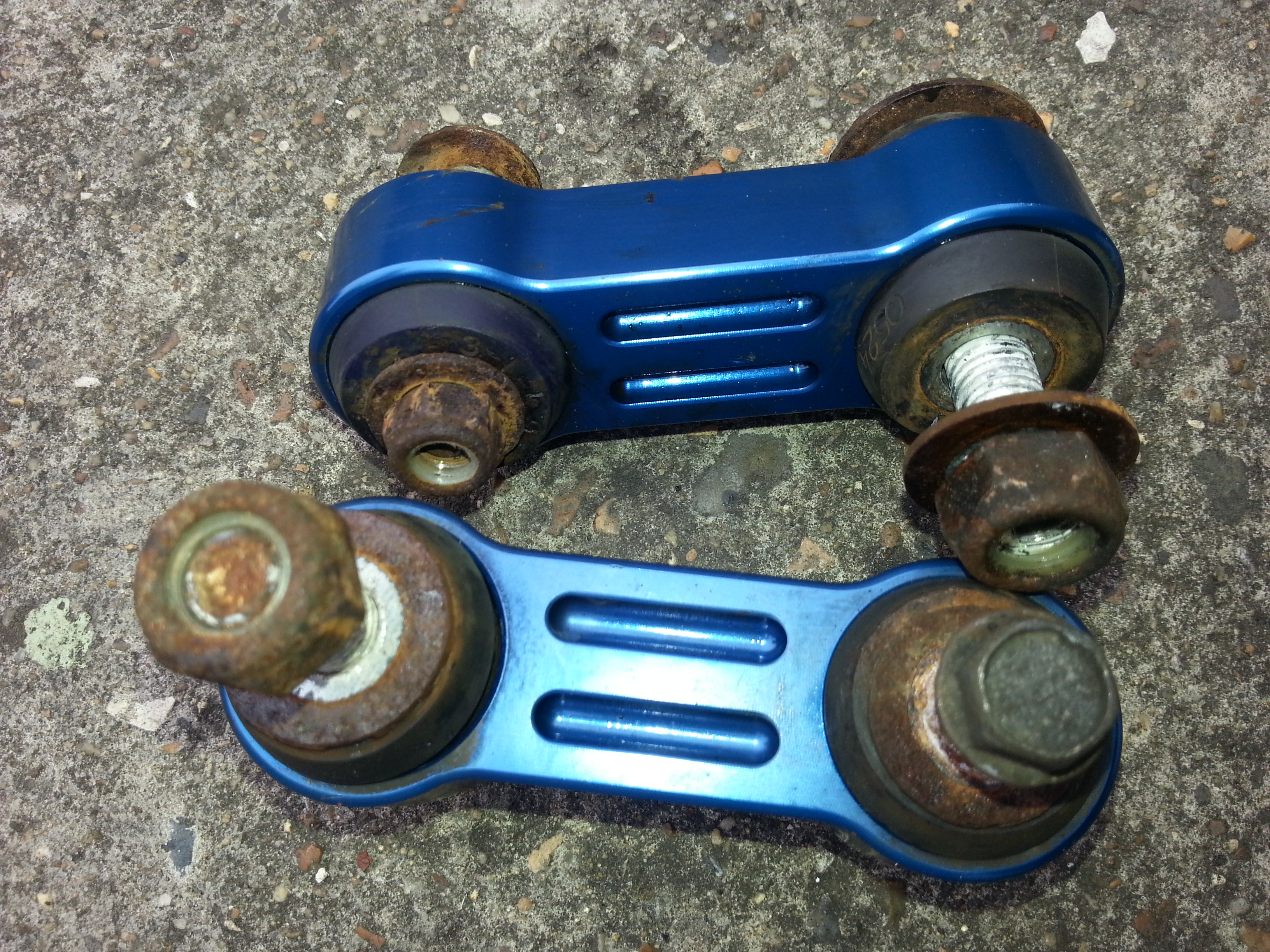

I have got 2 sets of aftermarket front droplinks but they're off my classic so don't know if the fronts are the same on the foz
If they are the straight chunky ones then they are the same, I was more worried about the rear bar mounts to the chassis, maybe its just a marketing thing but whitleine want to sell me a kit to attach the bar to the car.
Send us a pic of the droplinks when you have time and I'll let you know
