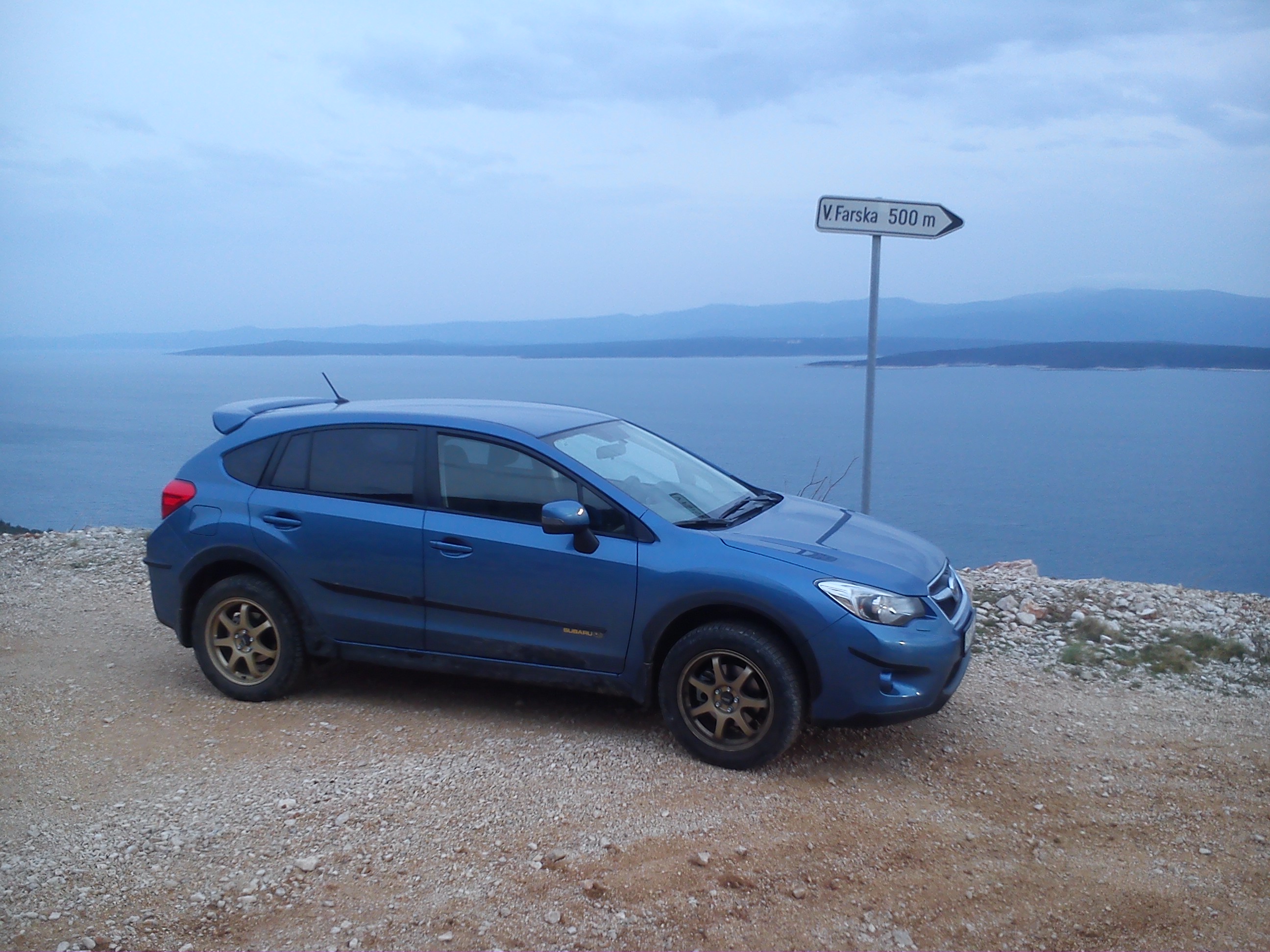

Hello,
Looking for spare wheel for my XV to fit in the space below boot floor without loosing any boot space.
Found out that spare wheel from some versions of WV Golf Mk4 is quite close by dimensions 125/70-18, 5x100.
Any experiance/advice is it possible to use it?
Thanks in advance.
Regards.
