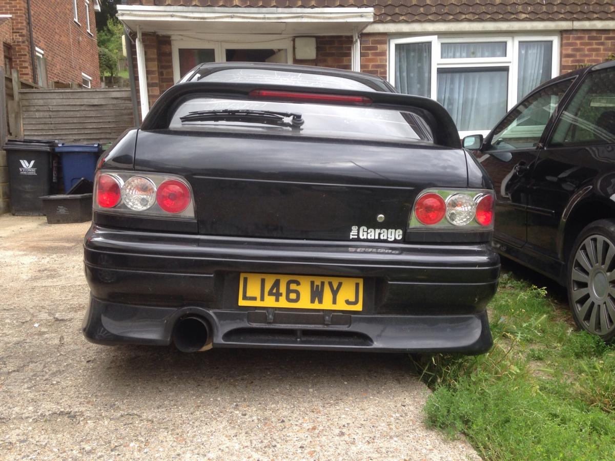

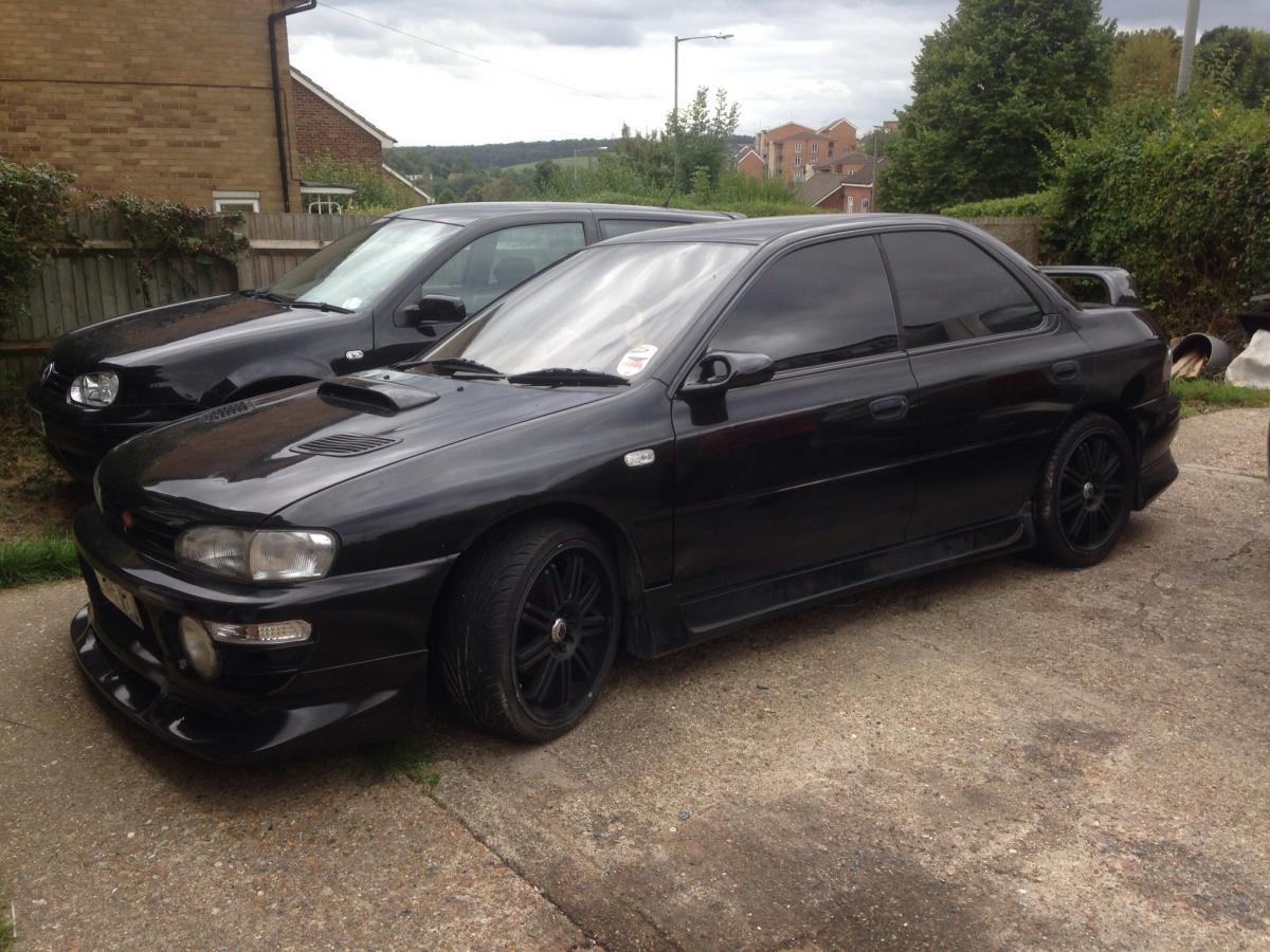

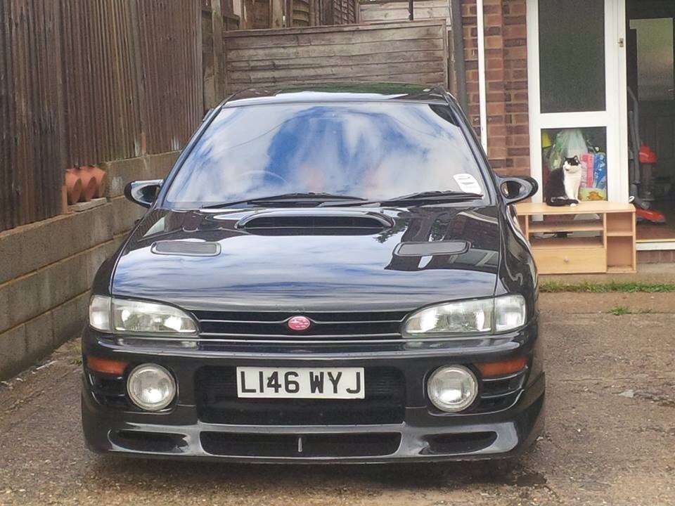

Lose the fast a furious kit! Go down to 17 inc wheels and maybe paint white
Also want more power but don't know what's best on these yet, so I'm hoping to get some ideas from this site.
My old cossie was around 400bhp so looking to get the same from this
Hi and welcome to soc fella
Looks like a nice clean one so good base to start from , what model is it ?
I'm not personally keen on the body kit either but I do like a oe look with just a splitter.
Power wise 330hp is about right for classic standard internals , brakes and drivetrain .
Expect to pay at least £3k just in parts to make a classic break the 400hp barrier .
330hp in a lightweight classic ain't no slouch anyways [emoji6]
Savage is by far the best man to speak with :) Sorry Savage nominated you :D Side Skirts I could live with but I guess up close and in the flesh might not look good. But I agree with keeping a splitter P1 style splitters look the nuts in my opinion on classics. I've had wing mirrors like them too very hard to see out of :(

Thanks people, it's a wrx model with a decat on it all ready, not really had a chance to play about with it yet due to the weather etc but hoping next weekend I can start to make my mark on it, I'm not overly keen on the wheels either, I want more of a Motorsport feel to it
Depends should have it printed on the back of the wheel, not sure about the sti foz but all the other ones have an offset of 48 where as the impreza has 55. Also the stud pattern may be different, classic use 100 pcd where as my05 is 114pcd
