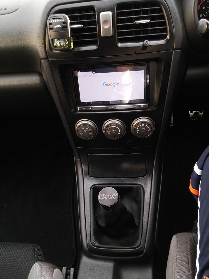

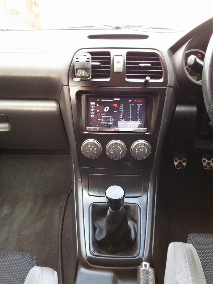

matmidgley Posted December 18, 2016 Report Share Posted December 18, 2016 I did my console but I added the glossifier over the top 1 Quote Link to comment Share on other sites More sharing options...
