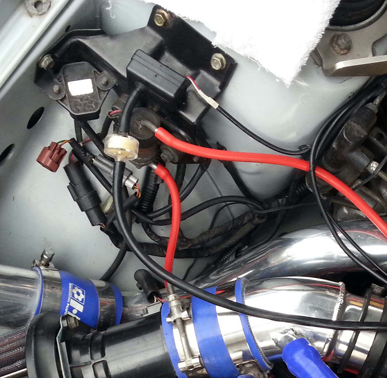

Hi all i have a v2 import sti. I have a fault with the boost
Solinoid the on board diagnostic is showing a fault that there is no
Signal from it ive replaced the solinoid to no avail
The car had a small engine bay fire which fried a couple of wires they have
Since been repaired but just cant get to the bottom of this issue
The car will only boost to 0.5 then it fuel cuts any help would be great or if anybody has the ecu pin out
Thanks tony

Open whichever diagram is for your car and check what the location of the boost solenoid wires are on the pinout !!!
Use a multimeter to check for continuity by putting one probe in the correct pin on multiplug then put other probe at the boost solenoid plug end ,multimeter should beep if ok and repeat for the other wire on solenoid plug too
This should tell you if the wiring from ecu to the solenoid is ok
Also as temporary measure try looping the pipe from the wastegate actuator straight to the nipple in the turbo compressor intake
This will check your turbo is boosting up to wastegate pressure (std boost)
Will also help to eliminate were the problem actually is
