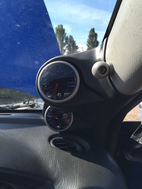

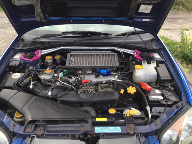

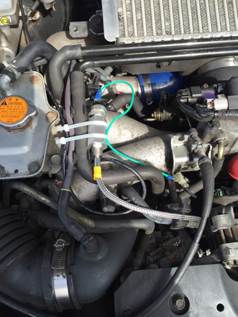

post-4189-143885720611_thumb.jpgpost-4189-143885721747_thumb.jpgpost-4189-143885722795_thumb.jpg
The finished article. Extended the oe sender wire as it was too short and tried to put the t piece out of the way but visible to keep an eye on it. Not the tidiest but was struggling to find place for it!
