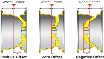

I can't get my head round it either but the offset is how far the wheel protrudes outwards from the centre of the hub, towards the outside of the car, so a larger offset will fill the arch out more, I've a diagram somewhere that makes more sense if I can find it I'll pop up
Offset is the relation between the centre line of the wheel and the point the wheel bolts to the hub. A positive offset will pull the centre line closer to the car so you may have trouble with the wheel contacting the suspension or tyres rubbing the inner arch. Negative offset will push the wheel away from the hub which may stick out of the arch or rub the wing.
There is usually a tolerance for each car and I'm sure I've seen it posted online for subarus. It gives you the highest/lowest offsets the car can take.
Thanks ScoobyGhost for that explanation and the diagrams.
So, the higher the 'offset' number ie 55, the further the centre line of the wheel will be from the face of the hub, (with the risk of the tyre possibly rubbing the inside of the wing),and vice-versa, the lower the offset number ie 48 the nearer the centre of the wheel will be to the hub face (bearing in mind the risk of tyres rubbing suspension legs, inner wing etc)??
