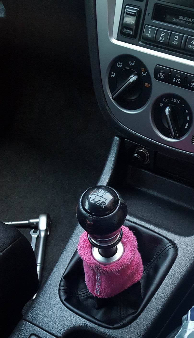

Nevell Posted May 8, 2016 Author Report Share Posted May 8, 2016 1 Quote Link to comment Share on other sites More sharing options...
savage bulldogs Posted May 9, 2016 Report Share Posted May 9, 2016 How are you finding the switch to 6 speed ? Is it a uk ratio or shorter jdm ratio ? If it's not broke .....upgrade it 😊 Quote Link to comment Share on other sites More sharing options...
Nevell Posted May 9, 2016 Author Report Share Posted May 9, 2016 It's a uk ratio mate it's a ty856wn3ca out of a uk 2003 pro drive Sti 😄 Not driven her yet waiting for a new inner cv boot I split and some poly arb bushes but can't wait to see how she fills Quote Link to comment Share on other sites More sharing options...
savage bulldogs Posted May 9, 2016 Report Share Posted May 9, 2016 Think that's the last year they used the male driveshafts on the front ,so they're might be other differences . mine was out of a 04 uk sti with the Prodrive performance package (the Ppp is a bonus as you get a short shift gear linkage) I've found 1 st and 3rd seem to be shorter than my old UK turbos 5 speed set up but I've dropped about 500 rpm @ 70 mph in 6 th [emoji41] If it's not broke .....upgrade it 😊 Quote Link to comment Share on other sites More sharing options...
Nevell Posted May 9, 2016 Author Report Share Posted May 9, 2016 Yeah it has the ap designed suretrac Lsd diff but people didn't like it so they went to a helical type after 03 Quote Link to comment Share on other sites More sharing options...
