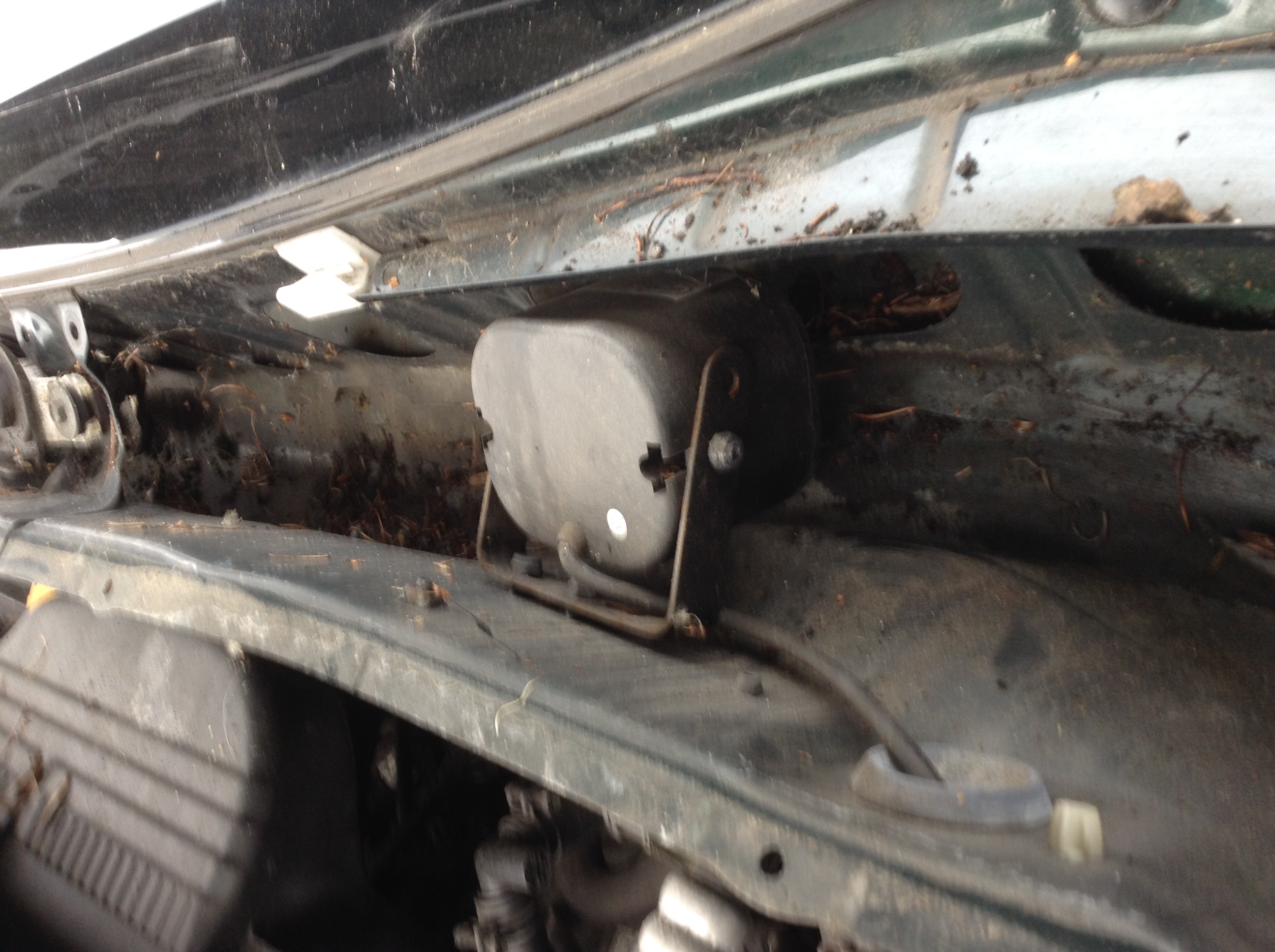

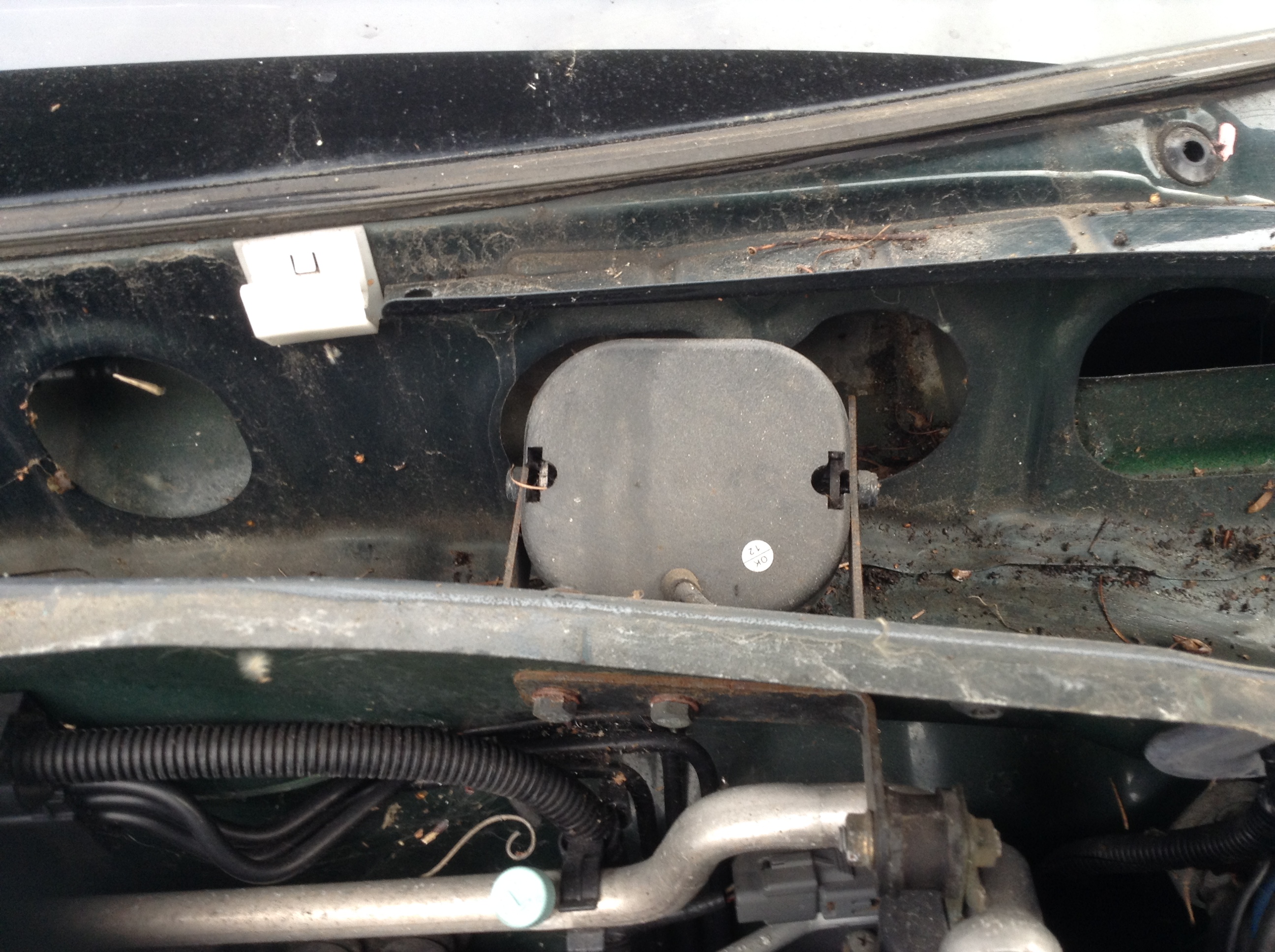

The alarm horn on my OB is under the wiper cowl which is the black plastic running across from side to side visible with the bonnet open. Take the wipers fittings off the splines, then find numerous clips holding the cowl in place. The horn should be visible underneath. Bit fiddly but not too hard. You Foz may/should be similar. When I did mine, the horn mounting bolts were rusted, as were the two bolts holding the horn together. I had to drill mine out. After that, open the case and you should see a rechargeable 9v Battery.

Thanks Greenmamba, I'll remove the siren when my fingers have thawed out!
Stants - you need to remove the Wiper Blades, remember to mark their position, then there are 4 push dowels (2 either side) which need to be levered out. Then you need to go to the engine side of the cowl and gently begin to lever it up as it snaps into position. It's in 3 parts - 2 end caps and the large centre piece.
