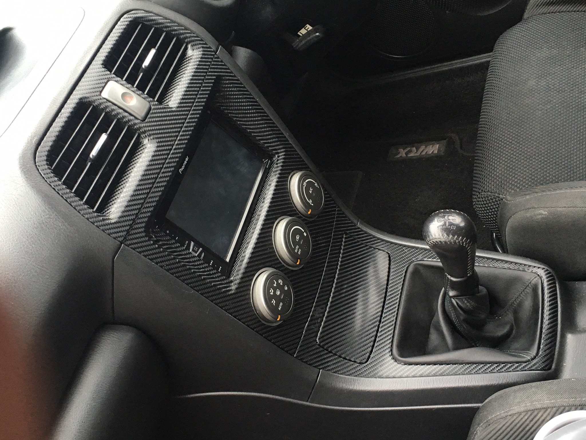

i bought myself a Blobeye last year that needed a little TLC.
Having sorted the essentials (decent maintenance and now rust free bodywork), I've started to add my finishing touches; like gold wheels etc.
Due to a scuff mark and small crack on the centre console, I was looking at replacements; but are fairly expensive (for what it is).
I've recently been looking in to carbon fibre wrapping and decided that I'd give it a go; if only to discount the option.
Anyway, the first time I had a go; the adhesive backing didn't appear to be strong enough - so a few bubbles appeared. I removed it all and had a second go, but this time I sprayed Evo-Stik glue on the back to strengthen the job; which appears to have worked. Note, I sprayed on the back only; so I could still remove if it goes pair shaped..!
Has anyone had a go at carbon fibre wrapping their console, be interested to know your success stories or otherwise ;)
